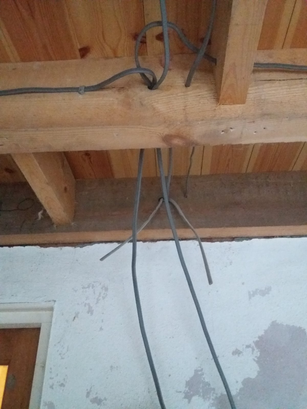

Gawd...anyway, sockets now wired in to back boxes, with back boxes earthed as standard but still a stand alone dead circuit.
Now, how to connect it in to mains supply?
The two short tails protruding thru the beam over the door (with longer tails from new circuit/sockets hanging down) are the same two with red tape on their ends under the floor amongst the rest of the services. They mean that I don't need to drill holes thru 2 joists and 2 skins of brickwork to connect the new to the existing.
