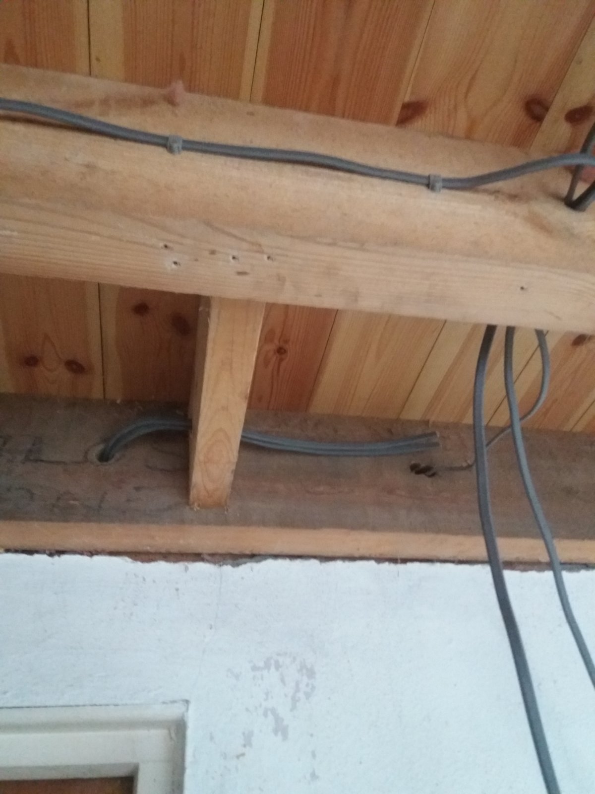

Sry to interrupt, but does this look ok? The top cable between the bricks is 75mm below top of floorboard.

Whats the separation between the cables and the heating pipes?
