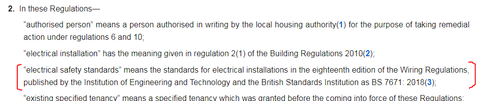

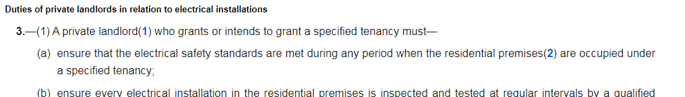

New consumer unit required to pass EICR? (due to changes since 2018)
The actual law:
So you haven’t read post #6 nor the linked document ?
Sorry, so many posts flying about but I have now seen post 6 and I had already read the PDF. It confirms what is widely explained on the internet that an EICR will not fail purely on a CCU not being metal. Thanks!
The actual law:
Doesn’t say the installation has to comply though

If, and I say IF rentals had to comply with the 18th edition the number of rewires would be far higher. As for plastic / metal CUs - a plastic CU would only be given a C2 in the event of failing the IP tests or had thermal damage

This has been debated many times, each edition of BS 7671 gives the date at which a design must comply, so if designed before that date then that edition does not apply, that is if you follow what is says in BS 7671.
However in real terms, no one is going to have every edition of BS 7671 so the EICR is not directly linked to BS 7671 although one can reference the book to show what section needs to be complied with when the design is altered.
However it is near impossible not to alter the design, if designed to use filament lamps and now fitted with LED then clearly a design change. And so many appliances stipulate not only the use of a RCD but actually state type A.
It is near impossible for anyone doing an EICR looking up every manufactures recommendations to see if a RCD is required. And when one does some times one is supprised, my solar panel inverter says use a type AC or better RCD, I did not expect it to say type AC.
So the inspector has to use his skill to decide if protentially dangerous or not, not if complies with BS 7671 or not. So the same thing coded C3 by one inspector can be coded C2 by another, and neither is wrong.
More than if it will pass or not, is the morrow question, your tenants can't fit RCD's them selves, only you can do that, and you have no idea what equipment they may be using, so in real terms it needs RCD protection.
As to SPD, that's not so cut and dried, if the equipment which could be damaged by a surge is yours, i.e. integral lights, then you can deside to take the risk, but if tenant provides bulbs, then really you must protect them, but no fixed requirement.
