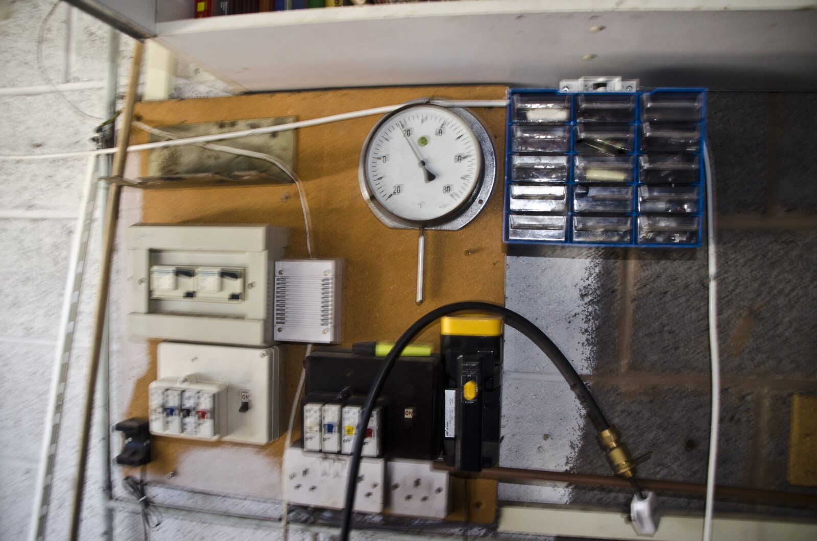

And my old house still has two of these fuse boxes, DSC_3921.jpg but if you look above them is another box with two RCD's one for each fuse box, and the fuses have been replaced for MCB's, so the only thing is the fire resistance properties of the boxes, and to be frank in a garage with fire resistance ceiling there is not really a problem anyway.
