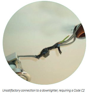

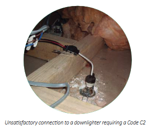

As said having a non safeguard BA22d bulb holder where children can assess is potential dangerous, specially if the bulb has been removed, and this Unsatifactory downlight.jpg is less dangerous to non safeguard BA22d bulb holder with no bulb in it. To assess the bare wires you need to remove the lamp or lift floor boards, yes it is wrong, it clearly states you need a tool to access wiring and you don't need a tool to remove insulation tape, but what danger does it really present? This Unsatifactory downlight2.jpg is different, too close to beams, inner insulation showing, and clearly in a loft where you could assess, so yes code 2, but I do question even the best practice guide.
