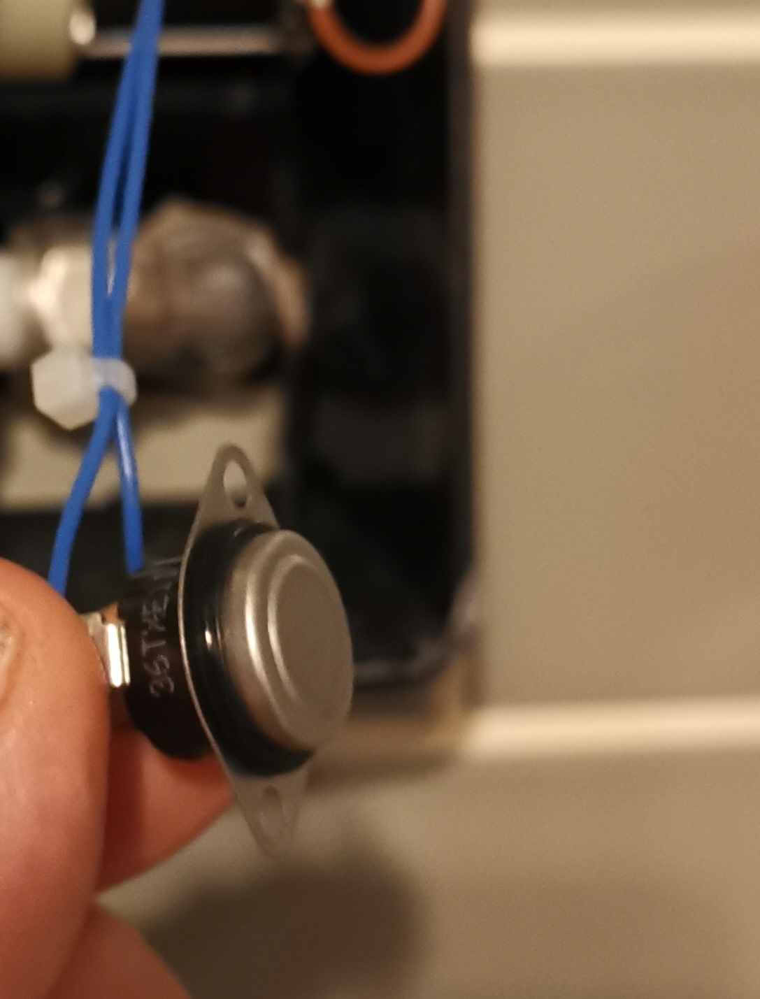

I have got as far as taking off the cover and I'm stumped as I can't see where I put the diaphragm as the one I have looks different than the one online. Mine has electrical wires coming off it. Just want to confirm how to proceed. And getting the 3 screws back in was a pig as the top right one would not go back in. Thanks.

Will have a look at the MIs later but that seems to be a TCO (thermal cut out) that shuts off the power to one heating element and is not the PRD.
That is a TCO, item7, havn't located the PRD yet.
Another shot of that TCO.

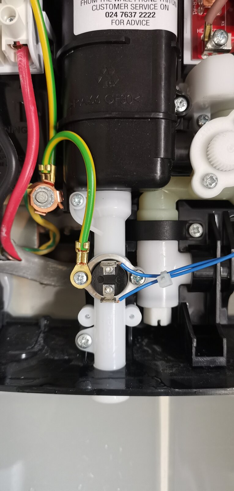

Nothing doing I'm afraid after removing screws it doesn't rotate. I try to pull it downwards but it is held by wires.

Which wires? the earth wire and the two blue TCO wires?
Is the PRD just underneath the TCO but at the back of the outlet pipe?, you should be able to feel the spout with your finger.

Yes, the earth and two blue. I could unscrew those ?
I can't get my finger round to feel anything as there is black plastic from the shower housing in the way. It looks impossible to find.

Yes, unscrew those, there seems to be two screws coming from the rear just below the TCO? which are probably securing the PRD to the outlet pipe, (First) if you restore power and water to the shower, press the start button (take care) for a few seconds, you should then see where the PRB is located, re isolate power and water.

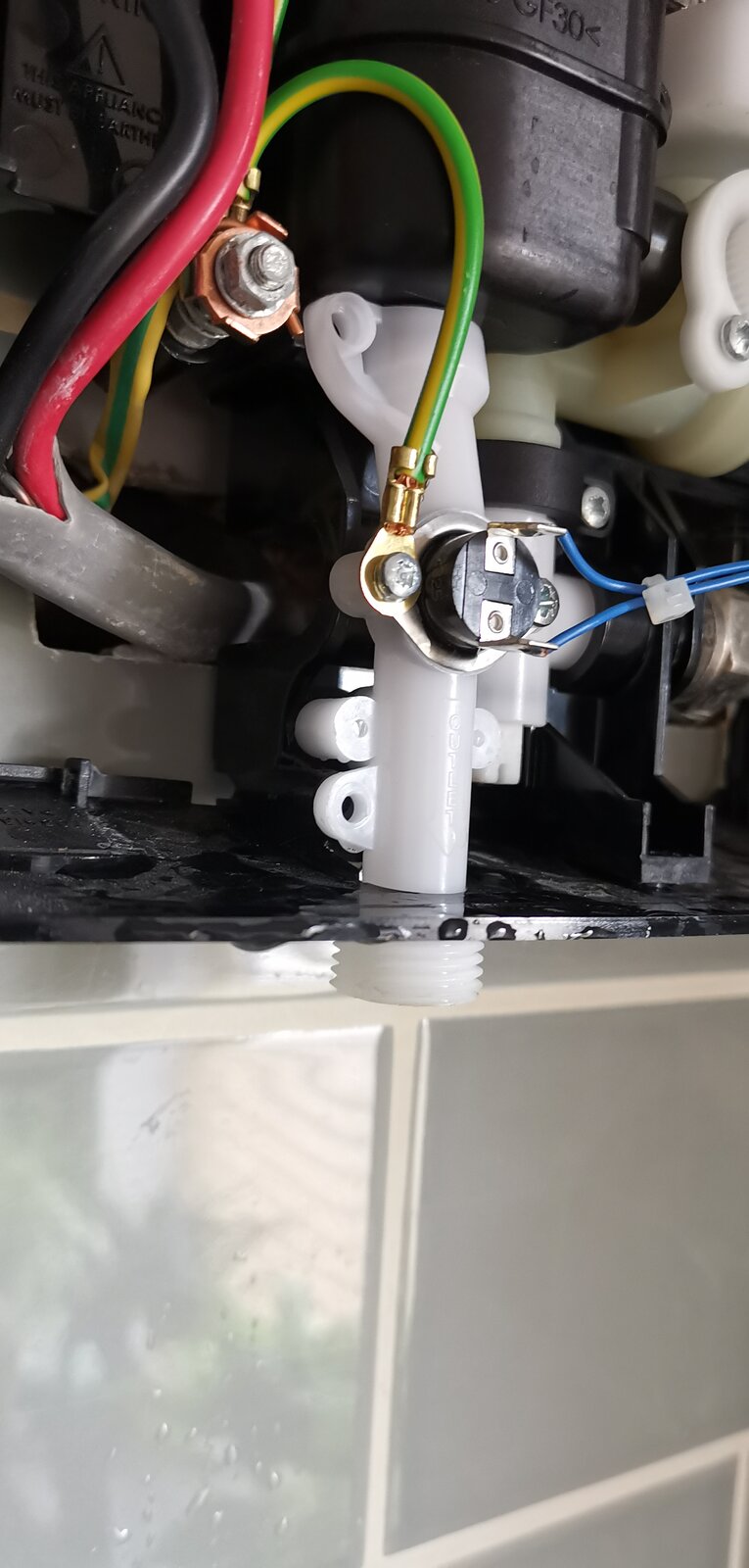

Sorry but again I'm stumped. Still can't shift the white plastic pipe and nothing under the electric sensor except a rubber ring around it.

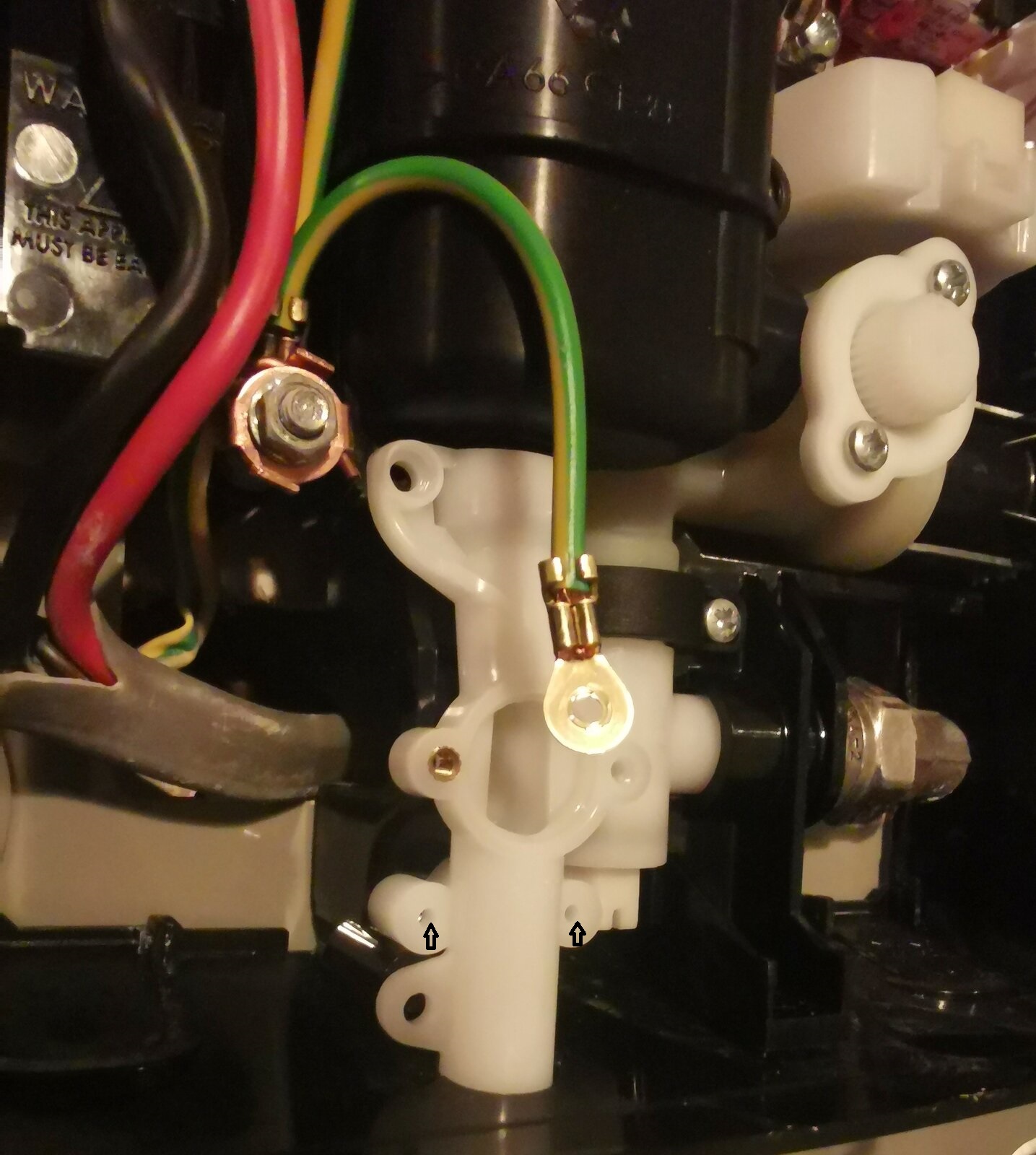

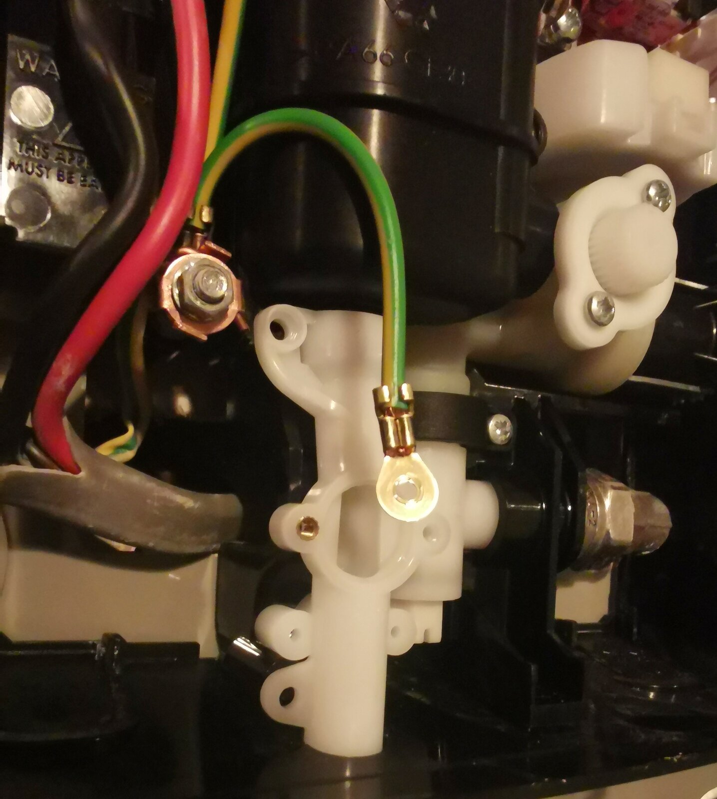

Afraid I can't be of much more assistance, see attached, two black arrows, where I think the PRD might be attached (screws from the back), otherwise put it back together and switch on the shower as I suggested above, that will certainly identify the PRD location.

That's the thing, I can't get to the screw heads you have circled. Why would they not have them facing the front so you can unscrew ? This seems very odd as most other showers are easy to get to it. How would turning on the shower help identify it's location ?
