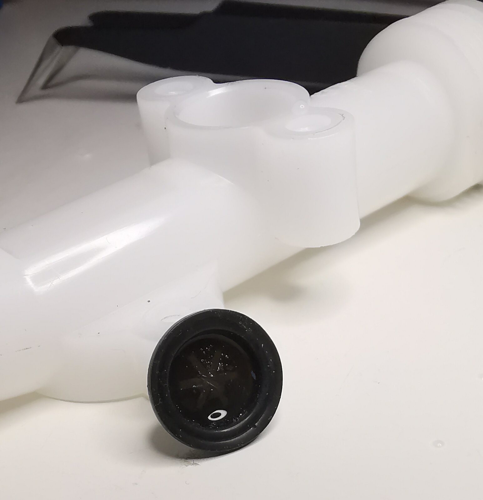

Managed to take out the pipe to fit a new seal. I must say the old one doesn't look to have been breached.
Update - Disaster - After fitting it all back together exactly as before, water cascades from the whole of bottom of the shower like a waterfall. I the refitted making sure everything was extra tight and it works. No idea why it leaked so badly after the first attempt
Were all the (any) O rings in place and hadn't fallen out before replacing?.
Where exactly is the water coming from?, are you sure that a new diaphragm has fixed the leaking PRD?, maybe a cracked pipe and you should renew the whole part, like shown in post #52.
