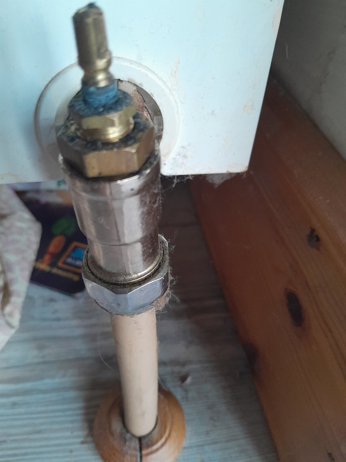

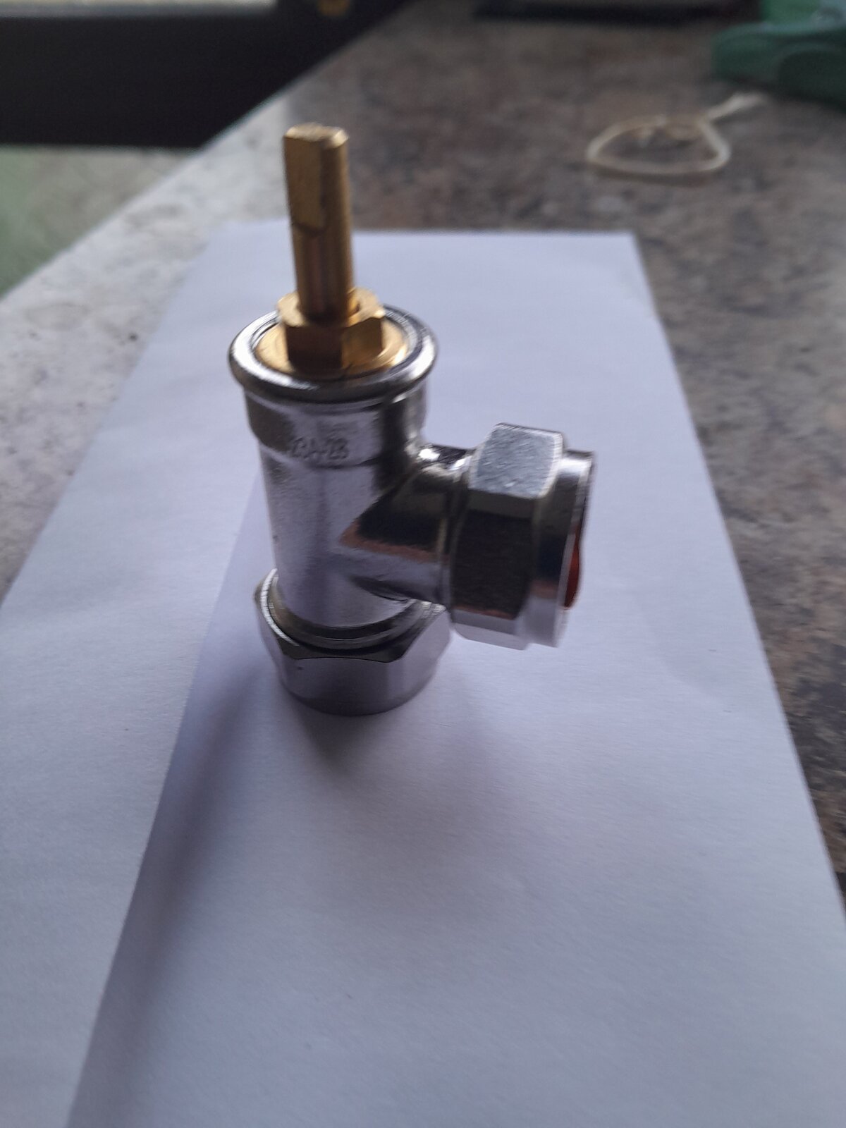

Came across this a few years ago and while the barrier/non barrier piping doesn't apply here, the rad valves might, I use EPH TRVs that come with a lockshield valve and these don't have a gland, just a O ring I presume, even though I've never had a problem with air ingress.
"had a long chat with Hepworth technical (Hep2O) years ago about the virtues of barrier vs non barrier pipe (in relation to oxygen crossing it). And yes non barrier pipe does let a lot more oxygen across compared with barrier but its still nominal compared with the oxygen that gets into a system via radiator valve glands- apparently its the top crossing point by a country mile for oxygen ingress. Those cheap unglanded lockshields are a death sentence for your system. Volume house contractors often use cheapo valves . Id also be looking at that."
I just nipped up that glanded valve now, you can see that there was a very slight leakage, (0.5bar head from the F&E cistern) not surprising I suppose since its there for ~ 15 years or so, and its my first time nipping it up, I have vented a tiny amount of air from it say once/year, there are probably a few like that but as I never have/had the slightest problem I've never bothered checking. I suppose it would be interesting if my system was sealed to see if air would build up as it would have no open vent to escape up. I'd still be a bit surprised if thats your problem though.

Thanks, I guess it’s difficult to know if they are glanded before buying…
