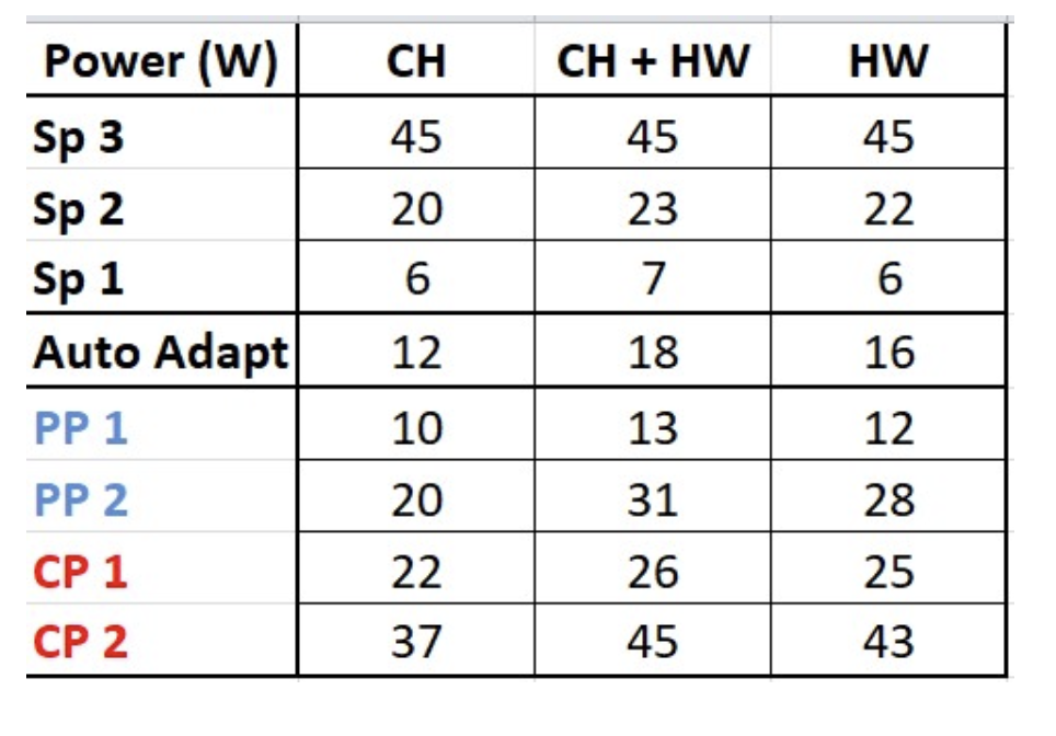

I changed today to CP2 and for CH & HW the pump is showing 35W. The coil dT was about 10C - similar to how it was before. I did not do the HW only test yet. Will do tomorrow.

So looking at your table this 35 W for CH+HW in CP2 is way too low I suppose? Should be 45W so significant drop.
That was specific to one installation, your 35W on CP2 gives a flowrate of 0.8m3/hr,13.3LPM, I get that (with a spotlessely clean system) at a 3.6M head so would expect 14.9LPM at 4.5M (CP2) so not hugely different. I also notice on mine that there is very little difference in flowrates between CH&HW & HW only.
