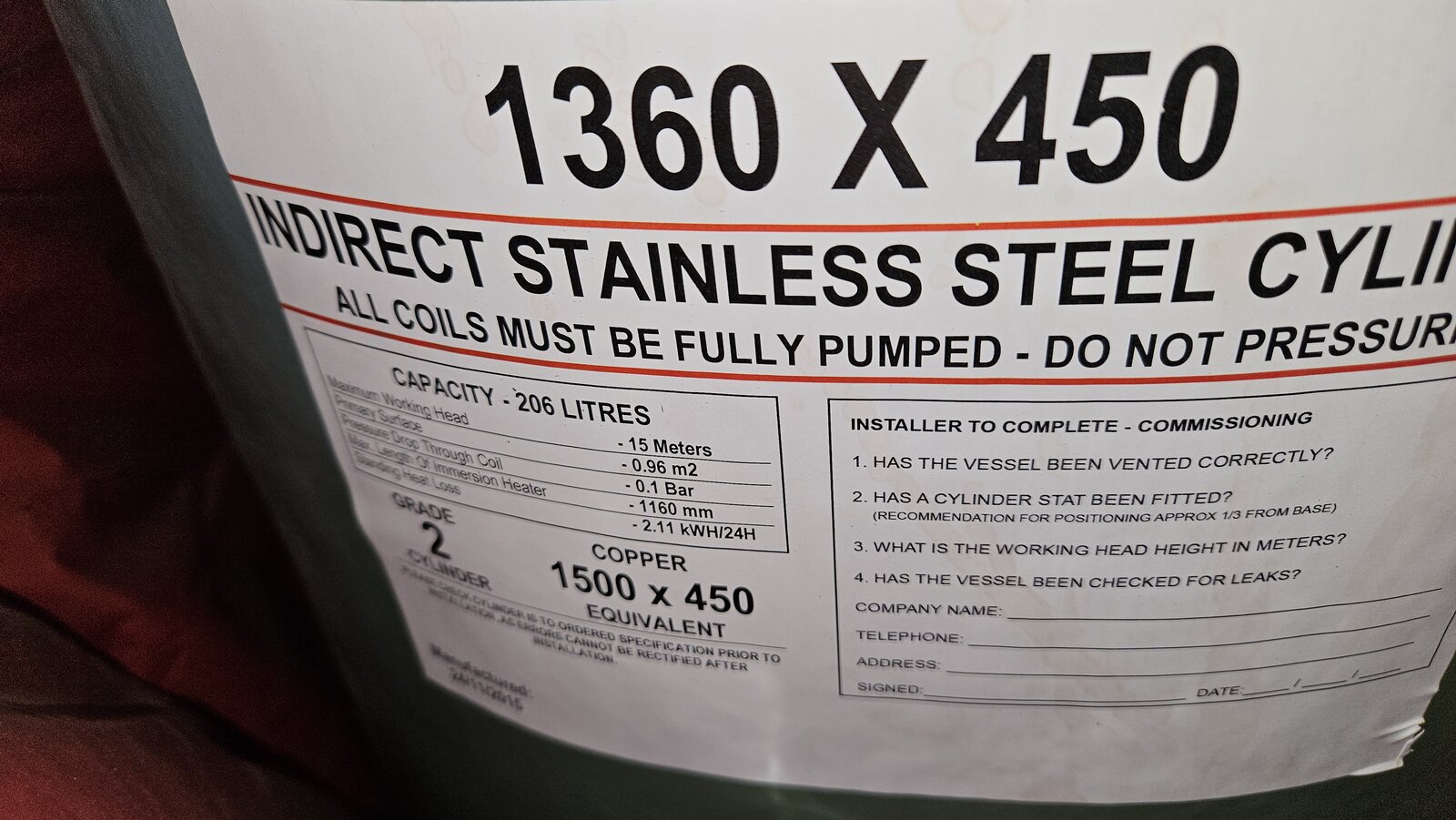

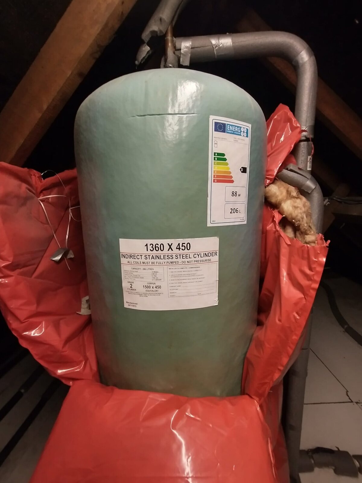

What is your HW cylinder capacity & make/model?.
Thats good, combined seems to be working OK, vent is above the cistern water level?, maybe install that AAV next?, you could change the pump mode to cp2, that will increase the pump head from 3.0M to 4.5M which should give ~ 23% more flow so HW flow from 10.0LPM to maybe 12.2LPM, might help?.
See a photo of the HW cylinder.

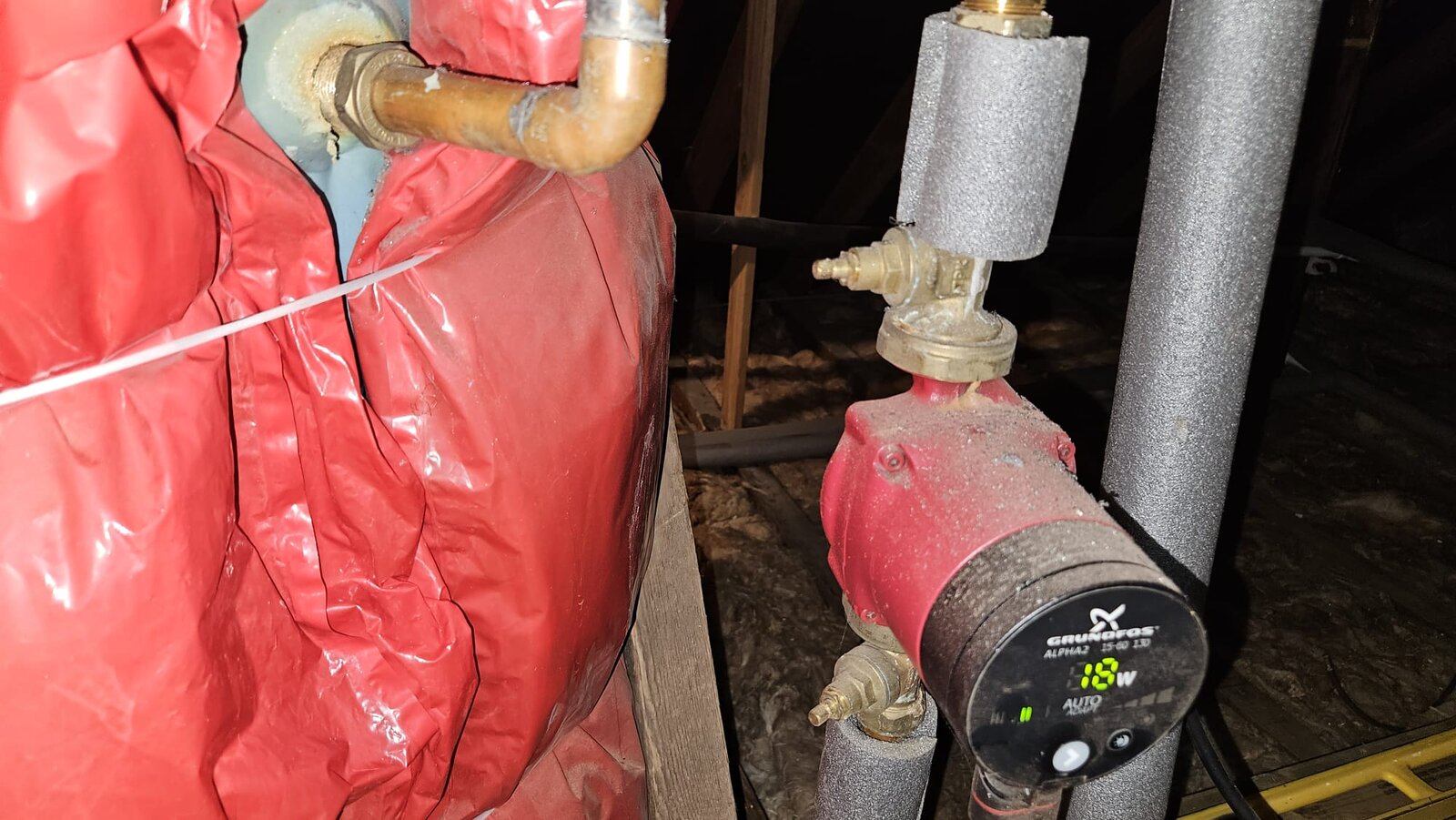

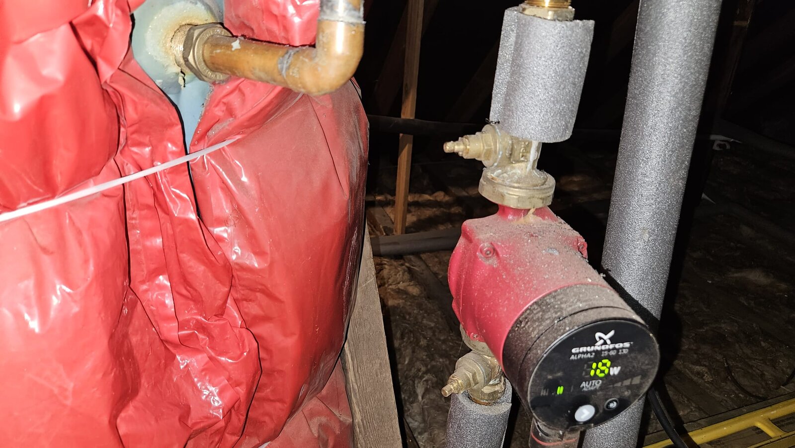

Re the slackening the compression nut that attaches the cylinder coil top pipe to the coil inlet see the photo attached.
Is this the right one?

Other than that I did buy a infrared thermometer to test the reading of the A & B (I could not verify them by hand as they were too hot) and I did notice that if I put HW only the B was about 45C while the A was about 20C. Would that make sense?
What I mean here is the A does not go complete cold but a fair bit colder (which is hard to register by hand) and whether this is expected or indeed a problem.
I think the only thing that remains to be checked is the slackening of the compression nut right? Not sure I can diagnose more unless I missed sth from previous posts. What I mean is I cannot make the system work any better without my physical interference.

Yes, thats the one to slacken, say 3/4 to 1 turn, use a pair of gloves and then give the pipe a good shake and you should break the seal easily enough.
20C reading at port A would be correct but 45C on port B seems very low if the boiler was firing with a flow temperature of say 65/70C?.
Can you get the boiler firing continuously even if you have to run both HW&CH and take a reading on that top pipe (that you are going to break the seal on) and take another reading on the coil outlet where it exits near the bottom of the cylinder, that will give some idea of the coil dT.
I would have expected a greater flow through that coil even on CC2 at 3M but you could have fouling of the boiler HEX (heat exchanger) etc or the pump impeller vanes might be partially blocked and still give seemingly correct power readings, you could isolate the pump by shutting the isolating valves on either side, removing the 4 stud bolts holding the pump head to the body and remove it to inspect the impeller and pump ports for obstruction.
That's a fairly substantial coil area at 0.96m2 (mine is only 0.62m2), it gives a pressure loss of 0.1bar or 1.0M, not of much use though since they don't specify the coil flowrate.
Anyhow take those coil flow/return readings, and try and vent any air from it.
How long does it take to reheat the cylinder, even roughly??.
