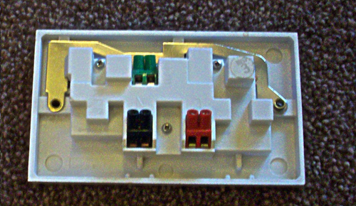

Do any still exist? There used to be things like this (which I rather liked), but I haven't seen any on offer for decades ..

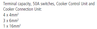

There are a good few examples in the MK catalogue, albeit commonly for 1mm² or 1.5mm² conductor (with the 2A sockets said to accomodate up to 7 x 1mm² !), for example:
... but there are at least some terminals said to accommodate 4 x 4mm² :
Kind Regards, John

The only current one i'm aware of is the MK rapid fix with three level style terminals per pole.
Yes, that's a pretty recent innovation which I hadn't thought about. However, I think it remains true that I haven't seen any with more than one set of screw terminals (which is what we've been discussing) for decades.
