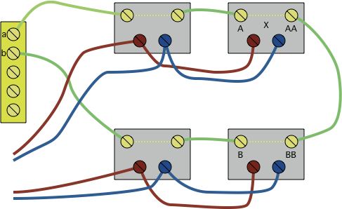

So we have two radials, lets assume wired in T&E, and by choice or design we arrange for the last devices to be in close proximity so we can easily just drop a bit of earth wire between them.
Do we now agree that both radials (subject to separate terminations etc) now meet the requirements for HI earthing ? And that this has a single ring of protective conductors from the MET, via all the accessories, and back to the MET ?
I agree that it meets the requirements for HI earthing for radials, not rings.

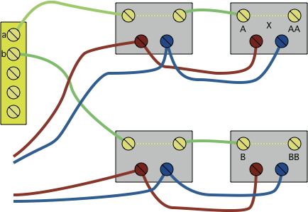

OK, so lets take a look at that. To start with, we have two radial circuits, something like this ;
Following 543.7.2.201(ii)(c) we link terminal AA to terminal BB and get this :
Now you've agreed that this meets all the requirements of the regulations, so therefore it must meet 543.7.1.203 and presumably (given the context) specifically 543.7.1.203(iii). So I therefore assume you are counting path a-A as one PE (as well as the cpc for that radial), and path AA-BB-B-b as the second PE ?
Is that correct, or did you have something else in mind ?
Just to add a bit, considering the other radial, b-B is one PE (while also being the cpc for the radial), a-A-AA-BB is the other PE.
So again meeting the requirements of 543.7.1.203(iii) ?
So, does anyone have any objection to that interpretation ? I assume not since no-one has objected yet.
OK, so you are saying that path a-A and path b-B-BB-AA do not constitute separate PEs ?
In that case, assuming the radials don't comply with 543.7.1.203 (i), (ii), (iv), (v) - how does the arrangement meet 543.7.1.203 as BAS has said he believes it does ?
