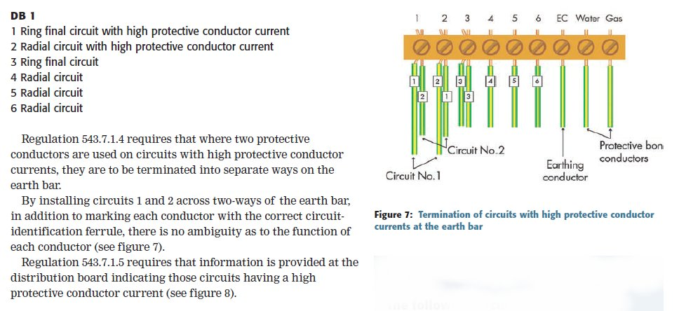

Maybe I don't have to wait to hear from the IET. I've just remembered that the article in the IET's "Wiring Matters" about high integrity earthing (click here) gives a very clear opinion/view on the matter under discussion. It includes this ...
The actual point of this is to illustrate how one can achieve the 'separate terminals' requirement when there are not enough ways in the CU's earth bar. However, it is clear that there are two, not four, protective conductors for the HIE ring final circuit - so definitely only one ring, not two. So, if one assumes that the IET would not publish an article which was incorrect in terms of BS7671, it sounds a bit like "John 1, BAS 0" :) However, I'll still wait for a reply from IET before getting too carried away with myself.
Kind Regards, John

That was the article and diagram that origanally convinced me john.
