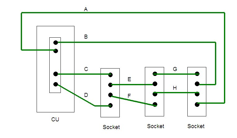

Do you agree, or not, that the below would be compliant as a high integrity earthing system?

If one removes any possible quibbles by postulating a hypothetical socket with four earth terminals, then, if one had 'two rings', it would actually be impossible to say which 'wire' belonged to which ring - so it would really be a question of 'doubling up' conductors in parallel, rather than having two physically distinguishable discrete rings.
Except there are two distinguishable rings.
As I said, they wouldn't be distinguishable. In the following, which four lettered wires do you think constitute 'distinguishable ring No. 1' and which constitute 'distinguishable ring No. 2'??

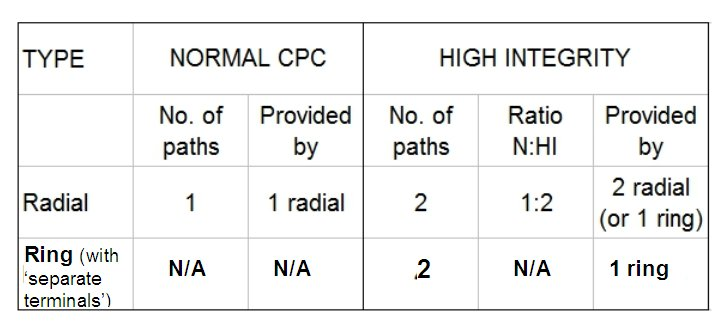

I believe that (in the context we are discussing) 'high integrity' relates to redundancy of 'paths to earth' - i.e. that two or more 'paths to earth' constitutes 'high integrity earthing'. I therefore believe that a standard ring final (if it has 'separate terminals') is already 'high integrity', and therefore does not require anything to be "doubled" to create 'high intensity earthing' - and I believe (subject to confirmation from IET) is that is what 543.7.2.201(i) is trying to say. In other words, I would present your table as:

One thing I'm not clear about is what you feel about a radial converted to HIE by turning its CPC into a ring (which I think you agree is acceptable as HIE). Since you would presumably regard that ring as being "one CPC" do I take it that you would therefore believe that 543.7.1.204 doesn't apply - i.e. that there is no 'separate terminals' requirement?
