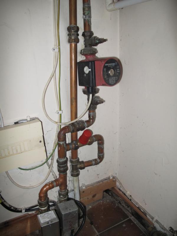

Hi Tony, sorry for the delay in getting back on this, got a bit sidetracked this week at work.
Anyway, here is a photo of the system. The photos does not show the boiler itself but the two pipes that head up out of the photo are the send and return to the boiler. The return is plumbed to the outlet of the pump.
Stuff I have tested today. Adjusting the bypass valve does not seem to fix the problem but does perhaps reduce the frequency and volume of the 'pops'.
Setting the pump to its lowest setting immediately stops the noise and setting it to its highest (3) makes it much worse.
I've tried working out exactly where the noise comes from but it is very hard to pinpoint (as it resonates through the pipes). However, it's definitely not the boiler and does come from the area of pipes near the bypass valve (though doesn't seem to sound like it's from the valve itself).
Does that give you any ideas?
Thanks,
iep

iep. is it possible the bypass is reversed?
Useing a long screwdriver, with one end to your ear and other to areas around the pump, listen to noise. Where is it loudest?
PVM- no body can be suttle as your good self. Welcome back after a long absence.
I have checked several times whether the valve is reversed (as it is exactly the type of mistake I am prone to making. But, on this occasion, I am pretty confident that I have installed it correctly.
Good thinking on the screwdriver stethoscope, I use that on my car. Don't know why it did not occur to me to use it on plumbing. Even just listening to it with the naked ear though I can hear that water is definitely passing throug the bypass valve when the pump is in overrun mode. So, I'm confident that the valve is at least partially functional.
The arrow on the pump should be point upwards and the arrow on the bypass should be pointing to the left.
Are the motorized valves the correct way round? It should be IN at port A and OUT at port B (There may be an arrow, which should point upwards)
Have you balanced the system? How to balance a CH system.
The arrow on the valve points left and the one on the pump upward just as you describe. There is also another 3m of pipework above the pump which gives the correct minimum length for the bypass loop.
The zone valves are definitely correctly fitted too with their arrows pointing upwards.
Not sure if your 'Have you balanced the system?' question is actually part of your signature but, for the record, yes.
I'd really like to get to the bottom of this issue as the noise is genuinley loud as is frankly a bit scary.
