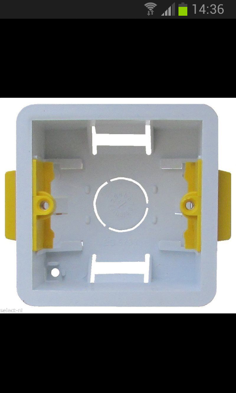

How do I terminate the SWA, which comes through the outside wall into the living room, into a 47mm dry wall box (see image). I can't really see a way and this might change my plan again!!
The wall is: single plasterboard, insulation, brickwork.
I was planning to cut plasterboard, insert the 2 single 47mm back boxes to accommodate the unswitched 13Amp FCU and the 45A FCU and wire the SWA onto it !
I hope my question makes some sense and is easy to understand!

Use a metal dual box rather than 2 single boxes and fit 2 plasterboard lugs. Fitting an armoured cable will still be fiddly if you aren't used to it.
I never liked those drywall/plasterboard boxes for anything, but there's just no way to terminate an SWA cable to one satisfactorily. The dual metal box that Freddo suggested would give you a proper way to terminate; note that we're not talking about a regular 2-gang box but a box which is effectively two single-gan in one, like this:
If that might involve too much cutting and patching of the wall, another option would be to mount a weatherproof junction box on the outside wall and run the SWA from that.
Terminate the SWA on the outside surface of the wall using a waterproof box
These are made for the purpose
Do not forget to order the earth clamping bar to make earthing the armour an easier job
You then wire from the external box through the wall using regular 2.5mm² T&E cable (I'm assuming you are using 2.5mm² SWA?)
PBC, you've made it again:)(y), excellent, that's why I suppose you are an electrician(?); my only "objection" would be: the little piece of T&E coming out of the wall and into the weatherproof junction box....., is it not a regulatory(?), but most importantly, a safety issue???

If the T&E comes out of the back of the box and goes straight through the wall, none of it will be 'exposed' - either to 'the elements' or to potential trauma.

The external ones are longer because they have an additional 'stage' to them. Internal ones have just one nut which grips onto the armour. External ones have an extra ('outer') 'stage' which seals around the outer covering of the cable, to 'prevent' water ingress.

The earthing "banjo" washers supplied are general purpose items for earrhing the armour (using an SWA gland). These are fine for use in general boxes.
The WISKA boxes are a particular design and are not suited for use of the banjo washers.
The WISKA boxes, that I linked to, come all ready with threaded holes for you to screw the SWA gland into so saves you having to find a 20mm hole saw, extra nuts and bolts, it comes with a terminal block and is much easier for the DIYer (and many electricians) to use. In my opinion.
Thus video will show you how it all goes together, including use of the special earthing bar.. Also, note the external SWA glands, look out for the water-resistant seal nut that clamps round the cable and the longer rubber boot.
