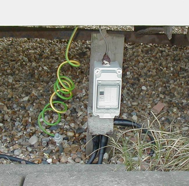

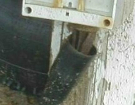

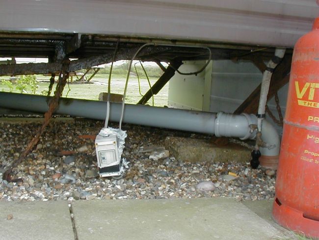

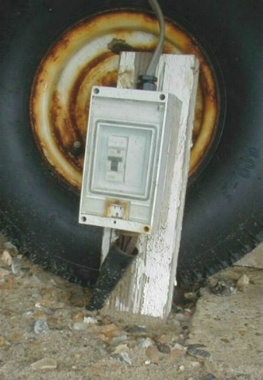

The external ones are longer because they have an additional 'stage' to them. Internal ones have just one nut which grips onto the armour. External ones have an extra ('outer') 'stage' which seals around the outer covering of the cable, to 'prevent' water ingress.
Not a very good picture from my archive, but here's what can happen when an internal gland is used externally:

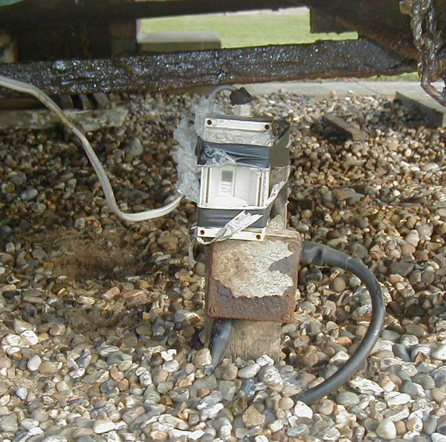

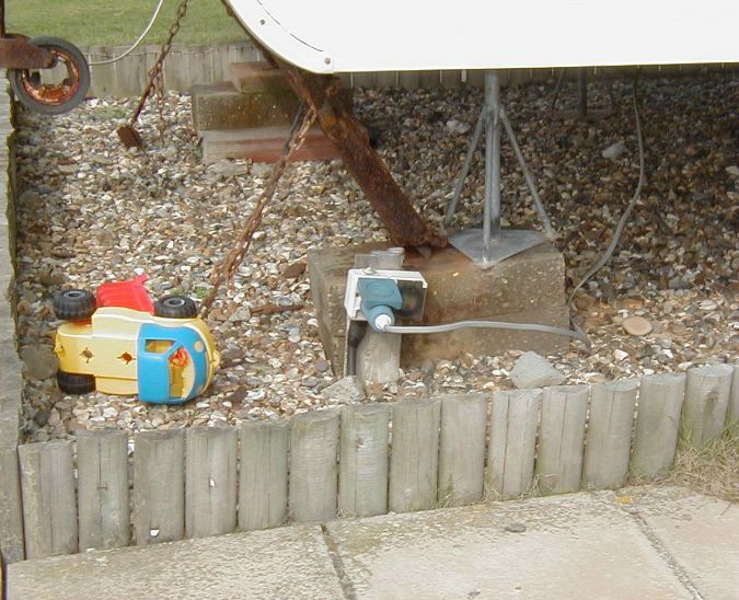

That was at a holiday caravan site right next to where I used to live. The whole place was full of deteriorating and badly installed hook-ups. Here are the other pictures from the same batch I took walking through there one day (no original dates on the images, but a rough guess I would say about 9 - 10 years ago):
MH_Hookup1.JPG MH_Hookup2.JPG MH_Hookup3.JPG MH_Hookup4.JPG MH_Hookup5a.JPG MH_Hookup5b.JPG
They finally had the whole mess replaced about a year before I left.

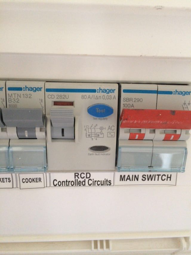

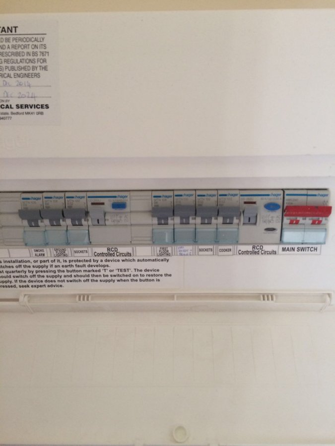

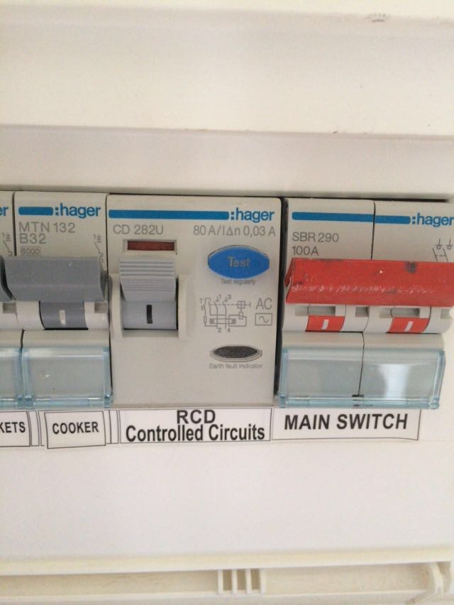

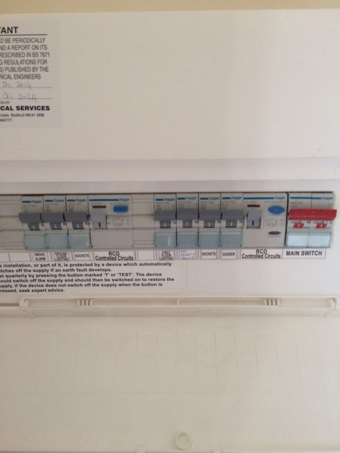

See below the pictures of my CU
When you say the shed will need its own RCD, do you mean feeding from the living room socket to the shed, without RCD, and before the shed "split" as i mentioned above , i install an RCD spur???
Thank you again
Does that board have a High Integrity facility, i.e. three neutral bars? Is there a short spare length of busbar tucked away inside the unit?.
If it does, you should be able to slide the existing breakers and RCD's along to the left, in order to make way for a single MCB directly off the main switch, which can feed the separate RCD controlled board in the Garage/Shed etc.

A long time ago, far back in time, at the beginning of this topic I did make reference to a solution like that. HAving read the nature of his OP, and his declaration that he was not an electrician, I advised him that
To run the circuit directly from the consumer unit would mean serious reconfiguration of the consumer unit.
Not a job for you.
And that remains my advice for this OP. Don't mess around with major configuartions of the consumer unit, unless you know what you are doing. In any case, that course would mandate a new circuit - together with notification requirements - so he would need a registered electrician to do this. In my opinion.
