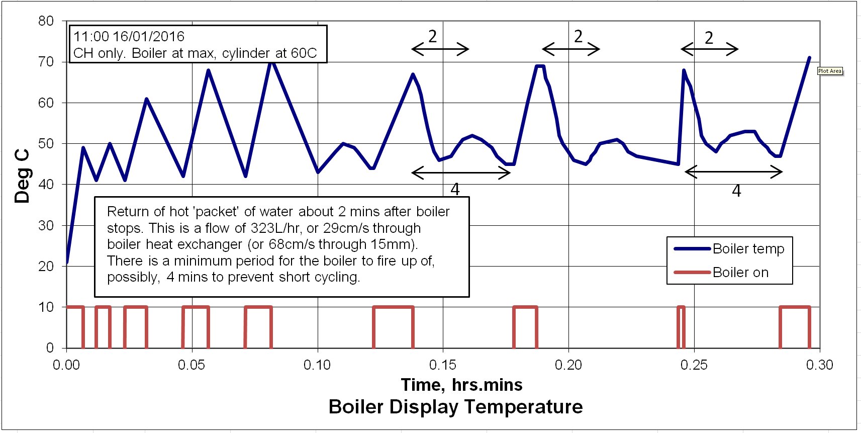

Thanks for asking, Tony. The system is limping along, taking a long time to get to a working temperature below the boiler's maximum. It is 'livable' until I get the professionals in, starting with a service and survey next Tuesday.
My main interest now is the length of pipework I have. This reduces the return temperature. At the start, a low return temperature makes the boiler think the flow is not good enough, so it stops burning. That is why I was trying everything to keep the return warm.
What I have done today - and I find it quite interesting - is to measure the temperatures for HW only. After about 10 minutes, I notice an increase in temperature about 2 minutes after the boiler stops burning - see below. This is a repeating pattern. I take it to indicate a warm 'packet' of water has returned to the boiler. Using this time period, calculating the length and volume of the piping (including boiler HE and cylinder coil), I get a flow rate of 323L/hr - equivalent to 29cm/s through the boiler HE. Of course, if the CH were switched in, this flow would increase.
So my question now is how does the boiler know if it is a blockage or simply long pipework? After all, it has no flow meter and only uses the return temperature to check this. Furthermore, I think the boiler has a minimum fire up period of 4 minutes (maybe less, I don't know) after the last burn to avoid short cycling. It seems to me that this behaviour severely limits its performance as it tends to get into a negative loop.

It improved it a bit - and I still have the 'lagging' there - but I also removed it and tried the system again. It had improved things a bit, but not as much as I originally thought. The idea was to get the return up to as high a temperature as I could so that the boiler fired. I was grasping at anything. I may even yet put a nightlight under the return temperature sensor!
I think there are some unpredictabilities in this system. For example, the figure that I just posted seems to indicate 'packets' of warmer water going round the circuit. This is probably not so noticeable on CH. Should these packets sync with the boiler, it could make a difference whether it fires continuously or not.
