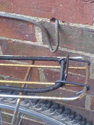

Trays, copex, slots in brickwork... keep the tips coming :) Have at last found a cable routing how-to:
http://www.dbsinstall.com/whatis/Whatisgood-4.asp
but they radius a cable (note the shadow) into a wall unprotected:
http://www.dbsinstall.com/N-images/Whatis/driploop-2.jpg
ready to collapse at the first touch, just like ours :( (NB not my handiwork)
What does the team recommend for external trunking that looks OK on residential brickwork? Have found Cableready but not found a retailer, and ideally need a flat profile. Any advance on white PVC channeling/capping?
