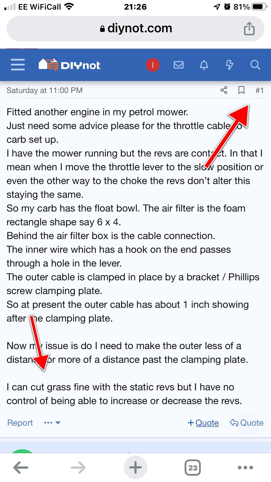

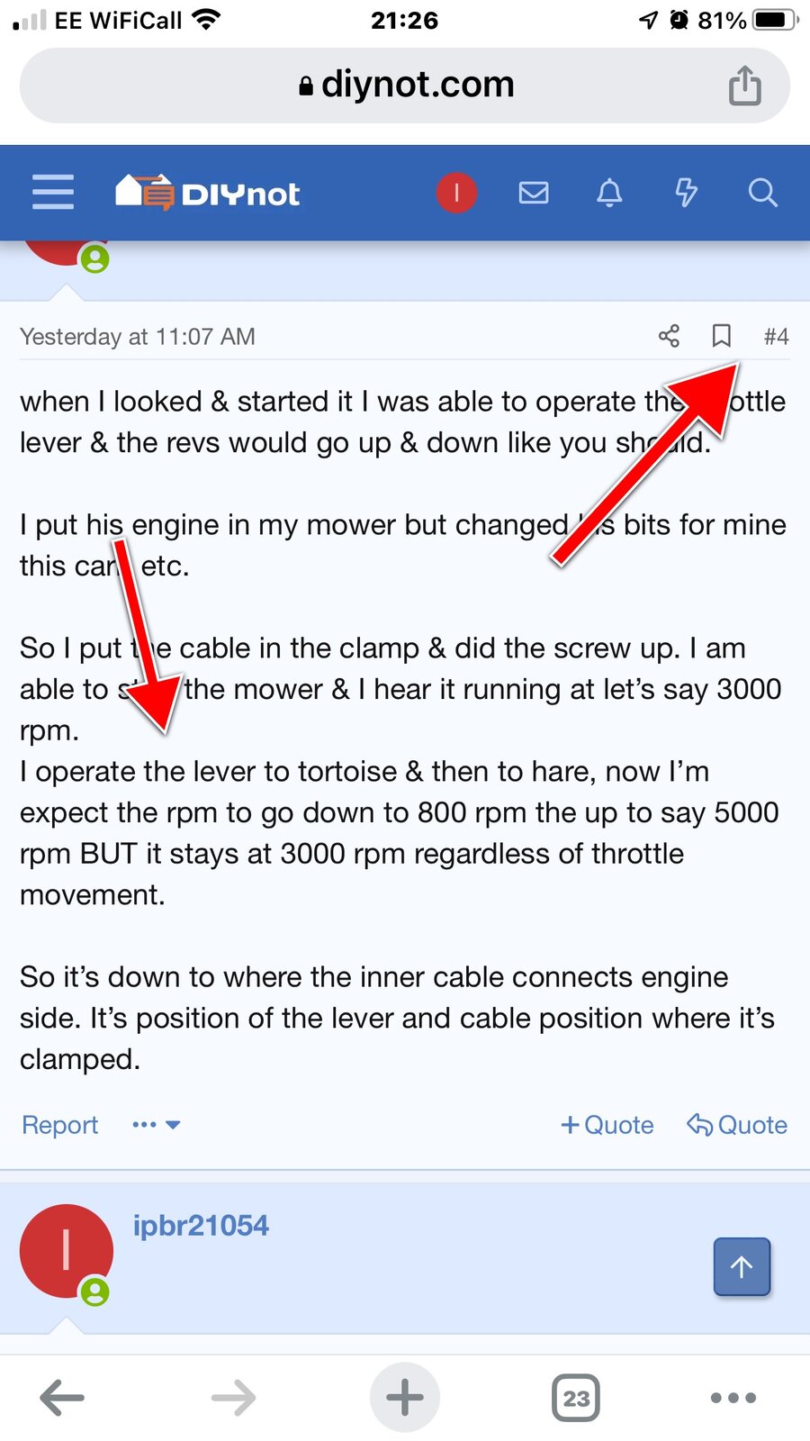

If you'd have conveyed that when it was asked it could have saved a lot of head scratching and typing as no amount of cable adjustment would make a jot of difference if the lever gives no control of revs.
I did in post 1 and 4 and others.

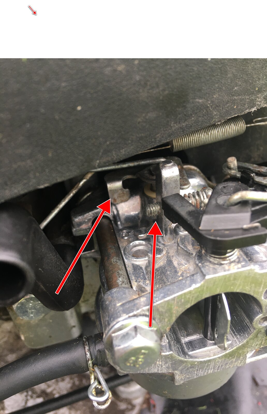

Please advise how i can bring the revs down by bending something.
I did 3 lawns today & with self propell im nearly running,so much so it shreaded the belt & ended up having to push it
Throttle arm being where the red arrow is pinting ?

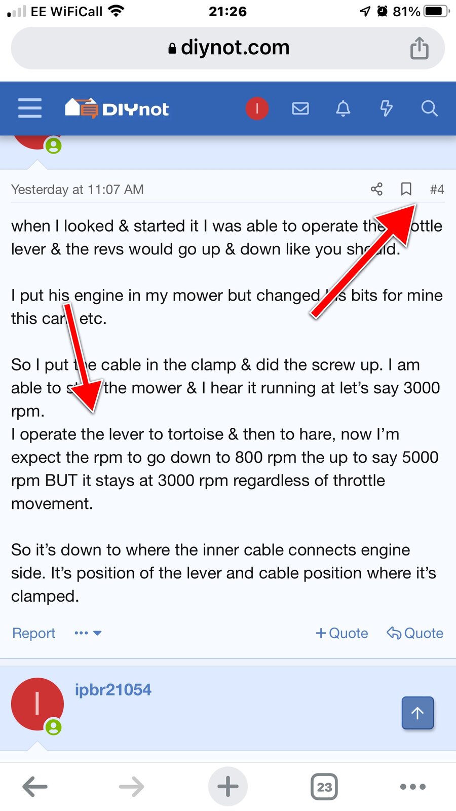

Ive removed the throttle cable.
I have started it up & revs are high.
I then move the lever either way & revs stay high / lever does nothing in respect of making revs change

Take a look at this photo.
The left arrow points to a lever which I assume should rotate and hit the screw where the right arrow is pointing. This then sets the tick over ??
When mower is running at high revs the lever is where it is shown in photo. Moving it towards the screw then brings down the revs.
Is something missing or not quite working right.

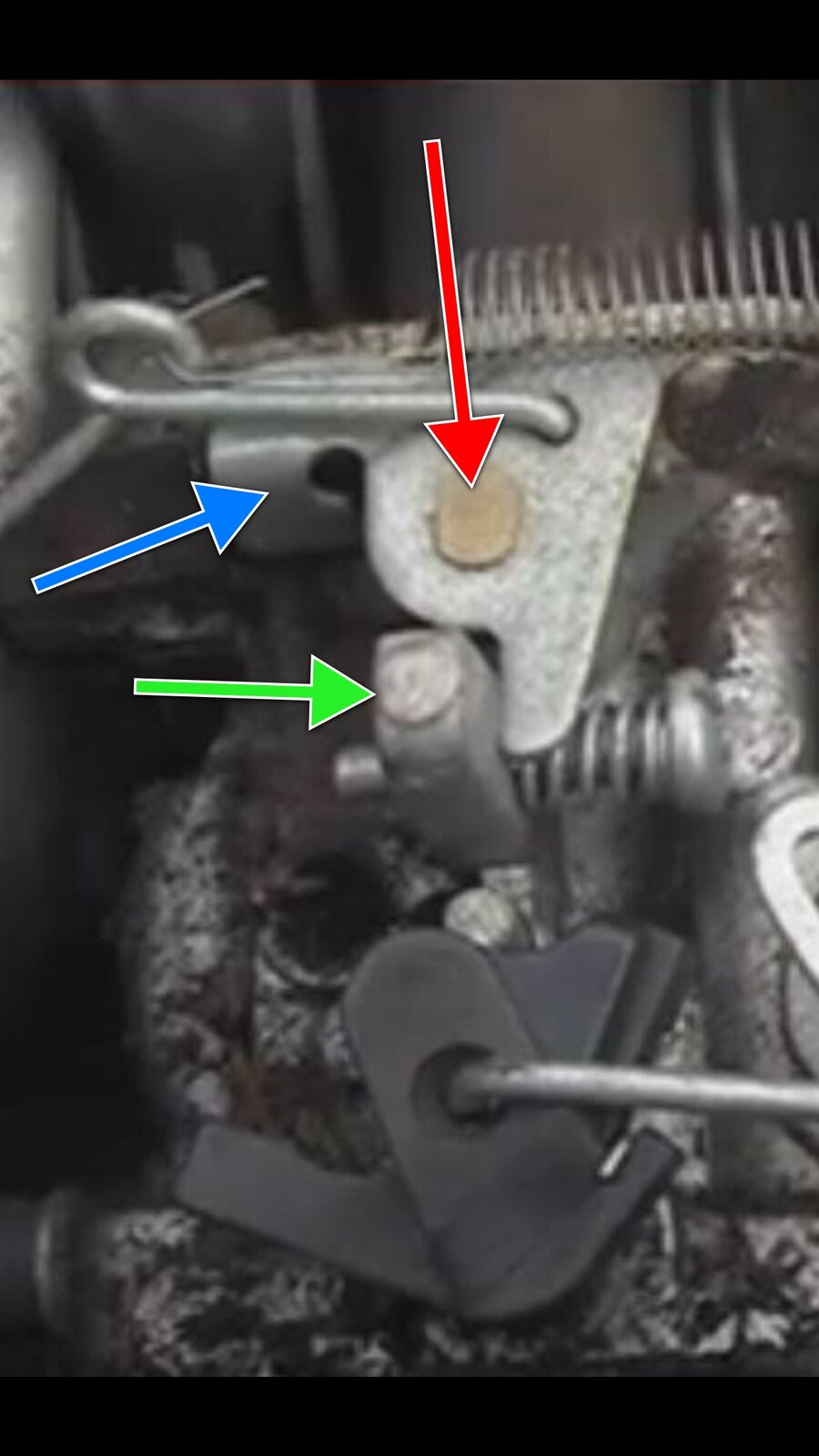

I think my last post with photo my help you
Ok so butterfly you mention is connected via gold pin shown by red arrow.
So when engine is running the piece shown by blue arrow should rotate around and hit / touch where the green arrow is pointing.
Then that screw can alter tickover etc.

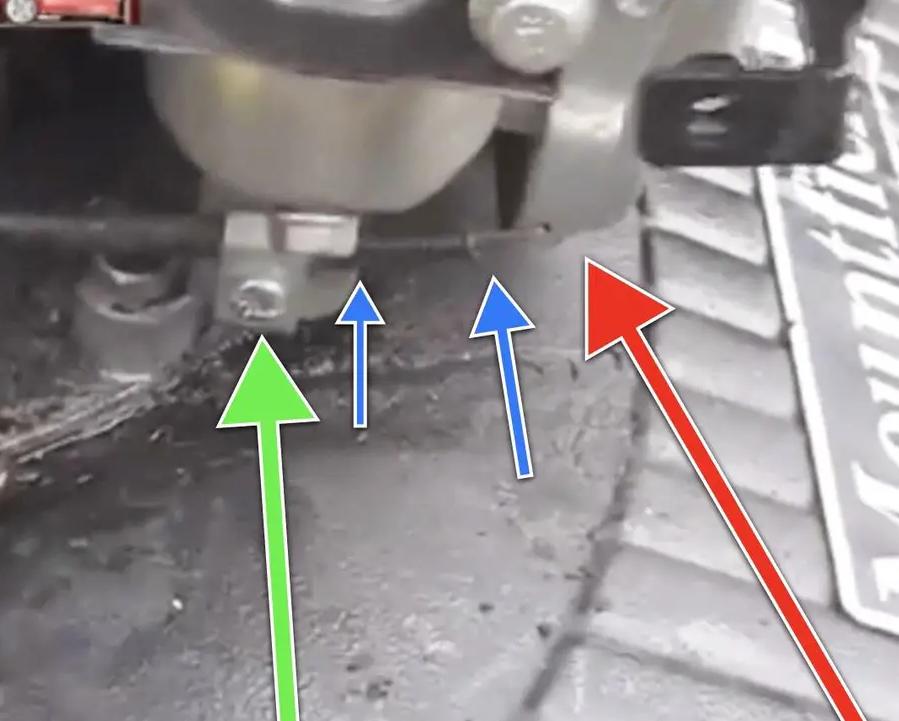

Well the blue arrow part stays where it is.
So I assume this is where the butterfly is wide open as you mention.
