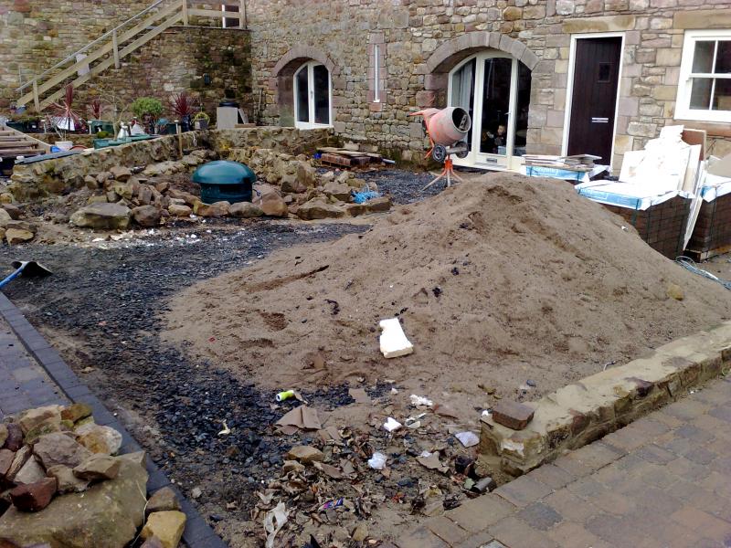

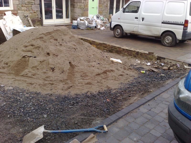

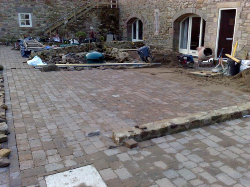

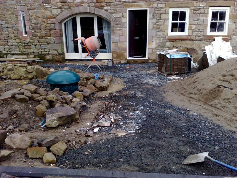

Apologies for the delay in updating my project but i've had 3 days off work and decided to help my brother out a bit. He's just completed a barn conversion and needed to make a start on his driveway. So this was my break from work:-
From this:-
this:-
and this:-
to this. Not quite finished but at least we made a dent:-
Unfortunately got to go back to work for 5 days now but will be back on the wetroom project tomorrow afternoon.

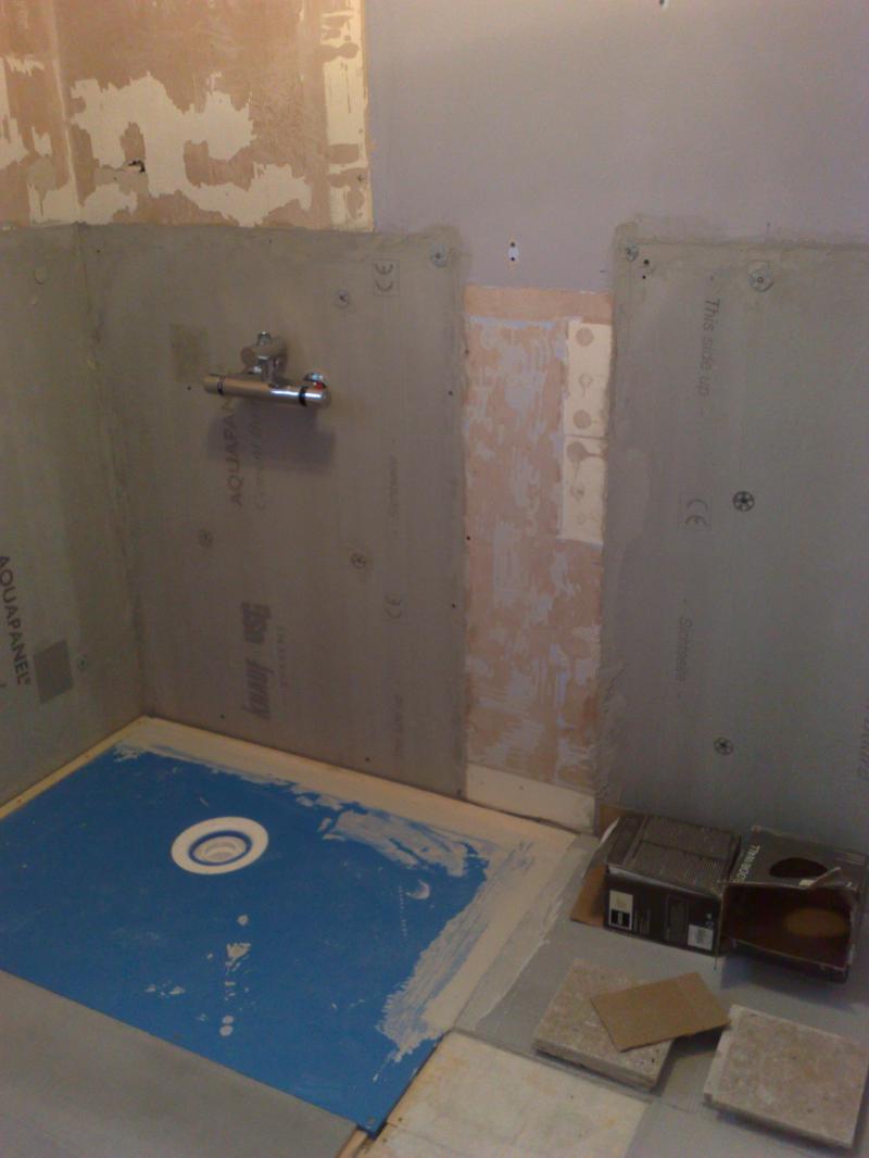

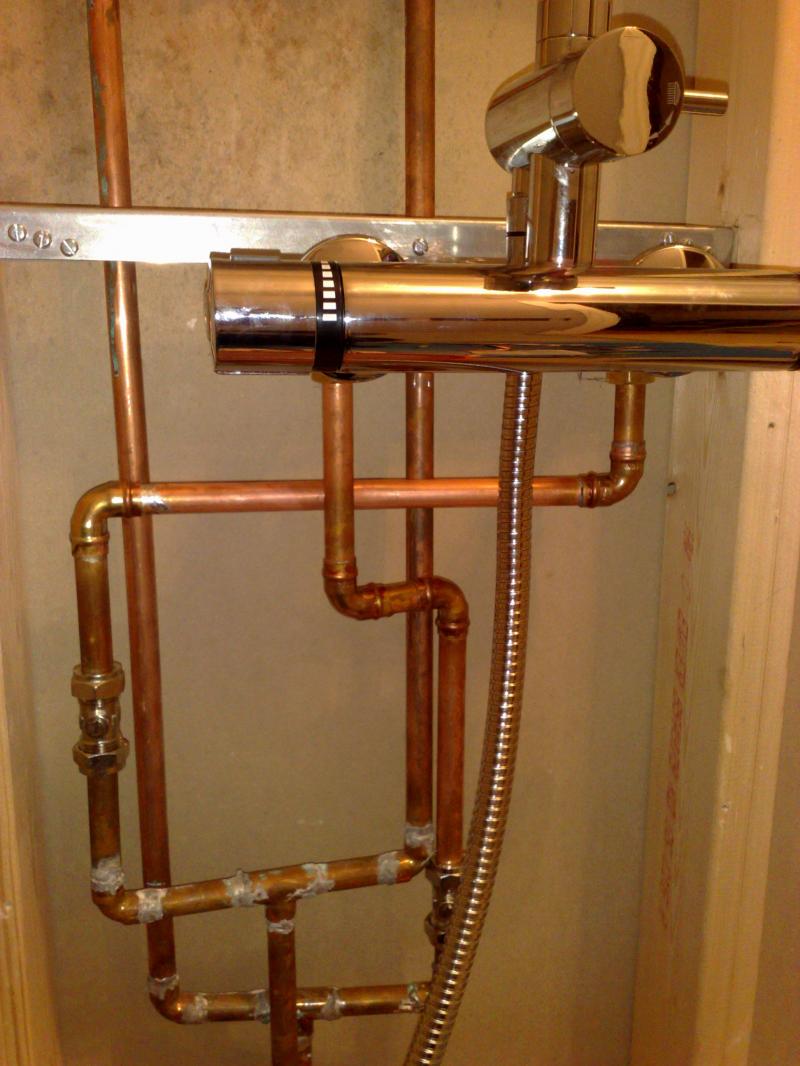

Thermal floor going down and shower all plumbed in.
I know the piping looks like spaghetti junction but I didn't want to move the other pipes from the shower next door, in the main bathroom, and it was easier to do it like that! :LOL: I have to box this up and do the other bathroom next so will probably change it all when I do that.
Should be finished the thermal boards tomorrow morning before work and then to start fitting the membrane over the weekend!! I don't feel a million miles off now, even though there's loads still to do.

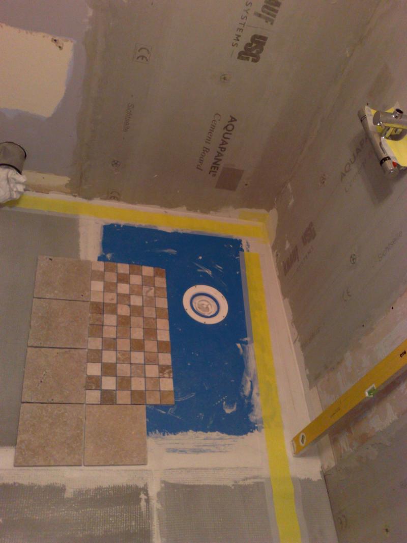

The only problem I have at the moment is that the drain cover and housing I was supplied with seems to sit about 4-5mm too low when sat next to the tiles. Don't suppose anyone knows if I can get a slightly higher drain cover in the same style as below? I would like it same level as the tiles if possible.
ready to start tanking room
you can see the tiles i'm going to use here. Planning on using the same smaller ones up behind the shower.
All of the thermal boarding is finished and the underfloor heating mat measured and prepared too.
Hopefully by end of play sunday i'll be well on my way. Watch this space.

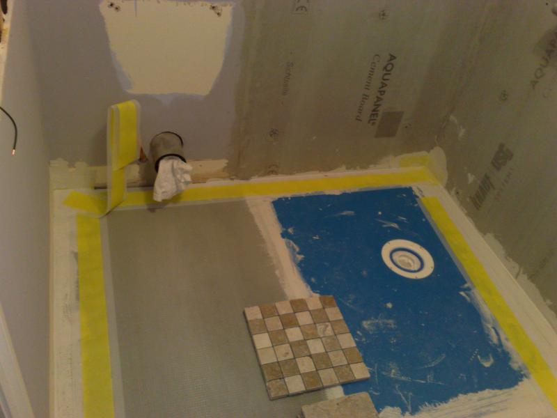

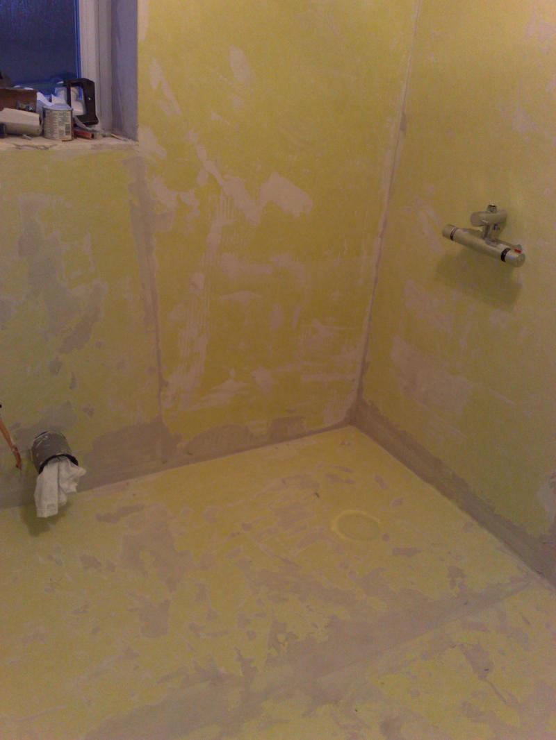

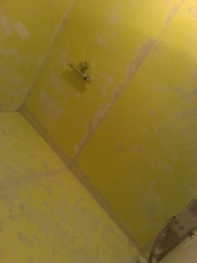

So sunday, a day of rest, and the room is tanked!! Not as easy as I thought it would be but I learned a few things along the way. How is it that those internet videos of people doing these jobs always neglect to show the preparation beforehand, ie mixing the adhesive, etc etc :LOL:
Anyway, couple of pics showing the tanked room. Probably start tiling wednesday but not in any rush really.
Yes I know, i've still to cut the hole out for the drain. :)

The underfloor heating is a no-brainer if you're doing a wetroom, in my opinion, as the room floor will always be warm and it'll help dry the floor quicker after use. Glad I did decide on it now. Unfortunately the water around here is very hard so it'll leave white marks on the tiles. Have to see how it goes and just re-seal the tiles regularly as they're travertine noce.
Still enjoying the project. Sure your tiling skills will be every bit as good as all the rest. I tiled walls first, left last tile off on bottom of wall, then had non-slip flooring fitted and lapped up wall. Then overlapped last wall tile over lapped-up flooring. Water drains straight off.
Waiting to see how the water drainage goes. When I had a wet room built, the builder hadn't got the slope to the floor drain correct - he kept saying "trust me" - and it had to be redone by the flooring people. Quite tricky to get slope correct at all angles to flow away to drain completely.

I have a bit of a dilemna! I can't find a shower drain that will fit with the tiles I have. (see above pic).
It sits too low and i'm wondering how other people have managed to get the drain top level with the tiles. Other than buying a complete drain system, which unfortunately, now it's all fitted and sealed in place, is not really an option.
ifatfirst, thanks for telling me about the gradient requirement. I have the correct shower floor/former fitted giving me about a 1:40 slope. This had better be enough. Now you have me worried.
:cry:
The other thing is, I can hardly screw a baton to the wall to lay my first row of tiles on as this would go through the membrane and make it pretty much a waste of time. I'm tempted to just start at the bottom as I have taken qute a bit of time over getting the levels correct in the room, and the spirit level doesn't lie. I don't think.
