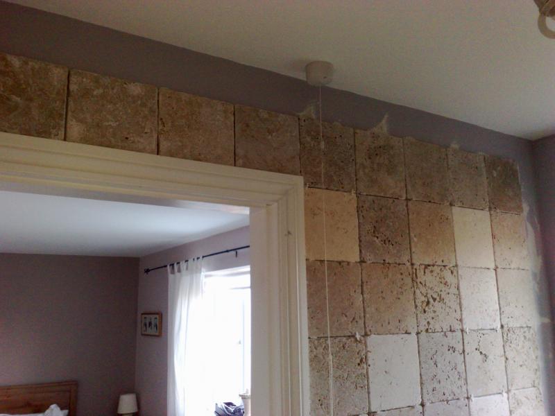

I've decided not to post the picture of my tiling start. The reason being that I haven't started in the conventional way, and I don't want to be criticised for the way i'm doing it. Judge it once i've done a bit more. It's at this point i'm getting worried! :LOL:

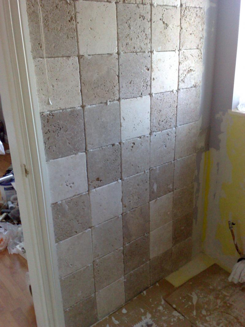

I think tiling using natural stone hides a multitude of sins. :D The tiles I have, really range in sizes so it's a bit of an effort getting them to work out ok. Just done 3/4 of another wall before getting tired of it, mind you, I was up at 5am for work, then started tiling 2.30 and just finished tiling half hour ago. Anyway, here's yet another pic to show I am making prgress. I am fairly pleased with it but i'll be more pleased when it's bloody well finished!! :LOL: Oh, and I can't wait to drill through the tiles to fit the sink, and towel heater and shower piping. That's going to be interesting! :rolleyes:
Before I forget, if anyone can guess how I tiled around the towel rail pipes, ( I didn't remove the valves! ;) ), i'd be interested to know how you might have done it. Surely the holes look smaller than the valves?

cheated and made a b***s of it I think. Not happy with the result, and might do those two tiles again. I cut them down in line with the pipes, then cut the holes and fitted the two tiles back together!!! :LOL:
I might have to isolate the central heating, remove the valves, put two tiles in place with pre cut holes.
I'll make a decision tomorrow when i'm tiling again! I know it'll bug me if I don't do it properly though.

Can't see the join at all on the photo - but if you can, why spoil the ship etc. I tried your trick on my cheapo tiles round the shower outlet pipes and it looked awful. Re-did it properly - begrudgingly: glad I did.

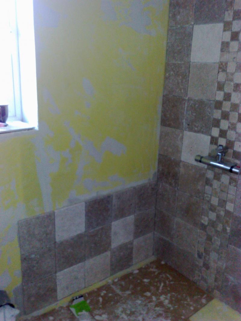

I'm going to see what the split tiles look like once grouted. Losing interest rapidly now. :LOL:

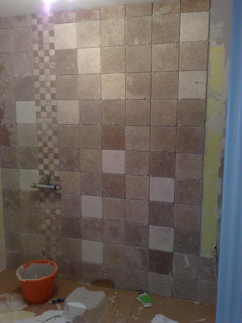

ericmark: I was thinking that too, but i'm hoping i've got a good gradient worked out and will be filling the floor tiles with grout as much as possible, to prevent pooling. I suppose I can only see what happens.

Hoping to get the walls finished tomorrow, so I can seal them a couple of times.

I remember getting very fed up when there were lots of cut tiles to do. Did them all by hand with a little wheel cutter thing (and you think you are penny-pinching??) - mine were only glazed tiles. Once you get the grout going you'll surge ahead.
Look how far you've come from the first photos and think how much you've achieved (and saved) by doing it all yourself.
