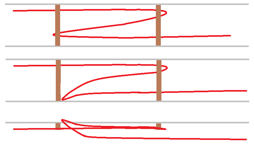

One of the issues which corrupts all sorts of ideas and designs is disturbing the contents. However all too often the work is being performed in a different place to where the wires are disturbed and damage occurs.
As an example the top is your design (no criticism), some work is performed to the right side resulting in the wire being pulled resulting in the lower fold coming from behind the inserted bar and being a fold tends to retain the fold which usually turns to one side and the space created by the inserted bars becomes a convenient void for it. In the very bottom (side) view shows the wire 'pops out' when the lid is removed.
The law of the sod stipulates that fold, loop or whatever we want to call it, is exactly where the toggle is.
