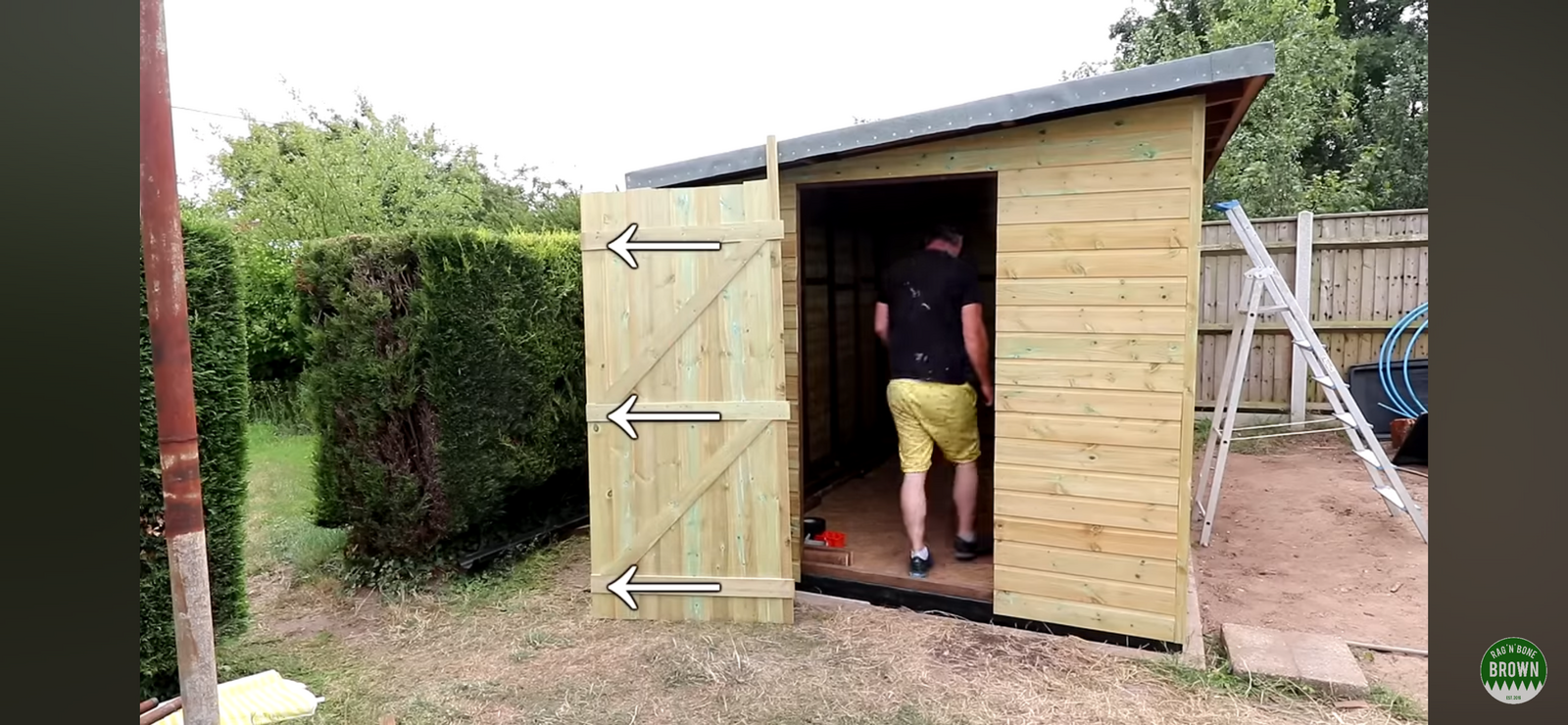

I will use this arrangement of bracing and as you can see, the horizontal braces are not right on the edge.
With the braces on the back, I was planning to glue and screw them. Is there any need to use bolts across these?
not advisable to glue external timber, that's why you build in expansion and contraction
no need for a frame thats more an internal fully sealed and painted non breathing situation with your cladding "breathing" with the weather they will fight each other to some extent
heavy duty "T" hinges allow for large expansion gaps
you only need bolts as a security measure

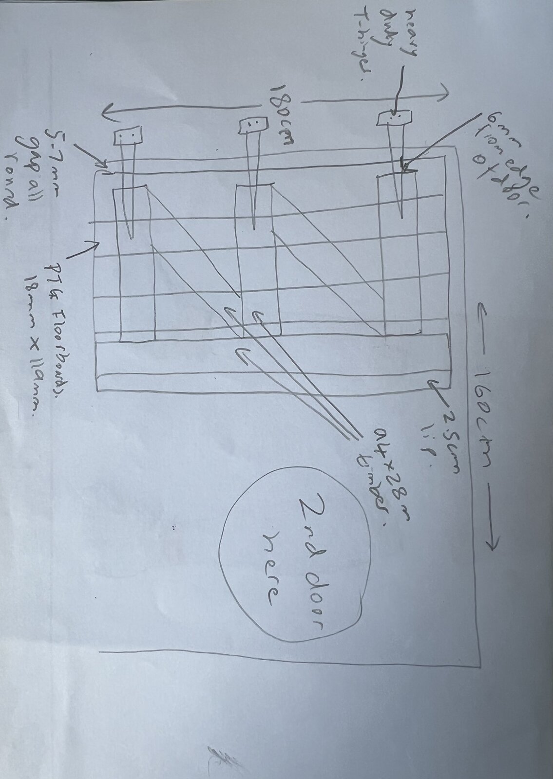

I am pulling all of this together and designing these doors, before I order the material. Can I please run this past you for comment.
As a reminder, I have two openings for double doors in each. The openings are 180cm tall and 160cm wide.

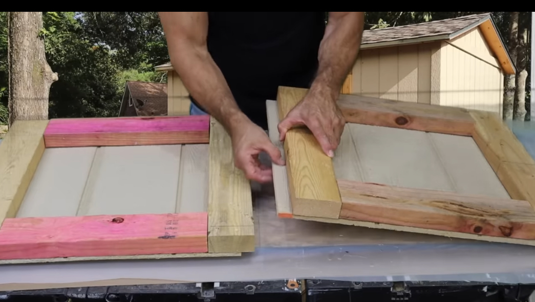

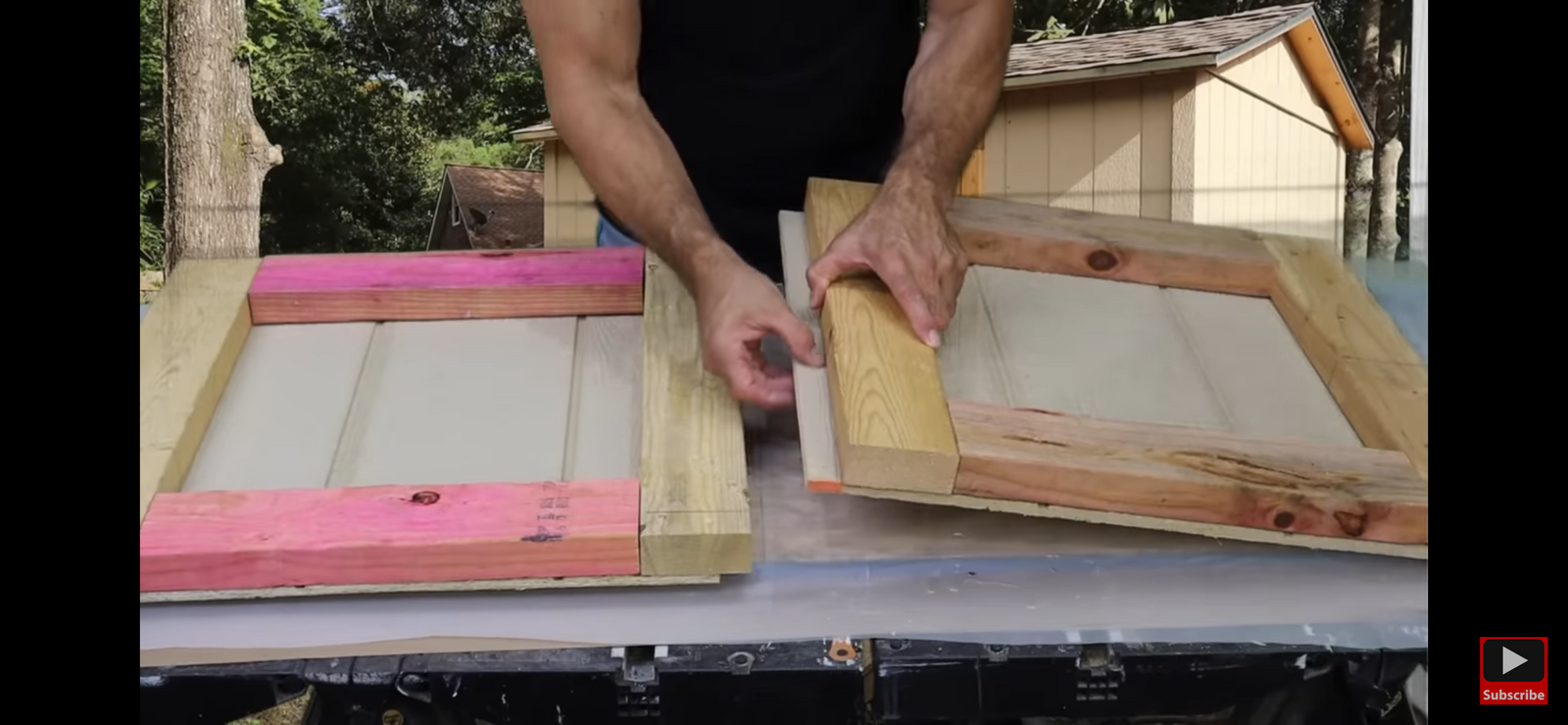

The lip is designed for the second door to overlap. A bit like you can see in this design:
I won’t frame like this. My proposed designed is sketched out above

- I will use a combination of bolts and screws on hinges for security, unless you recommend the use of “security screws”?
- am I okay to squeeze the T&G floor boards together by hand, as I don’t have a wide clamp?

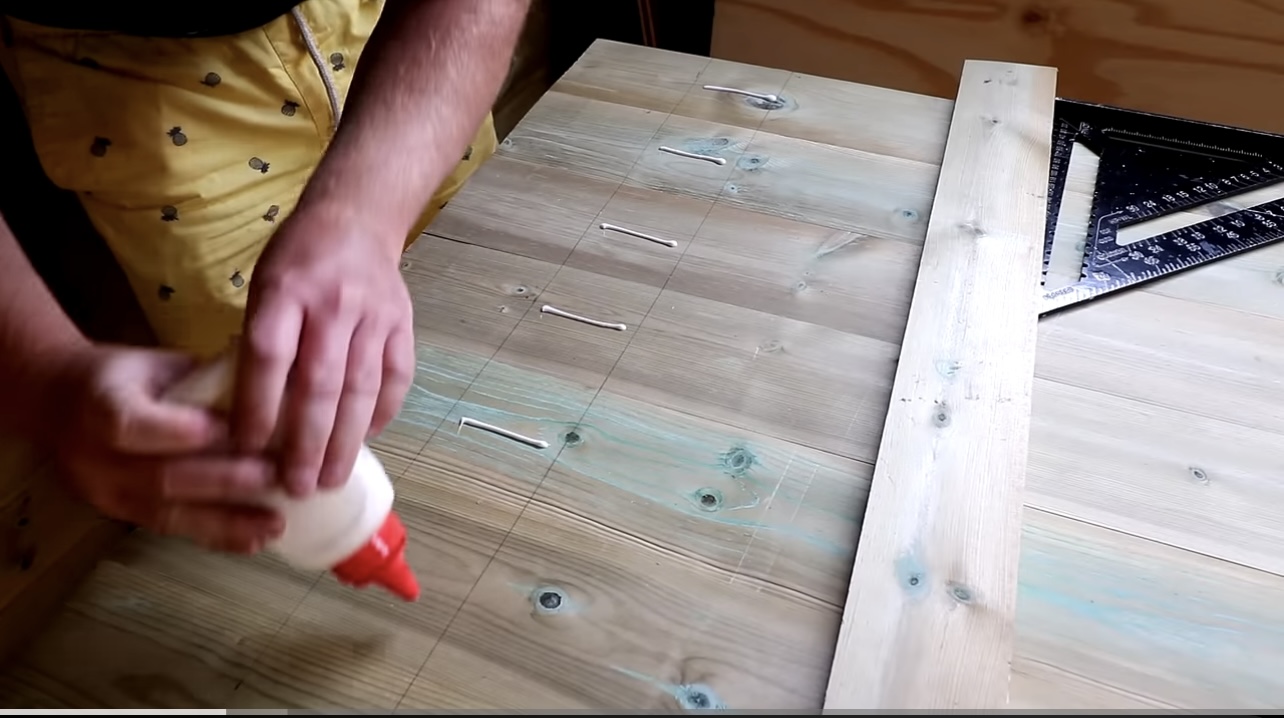

- some chap on YouTube was glueing and screwing the braces like this. Is this recommended?
Please let me know if you have any other comments or suggestions. Appreciate your help with this.
in my eyes gluing what looks like 7.5mm t&g onto a frame is a disaster waiting to happen
really not sure what you are trying to achieve
you would 100%NOT clamp together iff its ultra dry coverage will be 87.5-88mm so space appart to 90mm coverage for expansion
iff you are filly painting with gloss or other 100% breathable but waterproof it may work for a while but i wouldnt recomend it------other might though so wait for further comment as only my opinion

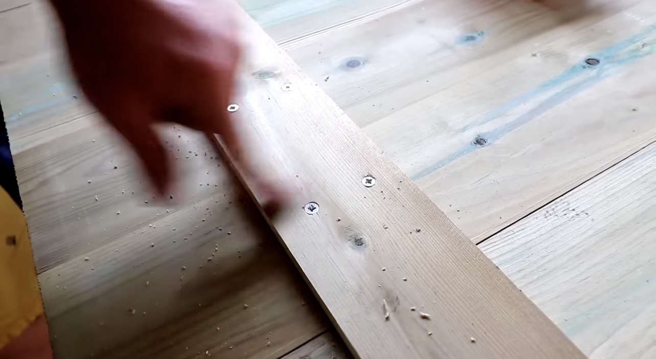

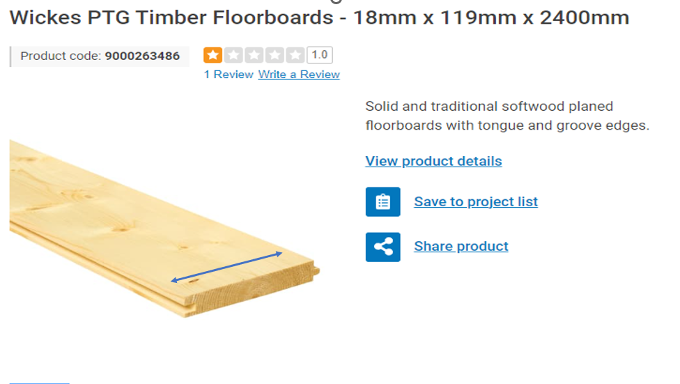

In my case, I will be using 18mm x 119mm T&G boards. I assume gluing is not recommended but would it be okay to insert two screws into each board, as show in that image?

Otherwise, does my proposed design look ok?

ok ex 5" is 110/11 coverage as they measure the tounge starts at 119
lay 2 planks hand tight together measure shoulder to shoulder [the coverage]iff its less than 113mm open to 113 if its more than 113mm close together as much as possible this is to give interplank expansion
you only need one fixing per plank this should be 1/3 width near the tongue or indeed blind nailed in the tongue at 45% degree angle

I would expect the blue arrow I have drawn to measure 119mm. This excludes the tongue, which is the same as what you have suggested.
If I put 2 boards together, I am expecting the shoulder-to-shoulder measurement to be (119 x 2) 238mm but you refer to 113. Can you clarify this please?
