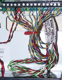

Twisting the spare wires together in pairs makes them neater and easier to handle like this:

I was actually terminating the individual strands much further up - giving me only around 20-30mm before I hit the white sleeving on the six core. That pic you posted suggests I can run them with much more core length. Good labelling too (I'm a bit OCD on the labelling front. I purchased a DYNAMO label printer for my ethernet switch - probably make use of it in the alarm panel too!

Is that your panel above by the way? I've also written on the incoming cables (and printed out the colour code to place inside panel...just as a reminder).
