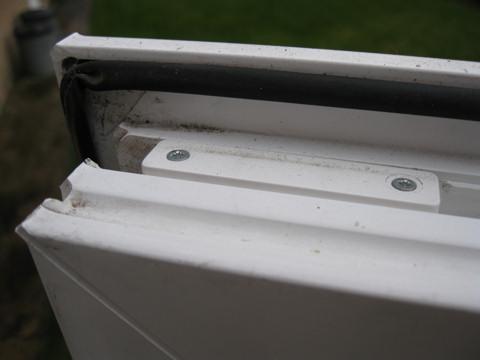

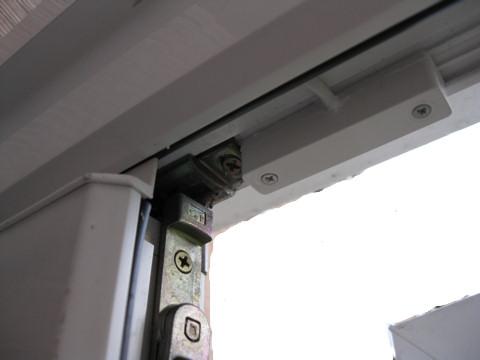

Often the magnet of a normal rectangular surface mount contact will (just) fit in the groove in the top edge of a plastic door (sometimes you need to cut a tiny bit of plastic away to get it in the groove) with the contact fixed to the frame above it, there is often just enough gap between door and frame to make this work.
Otherwise consider removing the magnet from its housing and glueing it into the slot in the door.
The wire can be routed within the hollow frame with a bit of patience. This lets you have a contact which is completely hidden when the doors are closed. Beware that drilling any holes in PVC frames can void the warranty if you have one.

That potential banana skin turned out to be anything but then.
That option works beautifully - I've placed the magnet and contact in the top of the frame and groove in the top of the door, and there couldn't be a better fit. I've not fixed them or wired yet, but slotted them in and made sure the door would close without anything sticking etc.
Perfect.
I'll post a pic, although your pics illustrated it to the T.
