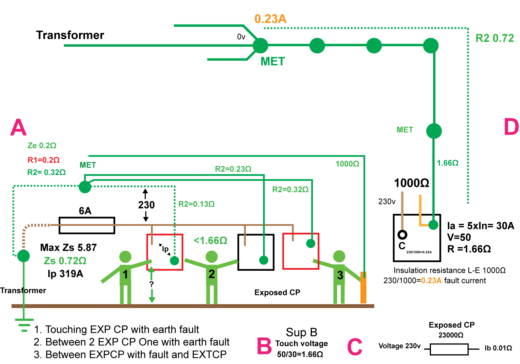

I don't really understand touch voltage, I'm embarrassed to say...
When I ask people they usually say , stop over thinking it , the RCD will take care of it..
Im not to keen on leaving everything to an RCD, Ive found a few that don't work as expected..
I know the principle. And exposed conductive part can't reach a dangerous potential >50v
What I don't get is how the voltage can't rise above 50v.
230v is supplied to a class 1 switch.
There is a live earth fault. Chap No1 is touching it.
So the shock potential would be between his finger and his resistance to the floor.
The CPC will take the fault current around the EFLI path and trip the fuse within 0.1 - 5 seconds.
The Zs of 0.72Ω suggests the fault current will be 319A
Now if 319A appeared at the switch, even for 0.1 seconds, I would have though that would kill you.
That is a low impedance path though
Say his resistance to the floor is 1000Ω and the resistance back to the transformer is 1000Ω
so 2000Ω. 230/2000 = 0.11A.
But these resistances are never a constant, could be more or less, and 0.1A can still be dangerous. I also presume that when ADS was being designed, one of the calculations was not the possibility that you are wearing wellies.
Some other impedance must be involved.
So a 319A fault current is making its way around the loop, in the CPC, and for a brief moment, raising everything to a fault potential, until the OPD trips.
Chap 2 is touching the faulty switch and a switch with no fault.
He could be between 0v and 230v
But the CPC are commoned back at the met.
Now it this was in a special location we would want < 1.66Ω between them. If not, it needs supplementary bonding but 1.66Ω that quite a lot, but thats 50V
Chap 3 is touching another faulty switch, but also an extraneous CP with a resistance to the met of 1000Ω, but this is not bonded.
Chap 3 is in the trouble.?
So touch voltage must be limited. but how does it work.
You have 230 at the switch, but the metal work is limited to a rise above 50v

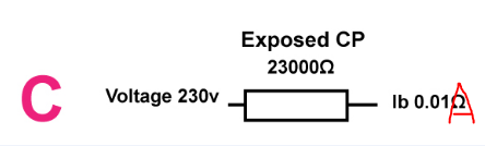

As in C- in the drawing (Should say Extraneous CP) a resistance of 23000Ω between you and 230v would give a fault current of 0.01A. That seems straight forward.
What resistance is in the way of the 230v to limit it to 50v
For a 6 amp circuit R <50/30=1.66Ω
So if two Exposed CP were measure to have 1.66Ω between them supplementary bonding is not needed. But that is with the voltage at 50v
So after all that waffle, simple question how is the 230 voltage restricted to 50v?
Oh and another bit....
That drawing on the right, if the fault current is only 0.23 amps, it won't trip the fuse, but 0.23 amps will be on all metal work, and you can feel that. No RCD
I hope that make some sense...

It's not a very good diagram, is it?
Surely no.1 is not related to supplementary bonding and touch voltage. Is the floor wood?
The floor appears the same in all cases yet no specifications are given for it.
What am I missing in 'C'? What does it represent?
Not withstanding the error - 0.01A, and it's hardly Ib, is it?
Why is the exposed-c-p 23000Ω?
Taken alone (which is perhaps not fair) it certainly seems to be somewhat of a confused/confusing abomination (quite apart from the errors) - but there may well have been some accompanying text which made things much clearer.
Fortunately, however, in contrast with the diagram, the OP's questions and 'difficulties in understanding' are very clearly expressed - so fairly straightforward to address.
Kind Regards, John
Yes sorry, This is a diagram I did my self, and there are a few mistakes in it. It helps me understand better, when I draw things out, but not anyone trying to decipher it...
Im glad I've made one thing clear.:)

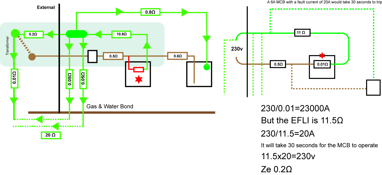

Another drawing. Apologies for the mistakes in advance:whistle:
two drawings of the same thing, one just simpler .
Its still the touch voltage thing...
This time the Zs is to high so the MCB will take 30 seconds to operate .
So in those 30 seconds what happens at the switch where the fault appears.
What voltage could it be at?
Voltage is the constant isn't it. we can affect the resistance and the current flow?
Or have I got the very basics wrong.
Ok. Not likely but go with that.
However, touch voltage refers to the voltage between two e-c-ps.
That's why I said Chap 1 is not relevant.
I'm a bit confused what is actually being asked and discussed.
The switch will be at 230V wrt earth.
If you touch that and earth, you will get 230V.
If you touch that e-c-p and another e-c-p it depends on the resistance between them
Negligible resistance because of bonding and they will both be at 230V wrt earth but 0V between them.
It will still depend on whether you are standing on an earth or not.
