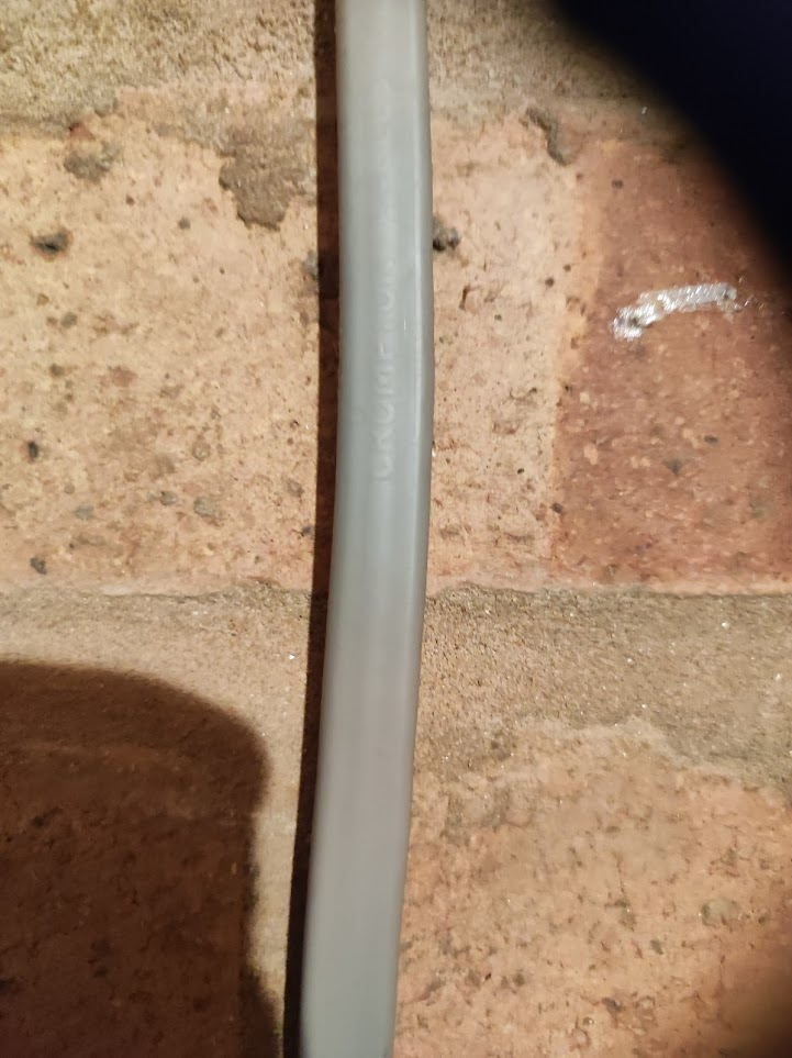

Definitely not rubber, my colleague who had a good look said it was pvc and the bits he examined were in good condition but that it was 'old colours'

FWIW if it was built in 1977, and has white twin and Earth on the sockets it’s almost certainly 2.5 mm / 1.0 mm

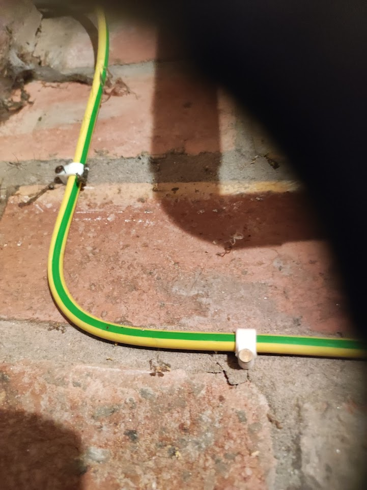

There are two types of wire visible around the house, one is grey and the other is green and yellow. I am not sure but i think my colleague said the green and yellow is the bonding that should be upgraded
All the visible wires are like one of these, the green and yellow are attached to my pipes etc. The wire i saw above the kitchen ceiling was the same as the first pic.

Tony, the green and yellow conductor is later than the date of the build.
Before 1 January 1978, solid green was the colour for earth and bonding conductors.
