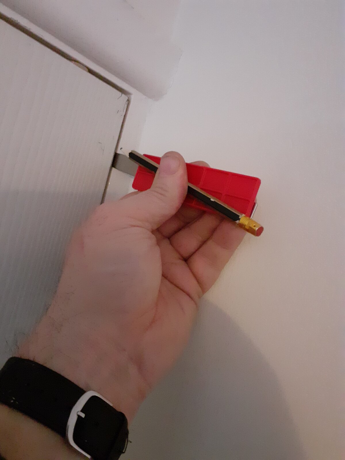

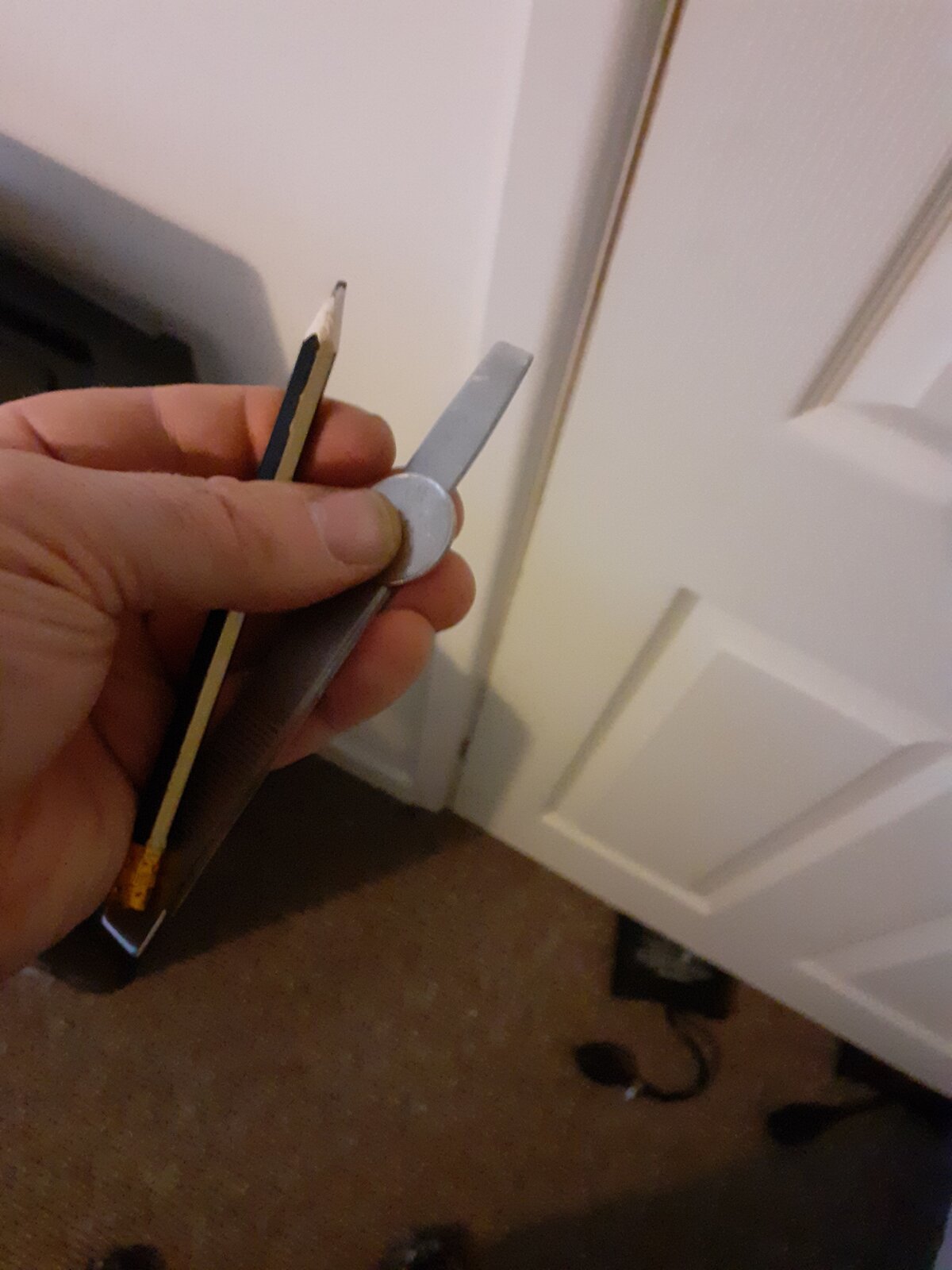

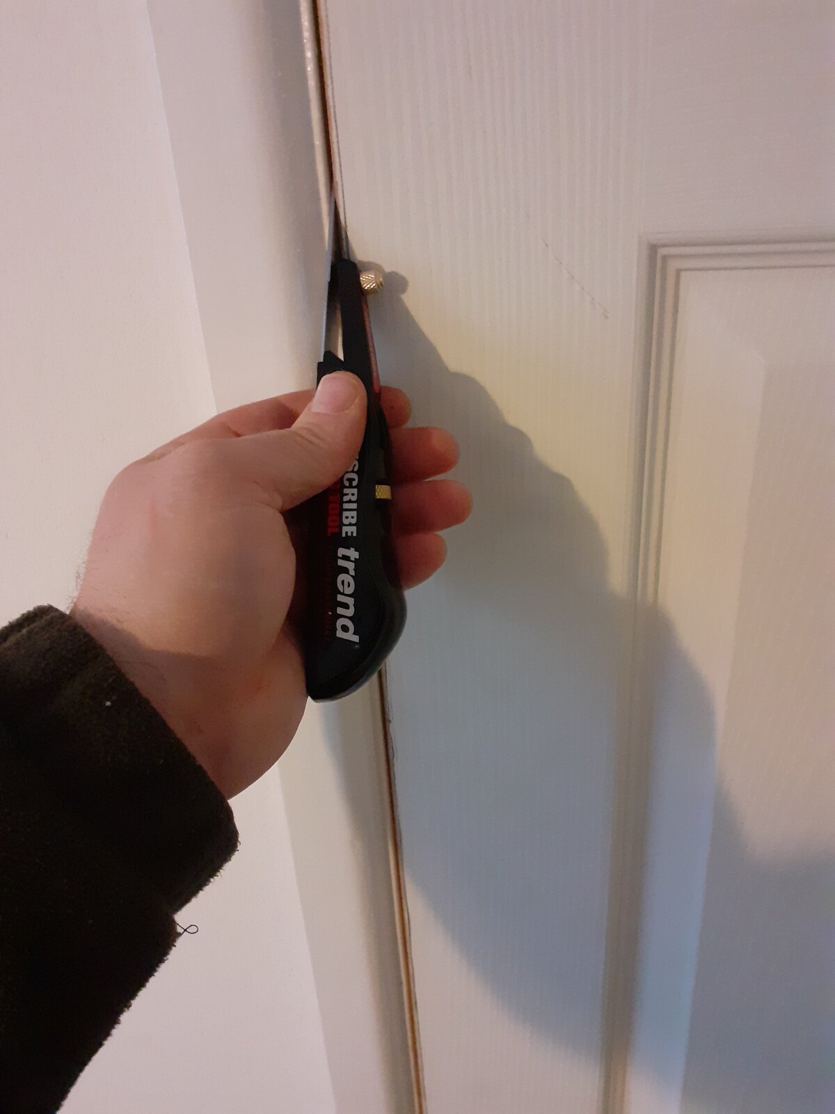

I tried to scribe the narrow side bits of door (once jammed in)with the trend easy scribe tool but the lead kept slipping, moving and snapping. So tried the thin metal bit from this tool ( took out of tool to push into narrow gap) combined with a 10p coin or 2mm packer pushing pencil into this with my finger and had more success. It's tricky though mainly because the gap is so tight.
Another issue was the gap on hinge side was too narrow. To deal with this I put a blue 2mm packer under hinge which seemed to help. Dont know how thick you can pack hinges out mind.
TBH matters less initially if the fit is tight, so long as the gap is fairly consistent and doesn't exceed 3mm anywhere (or less on stamped mild steel hinges). The danger is taking off too much, too early. This is because you can always plane a millimetre or two off a door with the power planer or a jack plane (remembering to take even amounts off each side in turn to keep the door stiles looking visually alike). Hinge gap is approx 3mm for stainless steel or brass fire hinges, cheap domestic stamped steel ones are often more like 2mm or so. Check the hinges, but remember that stamped steel hinges can be swaged to reduce the gapping a bit if they are a bit "loose"

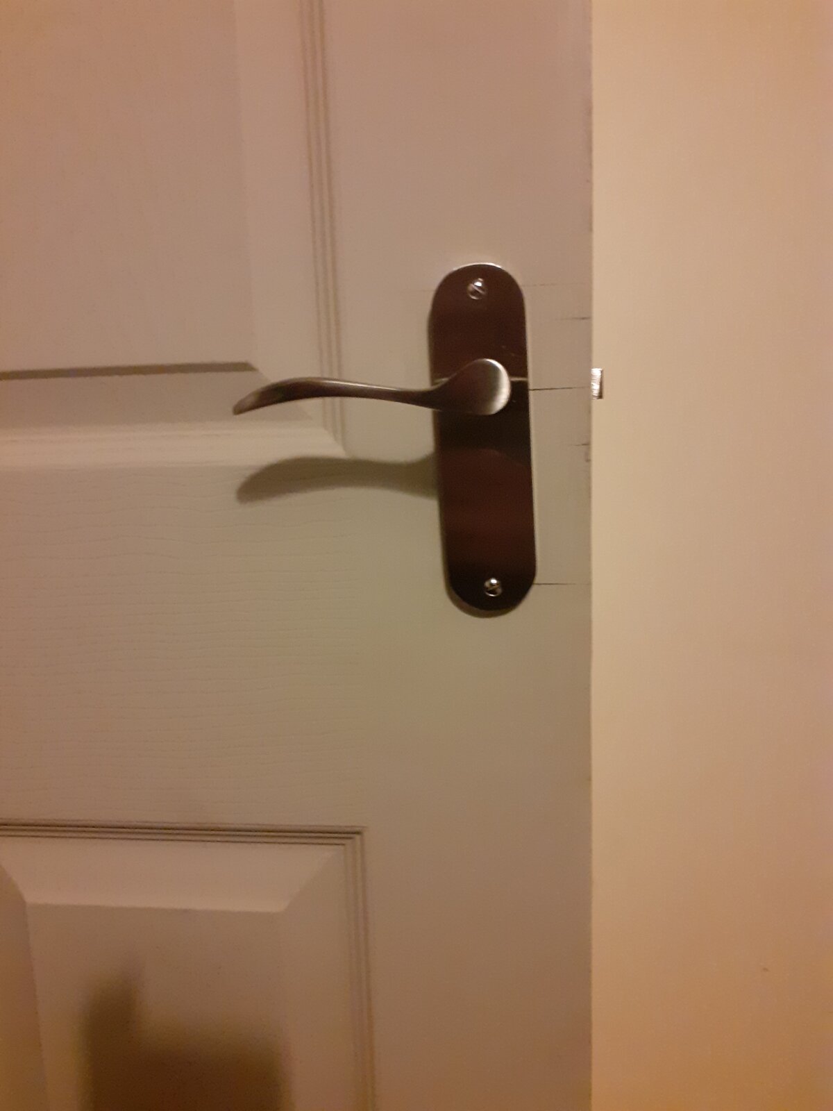

I think I drilled too big a hole for the bolt through screws after not getting them lined up , the handle is now on the ****. Not straight as u can see. Anyway to rectify that?
Take the handle off then depending on what size screws youve use whittle some slow taper pegs . Then tap them in the old holes with a little wood glue.when dry refit the handle in the correct position

This can be done "after the fact" as well, but you may well need to remove the ironmongery, redrill the holes to something like 6 or 8mm diameter (standard twist drill, NOT a brad point or a spade bit - go slowly), glue in wooden dowels (softwood if you can get them, for this door, hardwood but not beech for exterior grade hardwood doors), flush trim the dowels once the glue has set and finally refit the handles and plates onto the spindle, realign each of the plates using a correctly set combi square, and then pilot, drill and screw the plates to the door, making sure that the handle works smoothly and doesn't bind.
If it helps, many locks and latches in the UK have spindle centres at 44mm (1-3/4in) or 57mm (2-1/4in) meaning that you can mark a very light pencil line down the door on both sides (if the door is not being over-painted consider running some masking tape down the door before drawing the lines, on the tape, to avoid marring the door finishes), then using a combi square to help position your handle set

Got this dowell, did u say must be hardwood? I bought soft but can get hardwood. Its diameter is 1mm too small but I have another slightly bigger one which I could trim down for a tight fit. Push it all the way through with glue right?
I'd probably use softwood dowels on softwood and composite (chipboard core) and hardwood on hardwood doors. What I aim for is a dowel which is of similar colour and hardness to the original structure.
The fit of the dowel in the hole really needs to be very snug indeed, so I don't think that filler, excess glue with sawdust, GripFill or any other filler would be even half as effective, in part because it is just one more thing to fall out if you stress it (such as if you saw, chisel, plane, drill, screw or sand it)
Don't push all the way through unless there is no lock body in the way. If by pushing it through you would end up going through the lock body mortise, you will need to cut it and insert small "plugs" in the door, one each side, hence the need for a snug fit
