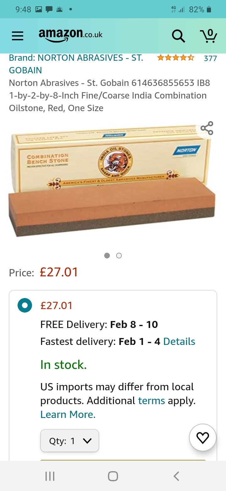

You might want to consider a Norton IB8 8x2x1in combination oilstone (100x/320x grits) or similar (don't buy cheap Chinese carp and avoid waterstones), but remember that milestones hollow over time and as a beginner you have enough to concern yourself with.
Found these-

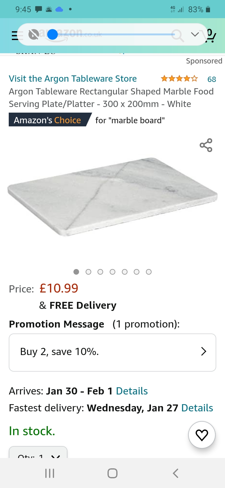

Forget that marble board and use a piece of glass on a flat surface for now

On the subject of glass, IMHO any old piece of window glass won't do - it needs to be float glass (which has a perfectly flat surface) - although to be fair since the late 1980s even plate glass in the UK has been made with the float glass process, althougj old window glass might not be float glass and therefore not particularly flat (rolled glass, the older process was pretty variable). The reason I recommend thicker glass is that it is more stable and less likely to crack than the thin stuff if placed on a slightly uneven surface - 4 to 6mm window glass may need to be fixed to two layers of 18mm plywood (glued together) to avoid cracking if too much pressure is applied - hence the pastry board alternatives (and neither will heavy plate glass crack on a slightly uneven surface). Glass needs to be handled with care; unless specified window glass often comes with a sharp edge which can cut flesh easily if you are unfortunate enough to have an accident - glass merchants can "safe" the edges or even polish and bevel them, but this is often an on cost and must be specified at time of ordering

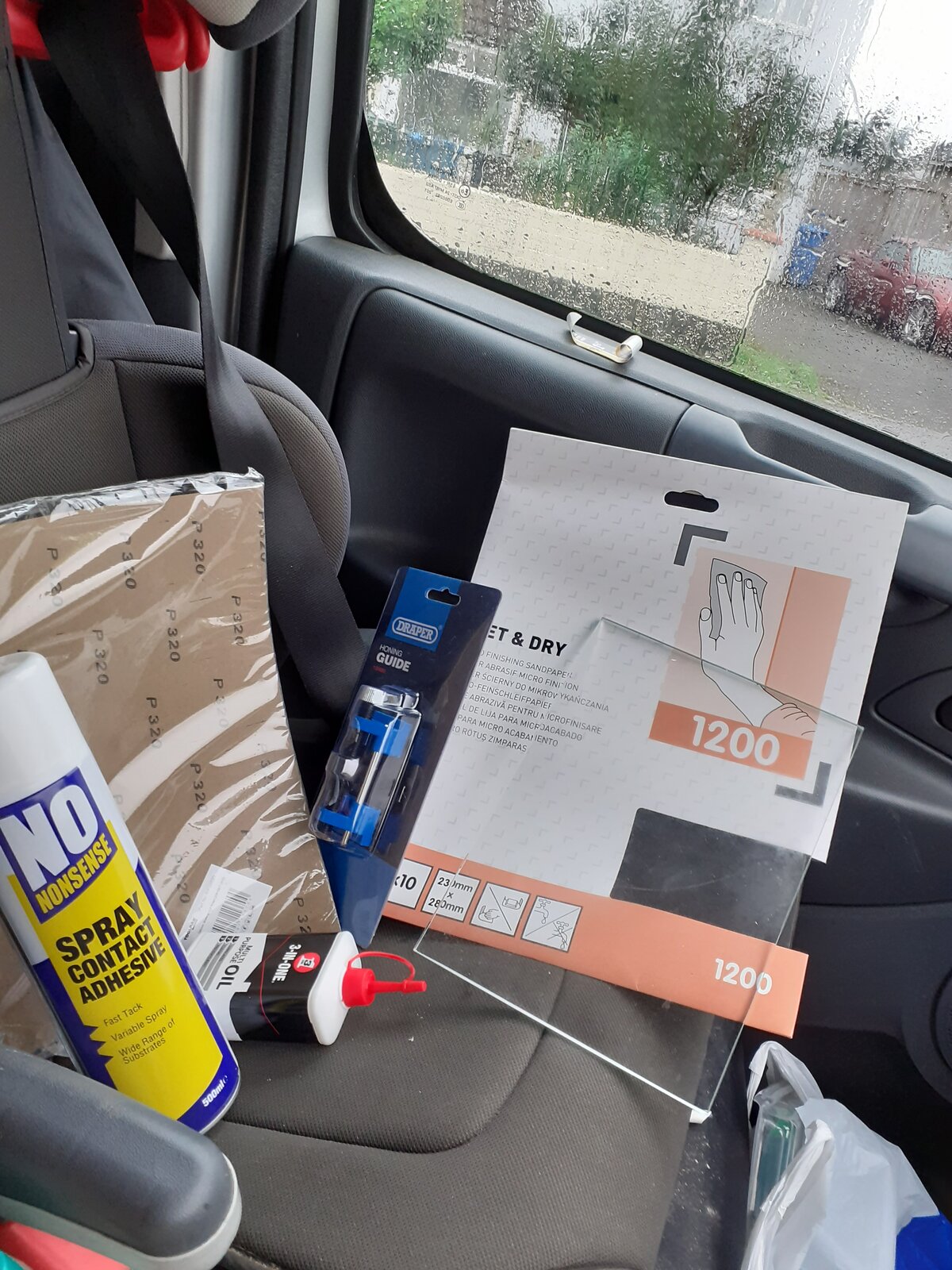

Bought or already had the stuff in photo- I found some 7 or 8mm thick glass in my shed. I've got 180, 320 and 1200 wet and dry silicone carbide paper. Which one do glue to glass?

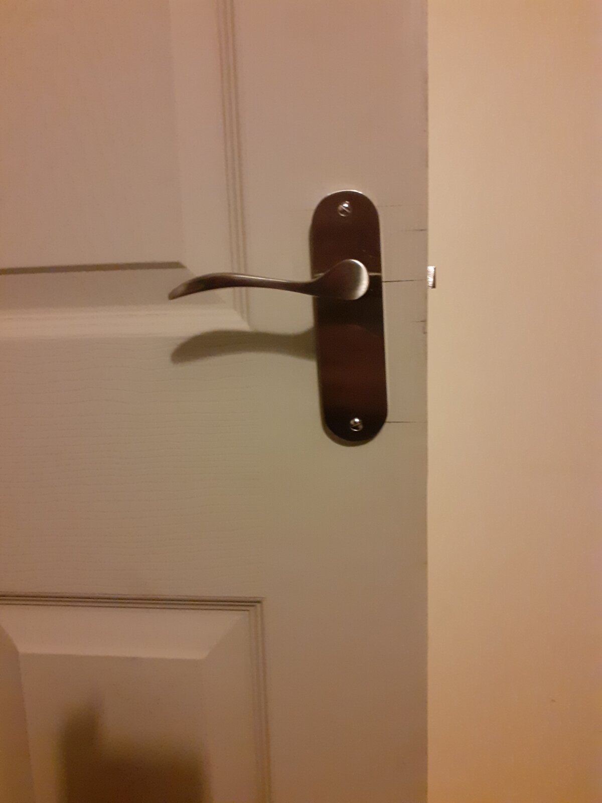

I think I drilled too big a hole for the bolt through screws after not getting them lined up , the handle is now on the ****. Not straight as u can see. Anyway to rectify that?
Apologies in advance, but your posts / attempts at stuff do make me smile. I can never work out if you're actually winding us all up. How do you manage to get it that cock eyed?
Is it float glass? If not it won't be flat and will cause more problems than it will solve. If it is float glass make sure that the edges are "safed" or bevelled so that there in no sharp edge which can slice your fingers open. If you can't do that, don't use it. If it is useable it will need to be supported on a piece of thick MDF or plywood (two layers of 12 or 18mm offcut glued together would be great).
Silicon carbide or wet and dry (dark grey) is the right stuff but I'd suggest getting a sheet each of 120, 240 and 600 grit (500 grit will do) as well. Cut (from the back or it will wreck your blade PDQ) or rip into strips and glue strips of around 10 to 12in (250 to 300mm) x 3in (75mm) wide side by side onto the glass using spray adhesive. Going left to right I'd have 120, 180, 240, 320 and 600 grit (15in or 375mm wide in total). That will mean for sharpening goosed blades you can start by honing on 120 grit, then moving to 180 grit and working up through the grits to 600 grit. You need to wipe off the edge of the blade with a piece of cotton rag or kitchen towel every time you go up a grit. You also need to spray or dribble some light oil on the abrasive paper before using it and if it starts to clog or gondry ad a little bit more. Do not dry grind as it will clog the paper double quick and ruin it. To check progress you can blacken the bevelled edge of the iron with a black felt tip marker. When you sharpen you will see the black disappear where you've ground and shiny metal appear. You will find the most work will be necessary on the lowest grit numbers with progressively less strokes required on the higher grit numbers to achieve a good surface. Start by trying to get a good single bevel first - secondary levels can come later
