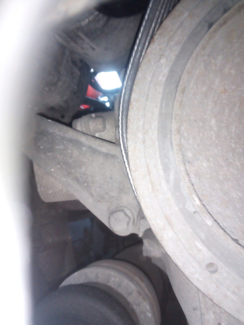

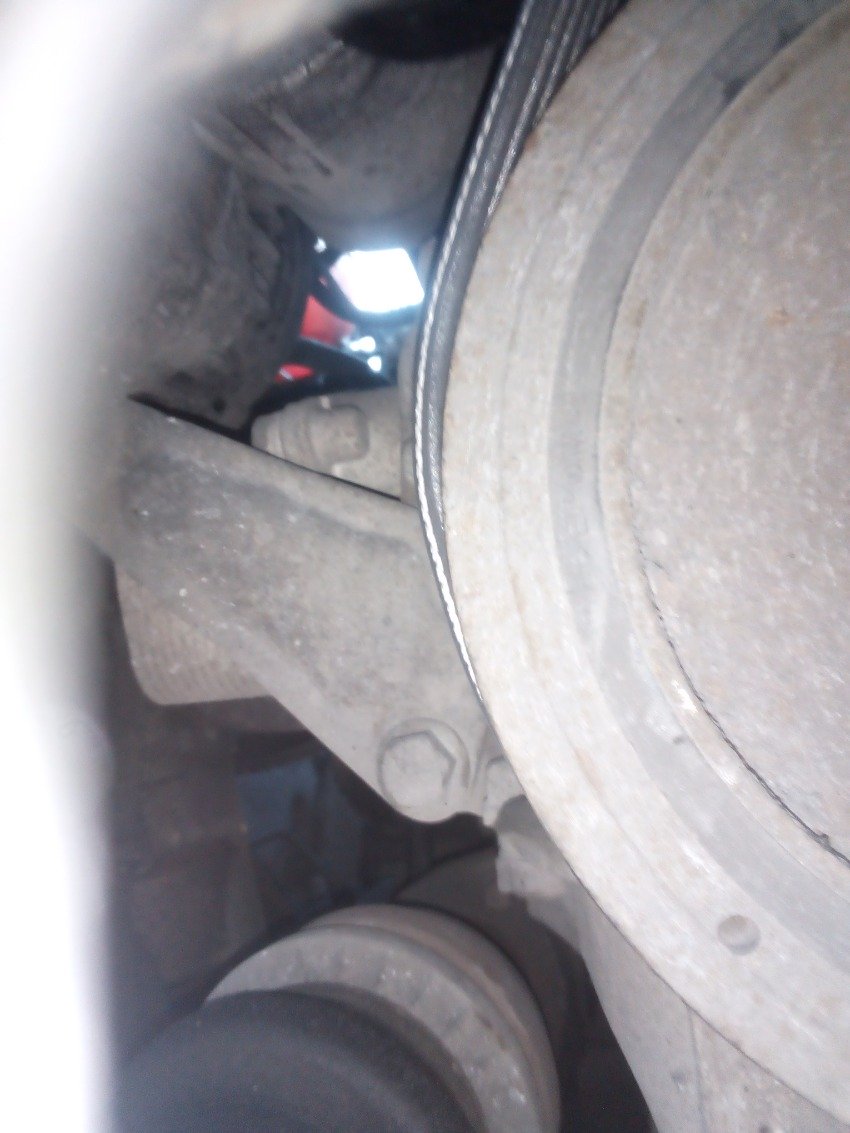

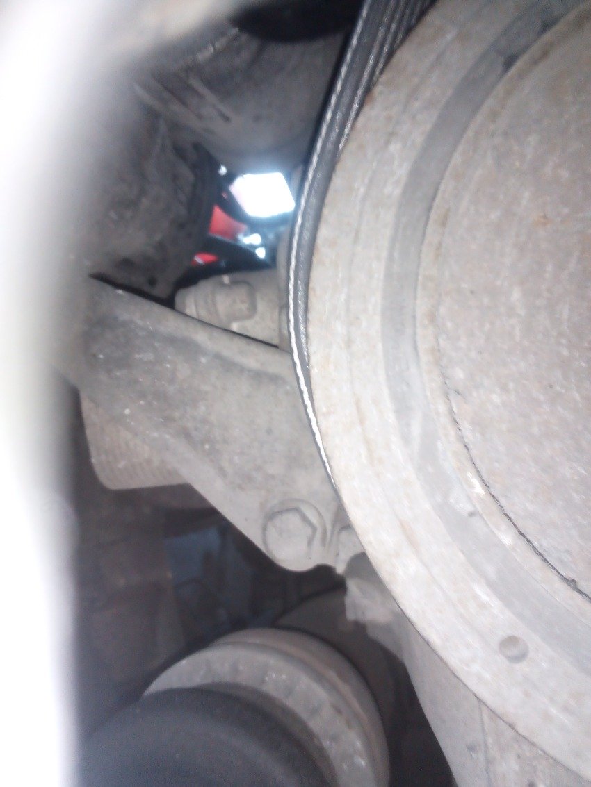

Do I hold it above the pulley or underneath or does that not matter ? I was wondering why the belt is fine after fitting it and looks straight from above, but after I turn engine off after 20 seconds or so I see it is wonky and that the belt has slipped off a little bit from
the crank pulley , what can cause that ?
there is also a pulley missing, thel ittle one that should be to the right of the crankshaft pulley

Hold it across the face of each pulley and gauge whether it's in line with the rest.
Definitely something wrong somewhere.

I'm probably going over what the good men and true have already said but anyway....with the belt off:
Spin each tensioner / guide by hand, listening for a whirr or rumble.....that includes the alternator.
See if the noise changes with the air conditioning OFF.
Look at the spring loaded tensioner and see if its wheel is parallel with the other pulleys (I have seen one bent one before, but not sure how it happened).
Get a lever behind the crankshaft pulley and see if it can be gently prised away from the engine. There should be no movement.
