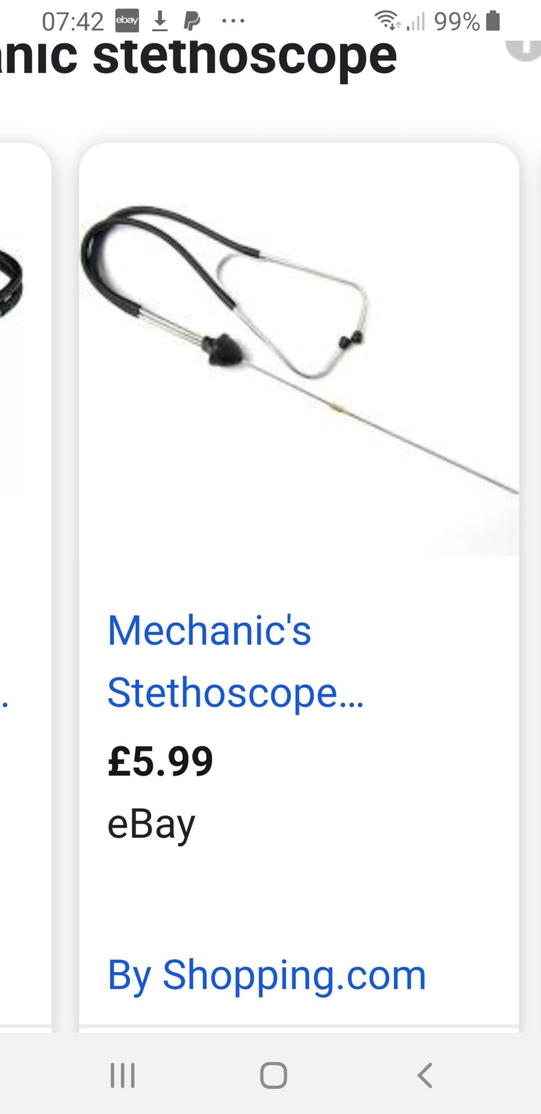

You'd be wise to invest in a pair of these for pinpointing the noise, I use them frequently at work.
