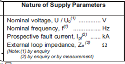

Good point, and easy to snipe from the sidelines. But , a minor works certificate lets you only record the Zs of the single circuit being worked on. The change of a consumer unit requires a full Electrical Installation Certificate, and this needs Ze to be measured and recorded.
Recorded - but not necessary 'measured' [ see Note (2) ] ...
This goes to show how important proper testing is, there may not be any Ze conductivity at all, because of the state is the service head. His EFLI measurements, and his house earthing, may be solely relying on bonding to gas and water services.
I've already acknowledged the latter, when I clarified that I had not meant to suggest that the service head should not be 'looked at' by DNO. However, as regards the former, as per the above, it is not necessary to measure Ze in order to completer a BS7671 eic.

You're right about the first thing but, as I have just illustrated, not about the second. You (or anyone elser) do/does not have to "borrow a test kit and measure the ze" in order to complete an EIC, since you are allowed to record on an EIC the Ze as 'determine by enquiry' (i.e. by asking the DNO - who will then give you a figure {without measuring anything} which will be the maximum permissible Ze for the type of earth - usually 0.35Ω for TN-C-S {"PME"} or 0.8Ω for TN-S).

Exactly. I can't disagree with that, since you appear to be repeating what I just wrote :) - which, as you saw, was ...
... you are allowed to record on an EIC the Ze as 'determine by enquiry' (i.e. by asking the DNO - who will then give you a figure {without measuring anything} which will be the maximum permissible Ze for the type of earth - usually 0.35Ω for TN-C-S {"PME"} or 0.8Ω for TN-S).
As you will realise, I was merely pointing out (for the sake of providing 'correct information'!) that TTC and Michaelsf90 were not right in saying/implying that one "had to" measure Ze in order to complete an EIC, since the BS7671 EIC form itserlf says that a 'by enquiry' figure is acceptable.

I high current test Ze on every installation. Whilst it’s rare, even TN-C-S supplies can sometimes be outside the spec due to a bad connection in the head or an excessively long supply run.

You can record either measured or calculated figures on the certificate.
