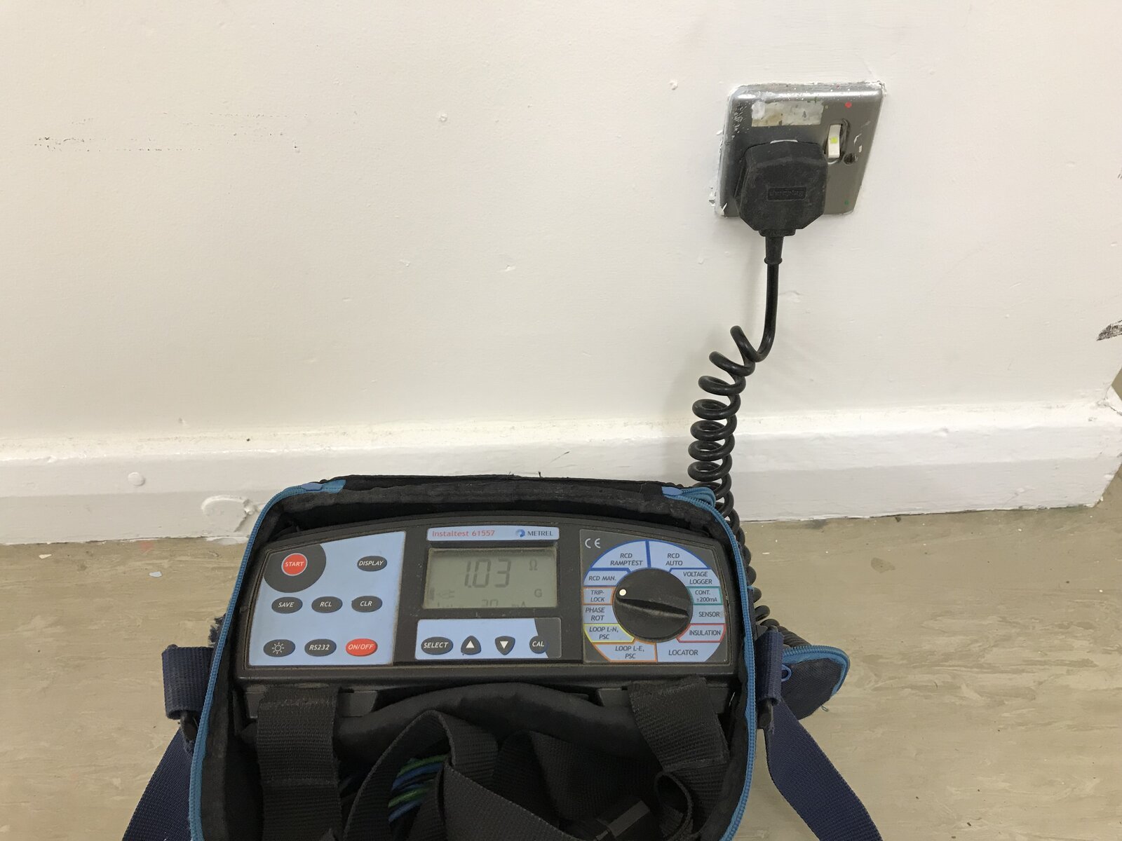

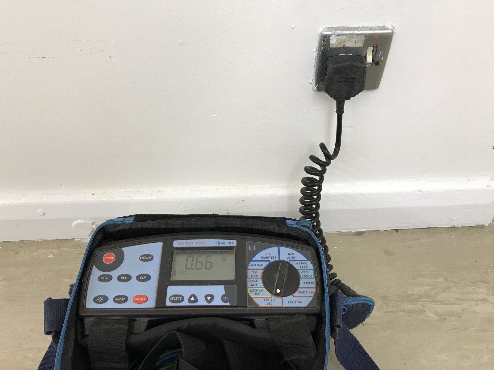

Found a non RCD socket outlet on my travels today.
Low current (top) and high current (bottom) Zs test carried out.
Found a non RCD socket outlet on my travels today. ... Low current (top) and high current (bottom) Zs test carried out.
Interesting. Thanks, and consistent with what secure suggested. Do you have any thoughts about a possible explanation for the difference?
... and, of course, importantly, what was the R1+R2+Ze at that socket? (you did measure it, didn't you? :) )
Kind Regards, John
I’m not sure why this happens. Perhaps it’s harder to get an accurate reading at lower current or maybe it’s a scaled up reading from a smaller actual reading relative to the lower current.
Sorry no calculated Zs I wasn’t actually working on this circuit. I just tested it for this thread!
I don't know. In the end, it presumably comes down to measuring a current (or the voltage across a known resistance) and that can be done accurately from microamps up to mega-amps
Fair enough. If the opportunity to find out ever presents itself in the future, it would be interesting to know which of the Zs measurements was closer to the 'calculated' figure.
Kind Regards, John
