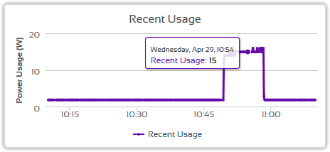

I have used smart plug adaptors a lot, but they do vary two of mine show usage charge29-4-20_6.jpg on the PC, but most only switch on/off, can hardly call them smart, I know one of the smart adaptors will connect using IFTTT to other devices so if for example my thermostatic radiator valve reports temperature over a set point it can turn on the smart adaptor and run the air conditioning unit.
