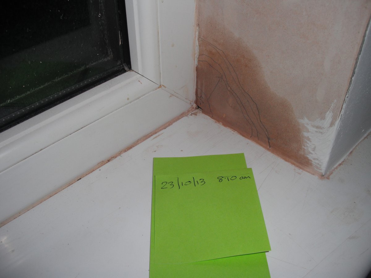

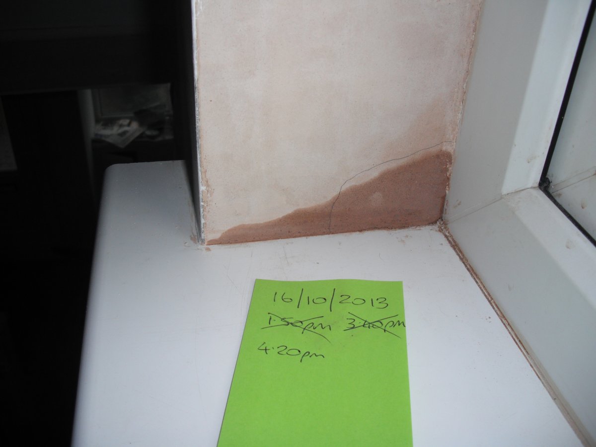

Hi
thought I'd share photos of my windows as they were after I had the hall plastered, I wasn't aware for eight years that water getting in until having it plastered highlighted that there was a problem

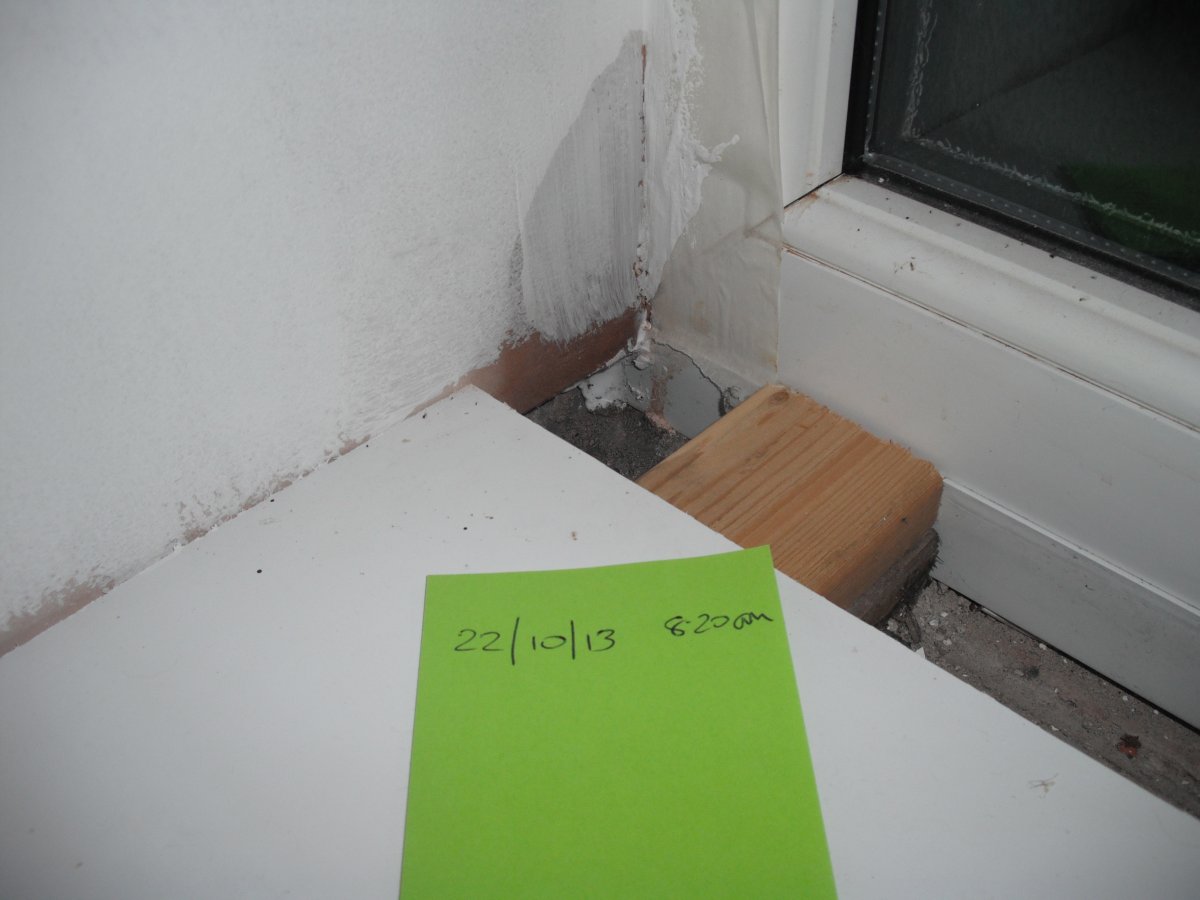

Looking at your First Picture and second picture, yes you will suffer quite a bit of damage to plaster, as the window frame seems well embedded into the plaster on both sides, so removing it is not going to be a clean and easy job not an option really unless you really wanted to fix damage to plaster as well.
However, I can now see clearly that the only way that rain water gets inside is through the gap at the bottom from outside
The gap between the window and the sill, at the bottom, if you look on the 2nd picture, so just have that gap cleaned thoroughly and fill it up with silicone sealant, that should stop all your rain water seeping in from bottom, in heavy rain water splashes about and bounces off hard surfaces and can enter upwards as fine droplets, run sideways and into the wall.

when we had our windows replaced the old original plaster from when the house was probably built did not sit fully flush to the new window frames so it wasn't visible there was a problem, it was only when the hall was newly plastered right up to the frames (8 years later) we knew something wasn't right, both the windows have been fine since they were reinstalled correctly and that is because the sills are now sealed with silicone at either end of the frame which stops the water travelling off the end of the sills and into the bricks.
The window frame and window sill are separate pieces so if they are not sealed the rain water will just carry on travelling along the sill until something stops it which was our house wall (our house is solid brick).

I've recently removed them from one window as I was getting blinds fitted and wanted the window without the plastic strips in place so got a plasterer in to plaster the window edges, told him the problem I'd had with the hall/landing windows and when he knocked the plaster away so he could get a flush finish, guess what, it was wet, completely hidden by the plastic strips, so out came the sealant gun and I shoved as much as could into the gaps on both sill edges and hopefully I got enough in.
