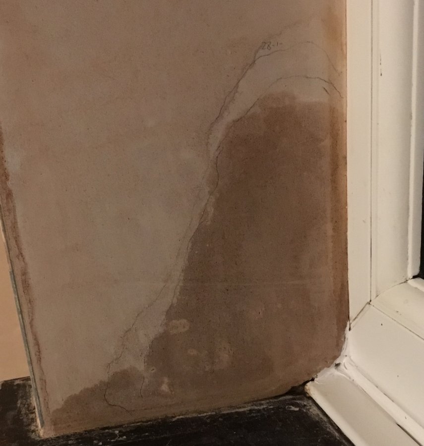

Water getting in around window. Fix?

No Idea what they will or wont do. you will have to ask them.
If you leave it who knows. I expect that the water was always getting in there and at least contributing to your damp problems. It was most likely blowing up between the window and the cill, Running to the ends of the cill and down into the cavity or inner blockwork before. Somewhere along the lines the new plaster or insulation must have got in the path of that water and is now just showing more than before.
You could chop the plaster back a bit and use pvc trim around the inside of the windows this may stop the wet plaster in the corners but it wont stop the water going wherever it was going before.

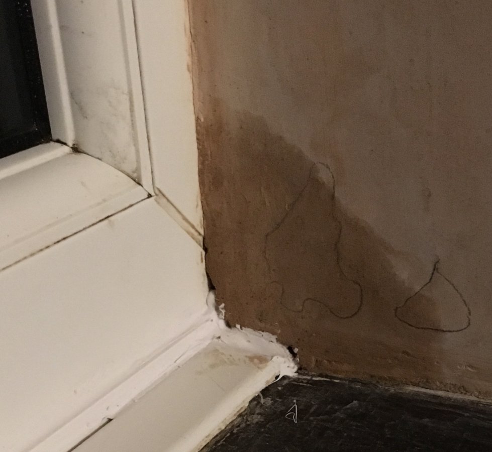

Although it doesn't explain the 'better' side of the main window or the small window, the bad side - that's where the old phone line came in. Although the BT guy filled the hole with silicone. I wondered if this could be causing how bad it is. But like i said - it doesn't explain the other side & other window.
I've sealed on the inside now - that little track & that hasn't helped it. I guess the only thing left before window out is to remove plaster & seal. If possible.

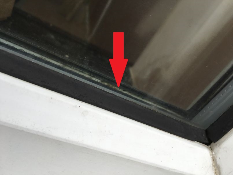

The guys who did the living room came out & put that white sealant in there. It can still drain out through the window opening holes ok.
Just where i have arrowed - that thin slit running the entire length, can water get in through that at any point along the entire length or not?

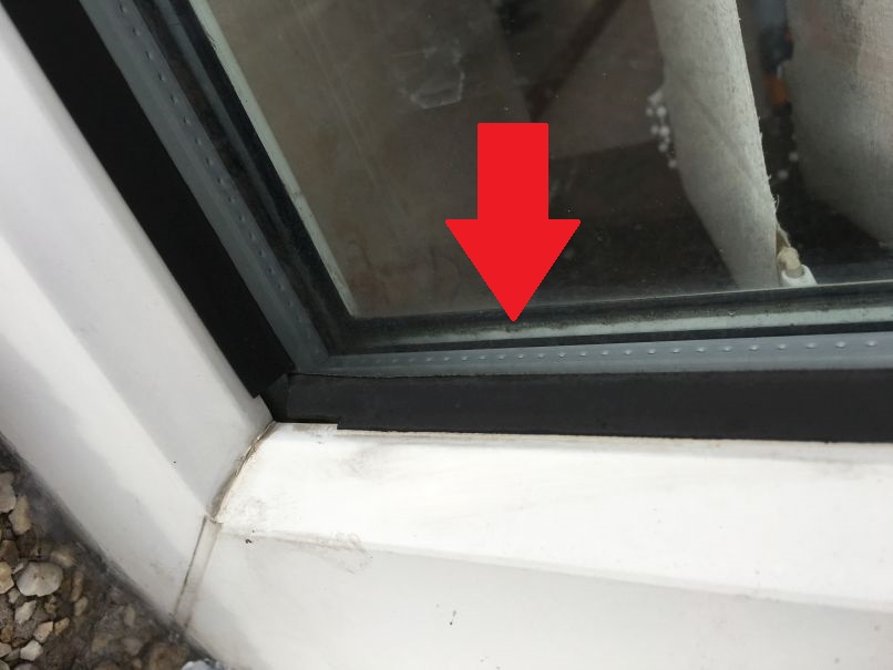

I noticed inside the glass in the edges there were bits of green/mould.
So it is impossible for the black rubber seal on the outside (where there's those gaps in the corners) - it is impossible for water to get in there & cause this problem??
The drainage is not the slit in your 1st pic. But funny enough your arrow is probably pointing pretty much right at it.
The drainage is through a few elongated holes in the bottom of the front edge of the window, If you bend a paper clip and slide it around where the arrow is pointing you will feel it.
Or you could open the sash and pour a cup of water in there to see where it comes out. They may already have blocked one with that white silicone!
The rubbers gaskets were known from the early days to not be 100% water tight this is why drainage systems are built in.
The slit (again 1st pic) is where water will be getting blown in and along to the ends of the cill and straight into your walls. You could try to seal it (with ou blocking the drainage holes) but a surface seal will never last long in there. It needs to be a bedded on seal aka window up or out cleaned sealed and refitted.

I don't blame them. I just want it fixing. Anyway after it belted it down last night it's looking likely that just leaving it is not an option since it's now stretching to the skim bead.
Personally would you even bother with them (the damp builder fellas) having a go at knocking the plaster off & sealing from inside?

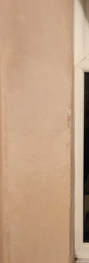

Anyway, what I woke to this morning...
Are you sure there were no trims inside on the sides before like the one on the bottom?
I thinks its bad enough that its worth you breaking out a 2" square of plaster in the worst corner back to the bricks and post us some pics of whats in there.

Usually old timber windows that come out are 90-100mm thick and replaced with PVC windows that are 60-70mm thick, This can leave a gap of 20-30 mm that is often covered by a trim.
I'm sure I have said this further back but if your house has brick closed cavity's with a vertical DPC it is possible that the new plaster has bridged the DPC (touching both the inside and outside walls) soaking up moisture.
Breaking out a bit of plaster should reveal this or possibly show any other problems. With how damp the plaster is you have nothing to lose now by breaking a bit off to see whats in behind there.
I would imagine then just cutting out a say 15mm vertical strip at the bottom but not going upwards too much would be fine (since the top isn't wet for example) & then cover this with trim if it worked?

I took a bit out last night of that corner. I was reluctant to take too much.
Anyway it's very sandy behind there. Once I cut away the plaster &rake the loose out its just like sand.
