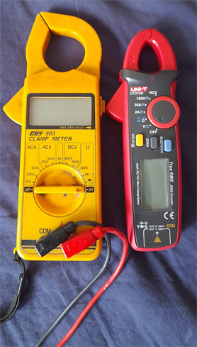

Could check the current is zero with clamp-on.
