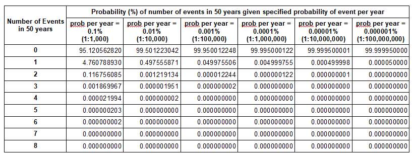

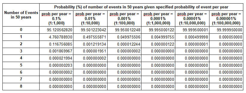

This rather illustrates a common problem with the practical interpretation (in relation to an individual person, building or whatever) of extremely small probabilities of discrete events. When such probabilities are larger, meaningful interpretation is much easier. . If, for example, the probability of something happening in any one year is, say, 0.10 (10%, 1:10), then one can say that the most likely number of occurrences of that event during a 50 year period (say, an 'adult lifetime') would be 5 - or if the probability were 1:25, then the most likely number of occurrences of the event in 50 years would be 2 etc. etc. One can base decisions on such information.
If the probability were 1:1,000, then by far the most likely number of occurrences of the event in 50 years would be zero. However, 'by far the most likely number of occurrences of the event in 50 years' would again be zero for any probability less than 1:1,000. Hence, 'by far the most likely number of events in 50 years' (which is what matters to an individual person/building/whatever) will be the zero whether the probability per year is 0.001 (1:1,000), 0.00001, 0.000000001 or whatever.
What matters in terms of the individual (person/building etc.) is the number (if any) of discrete events which they are likely to experience in a given time period (e.g. 'a lifetime') - an 'average number of expected events (for the person/building etc.) in 50 years' (which is easily calculated) is not really a very useful guide to anything.
For reference, the following indicates the probability of various numbers of events occurring in 50 years for a range of probabilities of the event occurring in a particular location in any one year. As you can see, even with a 1:1,000 probability per location per year (obviously very high for lightning strikes), there is still a 95% chance that one will suffer no strikes in 50 years - and when one moves to probabilities more realistic for lightning strikes, the probability of there being anything more than zero events in 50 years gets so small as to probably not be worth thinking/worrying about (regardless of whether or not any previous strikes have occurred)!
