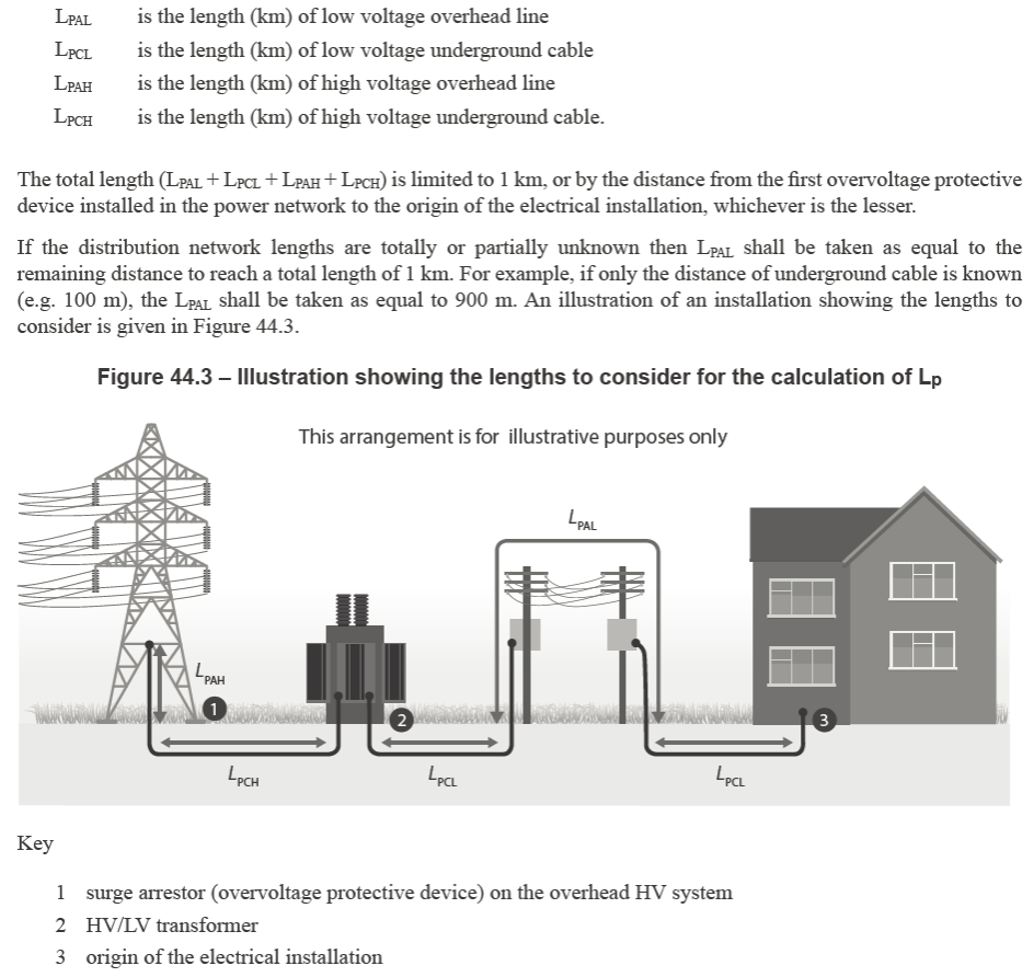

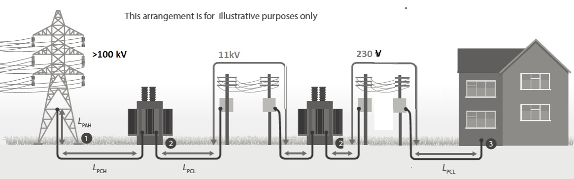

Does anybody know if the DNO can provide the distances which apply to any given property?
Re my house IHNI what LPAH or LPCH are. I do know that LPAL is 0, and I could have a stab at estimating LPCL.
But this guidance seems bonkers:
Of all the lengths in the formula, the only one I do know for sure is LPAL, and I know that it is zero - there are absolutely no overhead cables between the substation and the houses around here.
The whole business of calculating a CRL for "rural and suburban" environments seems utterly pointless. fenv is 85, so to get to ≥ 1000 needs LP x NG to be ≤ 0.085.
Best case NG is 0.1, so the longest that LP can be is 850m
Vast swathes of the country have NG between 0.3 and 1.0, meaning that LP can be no more than 283m down to 85m.
And what do rural, suburban and urban mean? Presumably there must be some kind of population density thresholds, but in my outer London borough I would (and I expect most people would) say that we were suburban. So with an NG of 0.8 I'd need my LP to be no more than 106m.
2LPAL + LPCL + 0.4LPAH + 0.2LPCH ≤ 0.106

I don't really get ....
At least in my part of the world (and I would imagine countless other 'rural' locations), I feel that LPAH alone is often going to be far more than 1 km. I've never bothered following the overhead 11 kV feed to my village to see where it originates, but it's certainly 'quite a long way away'
Kind Regards, John
