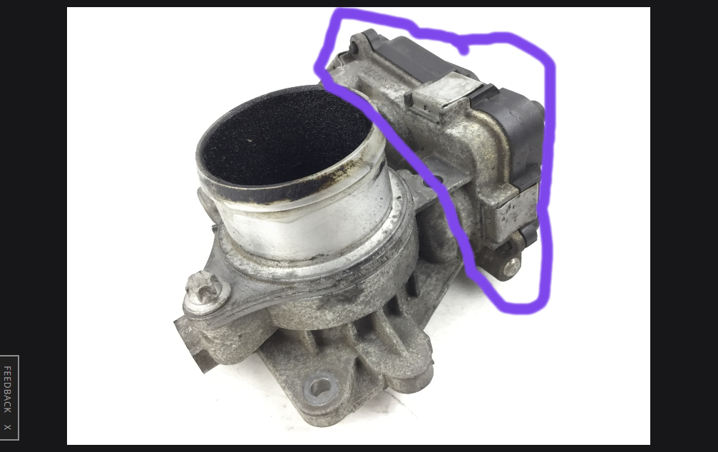

On the throttle body, I replaced it as the old one was leaking oil, ( the box on the throttle body itself ) but inside the throttle body where the flap is there was no oil, its leaking form the box bit where the metal clips are, and the replacement is doing the same, any idea why ?

There’s no oil in the throttle body. What you are getting is oil mist collecting and turning back into liquid oil. Very common on turbo diesel cars and more common on those that have done 200,000 miles!

The oil is thick and quite a lot of it, I think it is more than just a misting of oil. It feels the same as it would if you put your finger in a bottle of engine oil.
What is the solution then ? I know the car is high mileage but it is not normal for oil to be leaking out of it and covering everything below, the low oil pressure light came on and I had to top it up.
It is an oil leak and I needd to know why it is doing it and how to go about fixinig it before the oil get low enough that it destroys the engine and to stop the oil dripping onto other parts.
Just keep it topped up with oil. That’s about all you can do for a car of that age and worth.

There is no oil in the throttle body. It’s not a leak either. It’s coming from either piston blow by or worn turbocharger. Change those to be sure of curing the leak or spend a couple of quid a month on oil.
