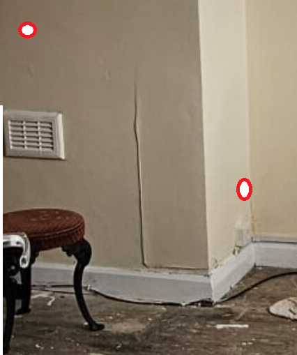

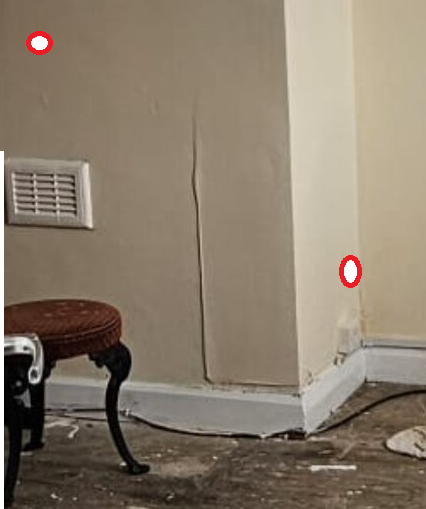

One thing though the 3socket - where does that surface mounted trunking come from/ go to because by the looks of it its single trunking indicating that the 3 socket is perhaps already a spur so you cannot run an extra socket off it but you can use a flexible extension cable.
That's a great idea about hhe extention.... might be an easier job..
Yeah it looks like the socket is spured to the side of the breast where there is a switched fuse box. It might have been for the TV for the previous occupants . I'm not sure

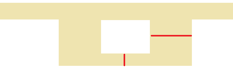

basically the chimney is a brick built box with a substantial void in the middle

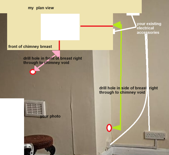

Thanks but I don't quite understand the diagrams you have just posted ?

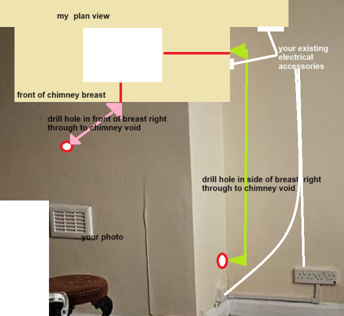

I see but what's the propose of this ? Sorry I'm novice . I am good at DIY . But no quite understanding the reason behind this ? Is this just ti check if there's a void within the chimney ? Or where the wires should go through ?
run the cables through the top hole into the void and out through the bottom hole.
It saves a lot of time, effort and mess (as long as it works)
Wouldn't it be a better idea to lower the hole on the side so it's closer to the switch fuse box. So I can just spur of that and put socket where you have said at the front ?
