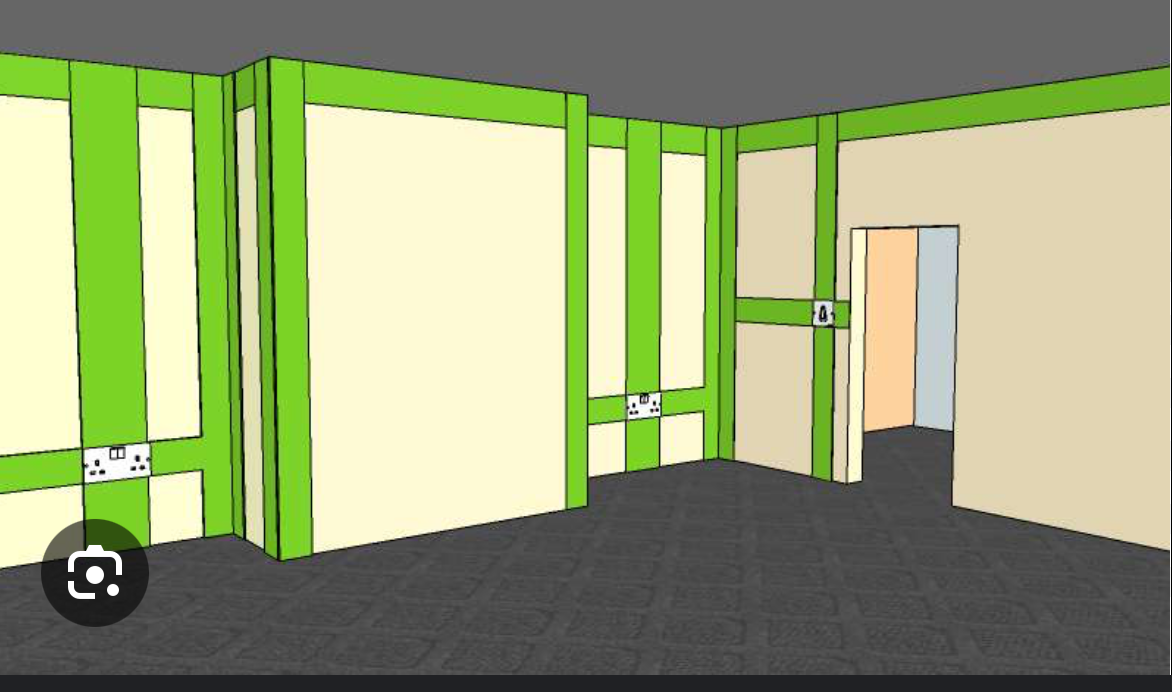

How deep do you think is important for a couple of cables. Twin and earth and maybe aerial and ethernet too.
If you're putting T&E in you'll need to create a safe zone by installing a visible accessory on the vertical / horizontal line of the cable run, btw. If the cable is to be buried less than 50mm deep you'd be wise to consider adding RCD based protection if it's not already there

But if I was going through the route of installing a socket. I thought I did have to use a twin and E ?? What other option was there?
Secondly what do you mean by visible accessory ?
I believe the sockets are already protected by RCD.
A socket would be a visible accessory and it's a rule that it creates a safe zone extending horizontally and vertically from it in which cables may reasonably be expected. This means you can look at the wall and say "there is a socket there, so that strip vertically above and below it, and or tha strip horizontally either side of it might reasonably have a cable buried in it. I won't just drill into it blindly"
The corners where two walls or wall and ceiling meet also create a safe zone
I am not an electrician.... I would recommend that you cut a wider, rather than deeper chase.
T&E in trunking, and then after you glue that in place, then run the other cables
