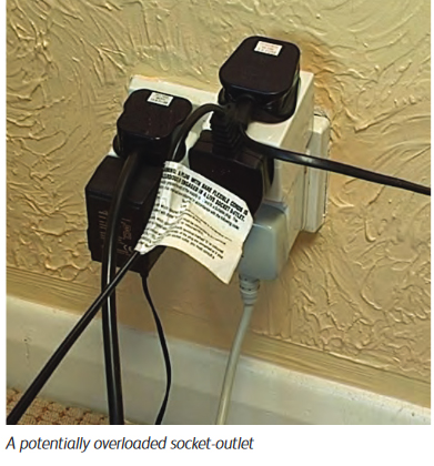

Inadequate number of socket-outlets. (Note: A Code C3 or, where appropriate C2, if extension leads run through doorways, walls or windows, or under carpets, or are otherwise being used in an unsafe manner).
This is not the best idea
However it can hardly be classed as dangerous either, it is on my to do list, but not very high, this
was the example shown on a previous issue, clearly not good, but what has that got to do with the installation? In both cases all you need to do is unplug. And as long as the double adaptors have got fuses in, how can you get an overload?

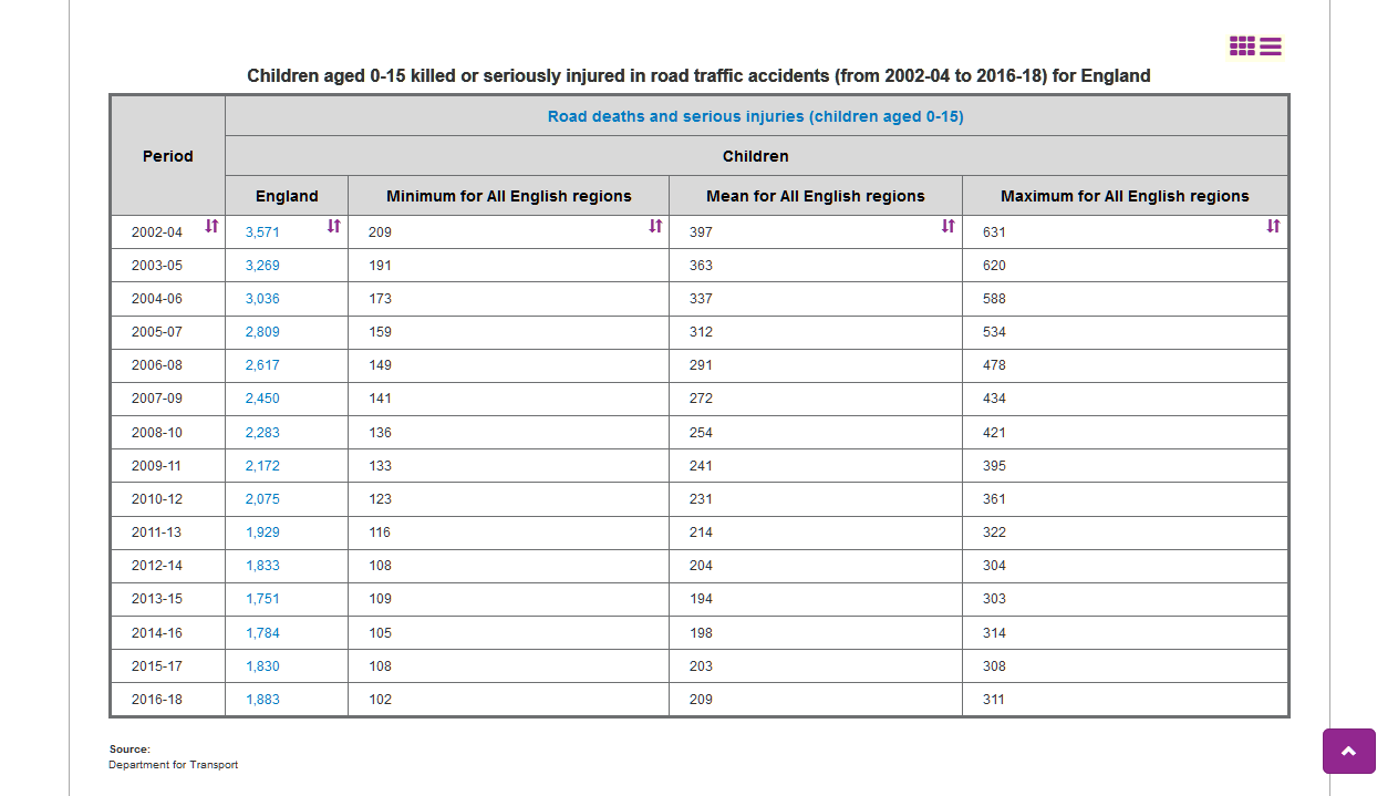

what do you think of this? ... Bloody nanny state, eh?
I'm not really sure of your point. As I wrote:
In many cases, the changes in attitudes to acceptable (and 'not acceptable) risks have been sensible and welcome, but the 'Nanny State' has (at least in my opinion!) got a bit carried away with itself in many situations!

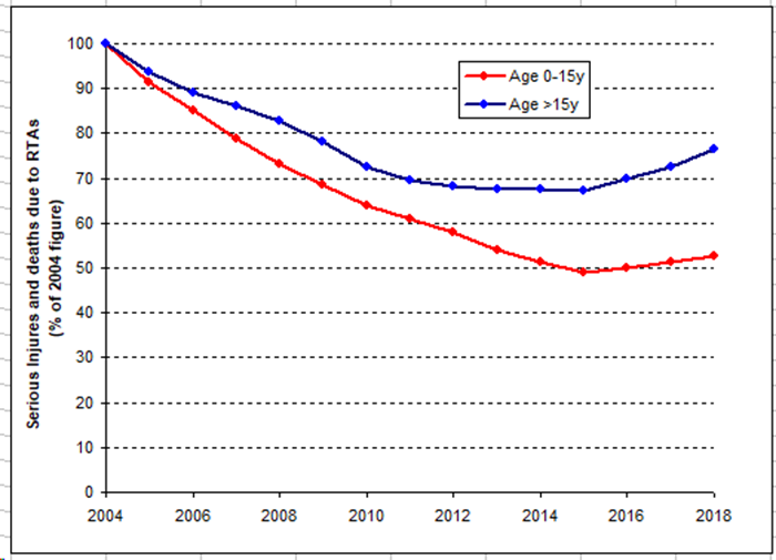

There are some interesting aspects of this data (see graph below based on the data you linked to). Firstly, although I would expect similar if one looked back a decade or three earlier, I'm rather surprised to see so much change starting only 16 years ago - I wonder what has led to this? Secondly, I wonder why the rate of road serious injuries/deaths have been increasing since 2015, in both children and adults?
Kind Regards, John
Edit: ee next post for the missing graph!
