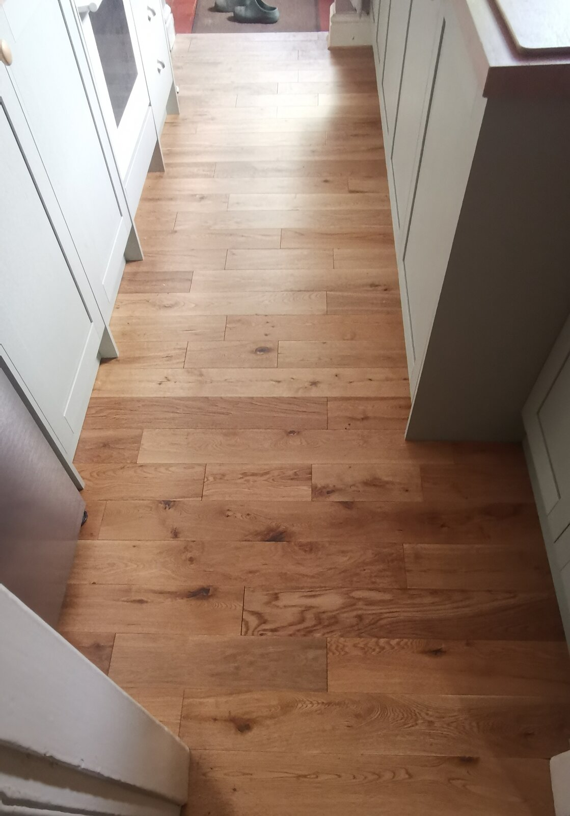

Wooden floor warping
If you have floated a solid wood floor, that’s part of your problem, the fact you still have old vinyl down underneath sets off even more alarm bells regarding poor prep and the floor not being fitted to spec.

A self employed builder/property repair. I don't want to go too much into the person as he in the main did a good job with other work he did for us but, as much as I appreciate the advise and knowledge, I think posting here is going to be under intense scrutiny whatever way it was done. I honestly don't think the lino is the issue here. Again, it is another layer of insulation from a very cold concrete floor and it is sitting on proper underlay. The lvt floor in the bathroom he laid is great.
Does the floor go all the way to the wall under the cupboards. As it could be touching the end wall under the cupboards.
The intense scrutiny is because we think its has not been fitted correctly leading to "cupping" as it expands. It looks like it has but does this floor have a coating - did the chap do it or was it like that out the box (factory lacquered )

Another thing about the picture here is that he has put down a lot of the short planks right in the main walkway, It could just be my OCD but I dont think this is best practice either as that leads o lots of joins in the heavy traffic area. 1/4 way up from the bottom of the picture I can see 3 short pieces all in a row.

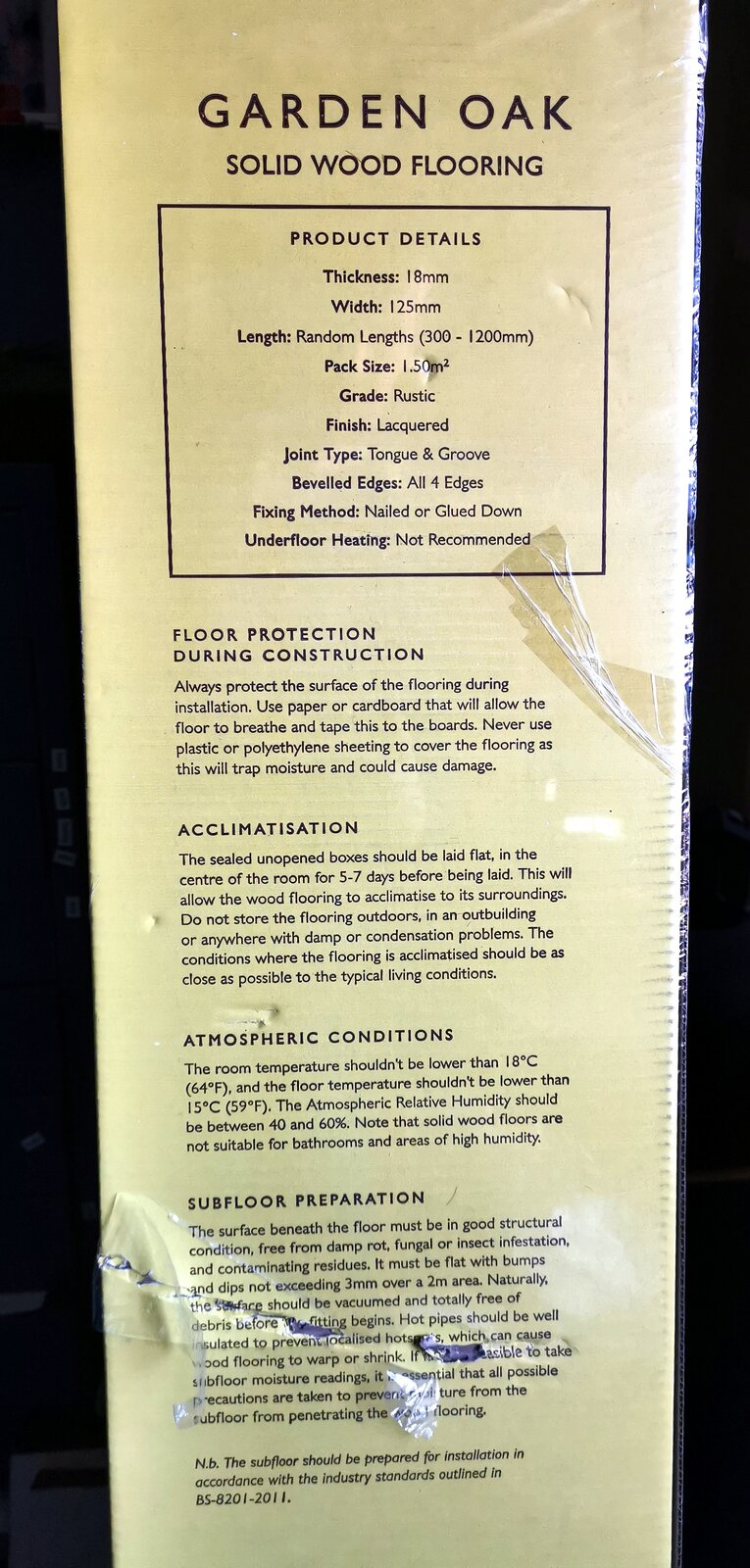

Woodpecker do not state that ANY of their solid wood floors can be installed as a floating floor, all must be bonded or secured nailed to a correctly prepared subfloor with appropriate expansion gaps allowed.
If you clink the link above ^ and scroll to installation instructions, the link takes you to Woodpeckers generic solid wood floor installation guide, a quick skim read should confirm to you that the builder has completely messed up the floor preparation and installation. This is REALLY common, like I say, I come across this kind of thing almost daily, laying a solid wood floor is an Art, you don’t get any of the ‘leeway’ that an engineered floor floated correctly MAY give you. Solid floors are a different matter entirely (not that Enginnered doesn’t still need particular specifications to be followed for best results).

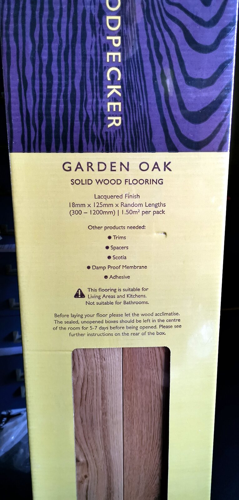

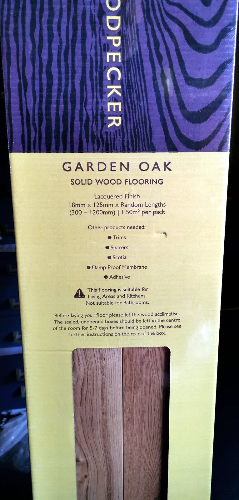

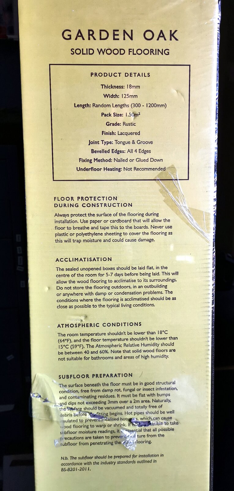

Here are the details as we still have a full box and a half left. Again, he over ordered, not myself.
I appreciate your opinions but this pile on isn't helping. I am already pretty depressed about it and just want to make the best of it having already spent good money. I am not a floor specialist so wasn't to know. I can only trust someone who does a lot of work for clients (some big expensive jobs in large houses)
having said all that I appreciate the help nevertheless.
Its not a pile on we are trying to help you - myself from a DIY perspective and @crazydaze from a pro expert. We have been making guesses as to what is wrong and trying to sort it we keep telling you what we think is wrong and you just keep brushing it off and defending your fitter.
Its disappointing that the chap who fitted it has done it wrong, as you say he has done good work in the past for other stuff and you are not a floor expert and so you relied on him.
So original vynal flooring was left in place, then an underlay was put down on top of that, then not enough or zero expansion gap was left. And the floor was fitted as a floating floor when it should of been fixed to the base floor.
A floating floor is where the planks are glued together and a perimeter gap is left all around the room the whole floor acts as one. Although this floor was put down wrongly as a floating floor when it should of bee glued down - was it at lest glued together via the tongue and grove.
And how did he manage to over order by over 2 square meters on what looks like a small kitchen at about 8m2 (forgive me if I am wrong on the size.)
As your full kitchen has been fitted I would say the only thing to do to try and sort it out is take off the skirting and undercut the door lining / frame.
At the door lining cover the gap with bead. and at the skirting take off the bottom 1 inch of plaster to give more gap then remove the last plank and replace with one that is wider so that when the skirt is put back on the floor it is well under the skirt. But it may be a waste of time if its touching the wall under the units
