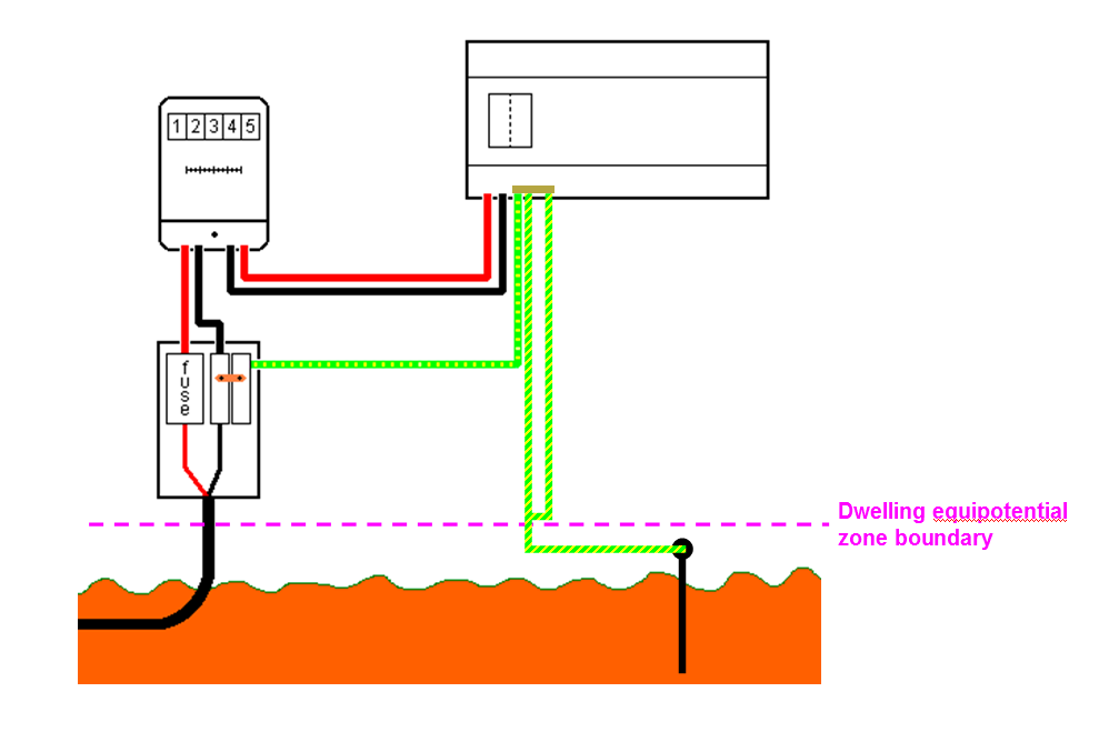

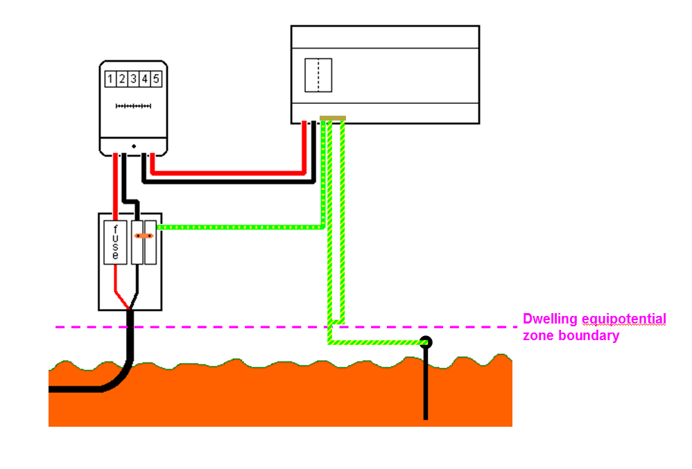

One opton would be a ground rod ( at ground level ) and a substantial conductorm a raising earth, ran up to the top of the building. Each flat then connects it's MET to the rising earth.
Provided the rising earth does not penetrate the equipotential zone of a flat then that is OK. If however the rising earth does penetrate the equipotential zone of a flat then is has to be considered as an extraneous conductor and would therefore need to be bonded to the MET.
What difference do you perceive between "connecting" each flat's MET to the 'rising earth' (which would obviously be required) and "bonding" the 'rising earth' to each flat's MET (which you seem to be implying is something different)?
Kind Regards, John
One is an "Earth" and the other is a "bond". As is so often stated bonding and earthing are not the same thing so therefore one cable cannot be both.

since you are claiming that what is the (flat's) incoming earth is also an extraneous-c-p which needs to be bonded!
The flat's incoming "Earth" comes to the flat on the Neutral of the supply cable. That is not extraneous.
The "Earth" from the ground rod is an extraneous..... ? Yes exactly what is it classed as ?. It is the same as a metallic water supply pipe and as such has to be bonded to the "Earth" that comes to the flat on the Neutral
It seems to be that the connection to the ground rod is intended to act as an additional Earth to add to the Protective Multiple Earths of the PME distribution system ( which sometimes does not have "Multiple Earths" connected to it's Neutral )
When people used water pipes for earthing did they also apply main equipotential bonding to them?
Only in that it is part of the electrical installation, thus removing it from the definition.
Yes, until it becomes The Earth by loss of Neutral.
Until then, what current will it carry? 1/500th to 1/250th of the Neutral current?
Officially it is as you say below.
It is the same as a metallic water supply pipe and as such has to be bonded to the "Earth" that comes to the flat on the Neutral.
It could be removed until needed but as it is, yes, it will have to be bonded by what will be described as an Earthing Conductor.
It is referred to as additional Earth but it is only just that.
Surely its real purpose is to provide THE Earth when the Neutral fails.
I fail to see how it can be PME if there are not Multiple Earths (albeit only two).
I must have saved the draft, but can't find it.
Does the Draft say this new requirement is for TN-C-S or just PME - and if it does, does anyone think that is what they mean?
That is if it says PME does it mean TN-C-S as well? If it says TN-C-S does it really mean that or just PME?
So this is required?
Common sense says that the ESQCR should be amended to require the earth rod to be connected to the supply neutral on the network side.
