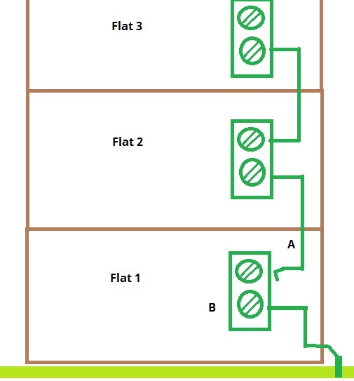

If there is structural metal passing through a flat in a block of flats, do you really believe that it must be bonded everywhere it 'enters' or 'leaves.
Structural steel seldom becomes un-jointed. A rising ground looped from MET to MET could become un-jointed
The conductor coming through the ceiling of Flat 1 at A is no longer a rising ground but is in fact a descending Neutral
Do you perhaps have shares in a supplier of G/Y cable?
No but I do have an open mind that operates a policy of "what if"
