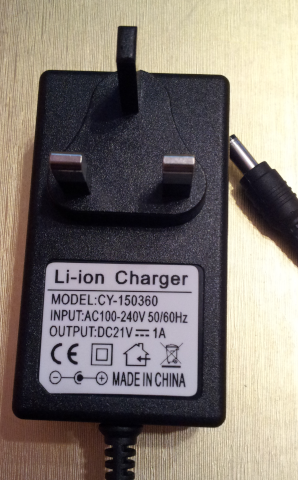

I think there are two types of AC/DC adaptors: battery charger type that can tolerate the output voltage being dragged down by the load; power supply type that cannot tolerate the output voltage being dragged down by the load. The failed adaptor is the latter. My working 18v adaptor is the former. To buy the right one, I need to search for battery charger. I can see some 21v 2A li-ion chargers on ebay. Those will work but too high an AMP rating for what I need.
The replacement 431 transistor arrived. The only difference between the new and old part is that pin 1 and 2 has a resistance of 6 M-Ohm instead of 50 M-Ohm. The internet diagnostics procedure for the transistor appears to the wrong. Since there is a difference, I am assuming the old part is blown. But, putting in the new part did not revive the adaptor. Measuring the output of the transformer in the adaptor produced 0V. The damage to the adaptor is worst than thought, could be the transformer or the main chip. So, the adaptor a write off.
The happy news is that a new adaptor arriving at the same time is working. I am hopeful this will be able to bring my battery to the magical 16.2V. The adaptor is better than wanted, and able to keep the charge current constant at 1A regardless of the dragged-down voltage by the battery. At the time of purchase, I was rather hoping the adaptor being a little crappy and output less amps when the voltage was dragged down. I would be happy for a 100-200mA output. I have used this for half a day and it hasn't blown or got hot, only slightly warm. The battery state is satisfactory. It's coming back from the dead after being left drained in the winter months. It was at 4v and 560 m-Ohm of internal resistance. A good battery is 4 to 7 m-Ohm. My battery tool declared it 0% health.
I kept the new charger going over night and the garage hasn't burnt down. I definitely need a fire alarm for the garage. Using the feel-by-hand gauge, the charger is warmer than wanted, but not hot.
