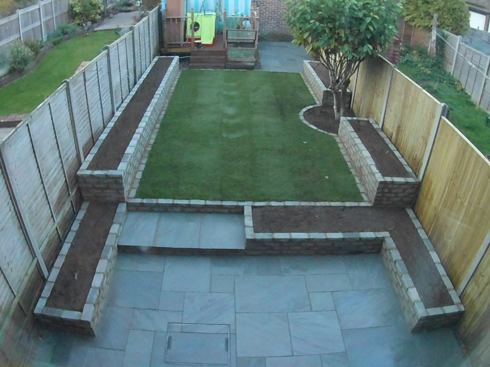

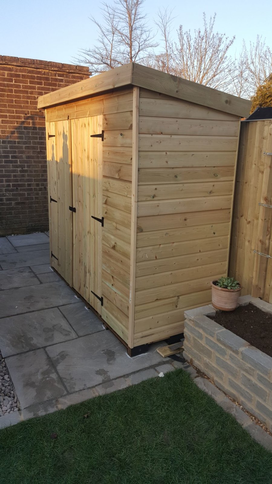

Attached is an image of the garden. At the top right is where the shed now is (see other attachment)

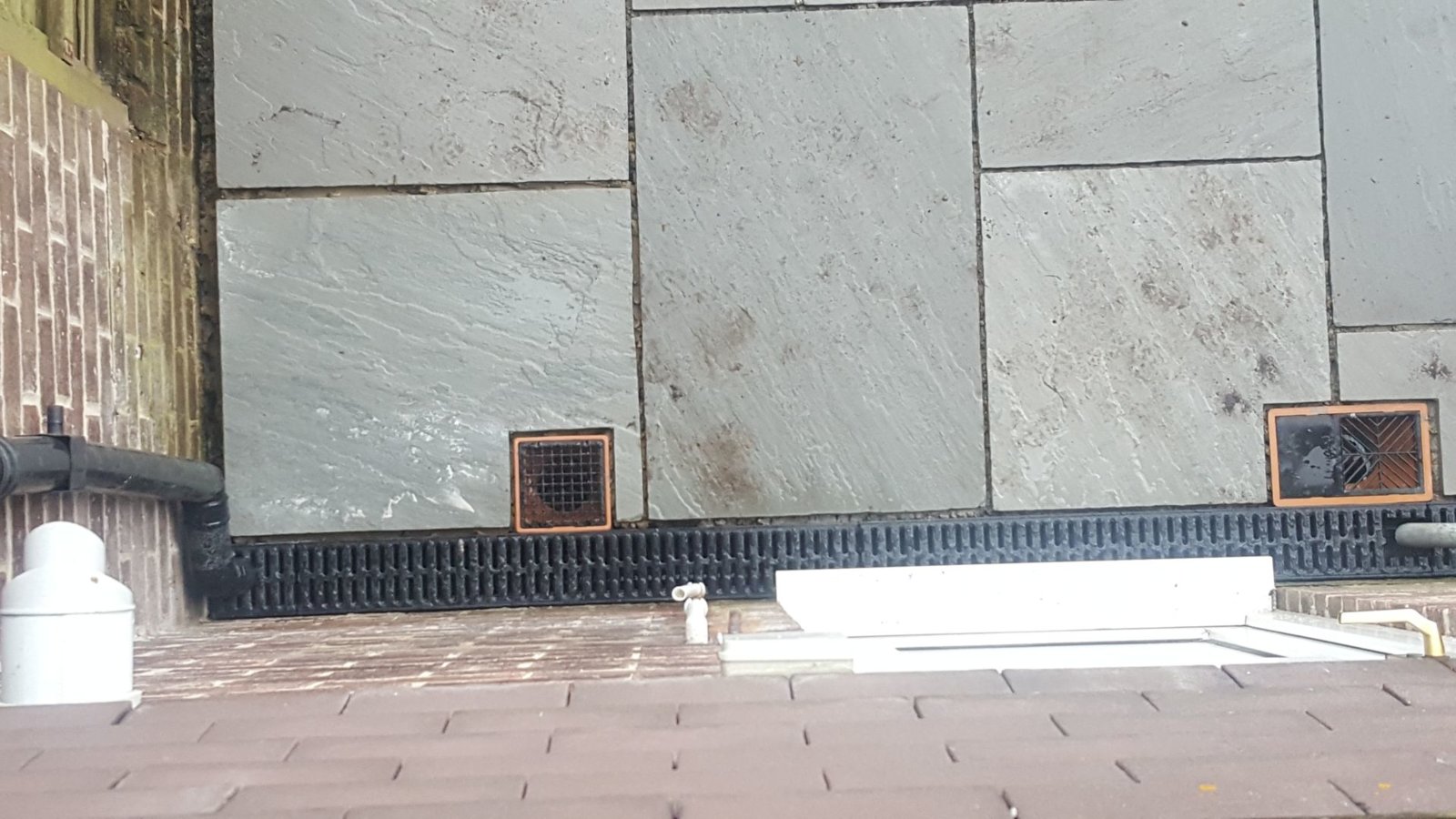

The run will go from left to right against the house - there is a gully along the length of the house (see other attachment) so either put it in there or just above it wall mounted. Then bury it in the pebbles (you can just see them at the bottom right) up to the first bed. It will then go behind the bed, but I would need to make a hole here where the concrete posts are, as the builders have put the wall/mortar up against it. It would then lay on the ground behind the magnolia and again lay behind the second bed up to the shed where it would terminate.
Shame that you didn't think about this before you had the turf laid.....
I seem to recall there was a minimum bend radius for SWA which (I assume) would be less of an issue with a flexible cable such as rubber or artic cable? The bends may be an issue at some points for the SWA.
And robustness may be an issue for non-armoured cable.
