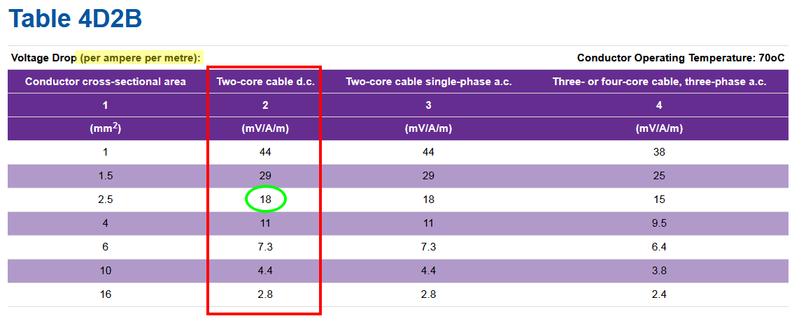

In any given length of cable, voltage drop is proportional to current.
So the total drop of any cable depends on its length, and how much current is flowing - the longer the cable, the greater the drop. The higher the current, the greater the drop.
It follows that one characteristic of a cable is its voltage drop for a particular current over a particular length and at the sorts of currents and lengths found in low and extra-low voltage final circuits, millivolts (of drop) per amp per metre are the most sensible unit.
So that table shows that, to use your scenario, 2.5mm² cable will have a drop of 18mV for every amp of current for every metre of length.
If you've got a 10A load, over your 20m the voltage drop will be
(18 x 10 x 20)mV = 3.6V
I've never done the comparisin before as I generally find it easier to use the resistance and calculate from there. I have always found this to be pretty accurate.
OSG Table 9A (16th ed) which again I've found to be reliable, shows 2.5mm² as 14.82mΩ/m. 14.82x10x20 = 2964mV drop
But 4D2B (16th ed) clearly shows 18mV/A/m which comes out as 3.6V as shown by BAS or a discrepancy of 21%
